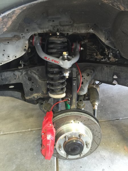

  2. Jul 13, 2016 at 8:02 PM
    #42
    Blackdawg

    Dec 31, 2010
    #48500
    81,599
    Monte
    Wyoming/St. Louis
