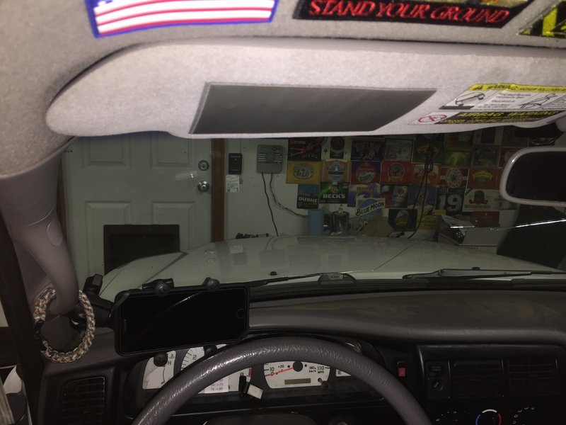

    'A' Pillar RAM Mount
    Oh, and I also got my Ram Mount set up on my A pillar. Pretty nice! Waaaaaay better than the suction cup mount that I had previously.

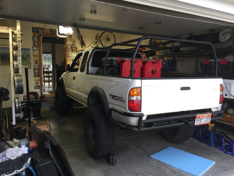

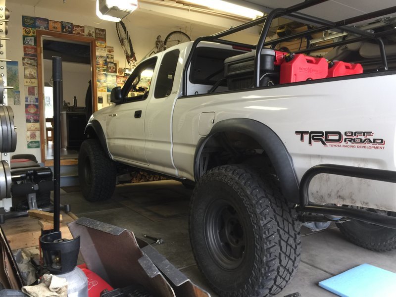

    BODY LIFT!!! - Part III
    Well, the 1" body lift is done! This morning I double checked all of the torques on the mounts and the steering rag joint extension.
    Then I took it for a test drive. I noticed virtually no change in handling at all, and in fact, the ride felt a bit smoother overall. We'll see how it is with the tent back on the rack, but for now, I'm very pleased.
    Despite the bad rap that body lifts get, often for good reason, I'm confident that a modest BL like this one will have benefits that outweigh any disadvantages. Time will tell, I suppose.
    New stance.
    Still need to raise the rear bumper.
    Need to get my damn front bumper on now.
