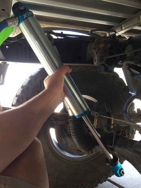

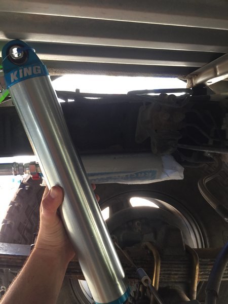

    Looking ahead a bit...

    Yep. 28.375" extended length center to center.
    Brett was smart and got the welded rod ends, so that will definitely help him.

    I can swap shafts for you if you want the welded ends to reduce the length. King also sells a -3/8 rod end so you only have to swap the rod end.
    jubei[QUOTED][OP] likes this.

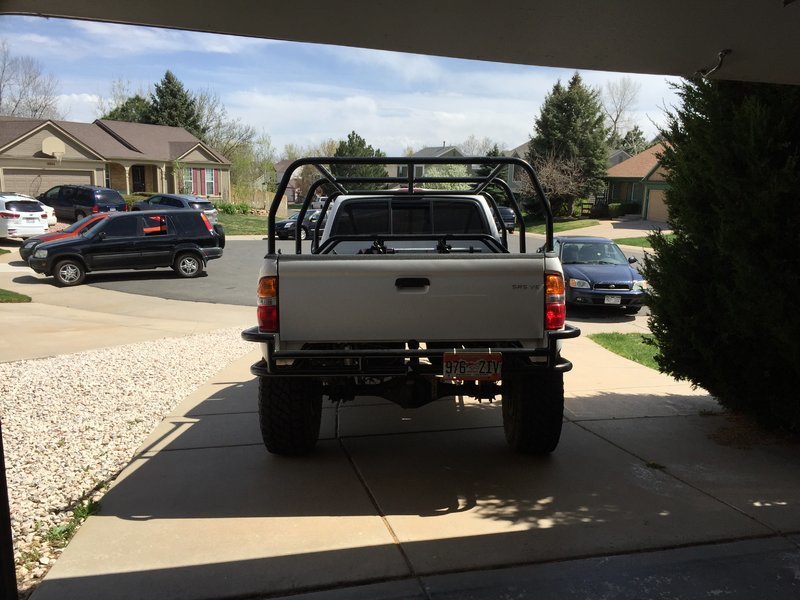

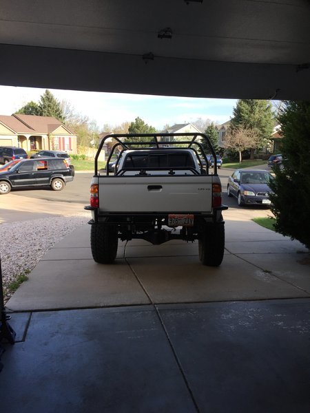

    BODY LIFT!!! - The Final Chapter
    Pulled the rear bumper off and drilled new mounting holes to move it up as far as possible.
    I could only go up about 3/4" from where it was before, so the bumper is about 1/4" down from the body compared to where it would be without the BL. Whatever.
    Before.
    After. No more saggy ass.

    Nothing like cutting a hole in a perfect bed.
