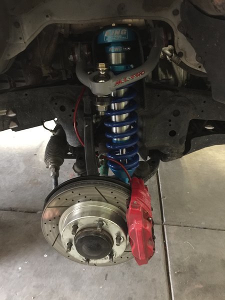

    Passenger side done!

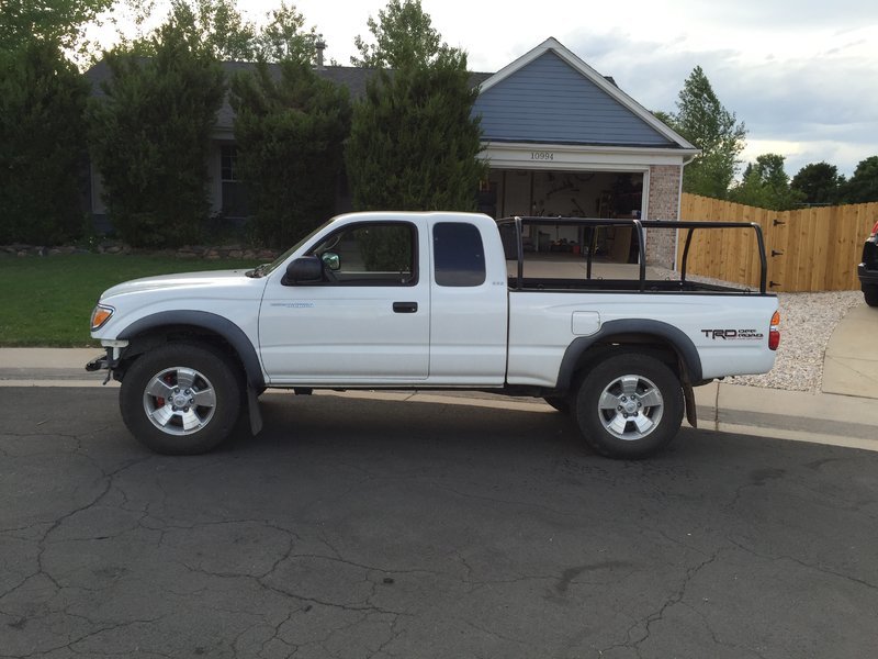

    Before and after ride height measurements, from center of hub to bottom of flare:
    Front Driver: 21.25 -> 24.0 (+2.75"!)
    Front Passenger: 20.5 -> 24.0 (+3.5"!)
    I think my stock struts were pretty tired...

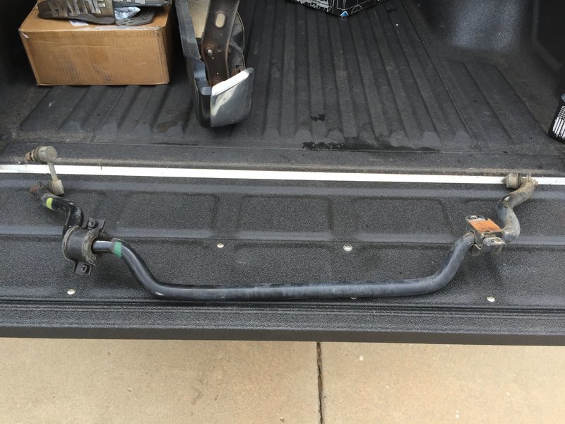

    Bye bye, sway bar!

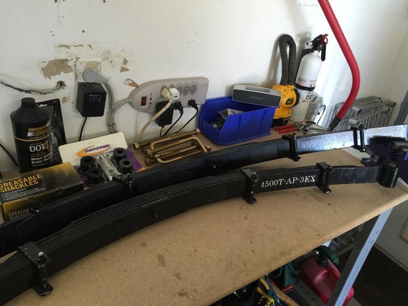

    Oh, and more creamy goodness arrived today as well...

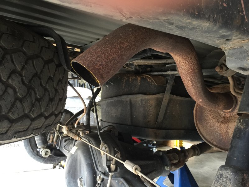

    Cut back my exhaust:

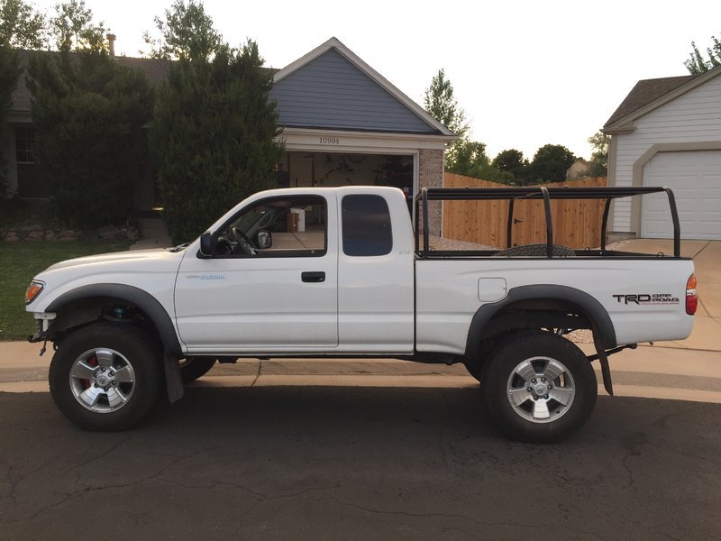

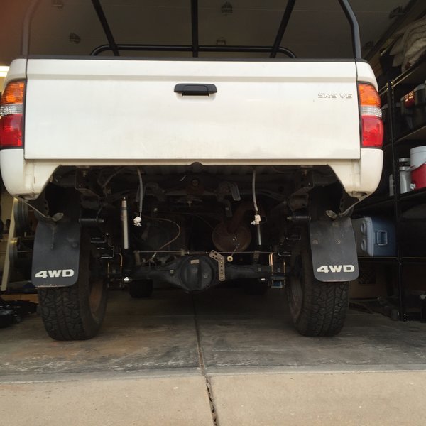

    The interim rear suspension is done! Tubbing commences once I get my spacers in. I'll update the lift numbers later.
    Before:
    After:
    Crom and Robmonster117 like this.

    What rear leaf pack did you go with?
  12. Jul 25, 2016 at 7:24 AM
    #72
    jubei
    jubei [OP] would rather be doing something else
    Mar 17, 2016
    #181549
    6,062
    Jason
    NoCo
    White 2002 XC TRD and Yellow 1971 JEEP CJ5
    Stuff. Also things.
    All-Pro Expo. I've heard nothing but good things, and since I'll be rolling with at least a bed rack, RTT, and a full size spare, it made sense. When I sat on the tailgate, it dropped maybe an inch, if that, and I'm 225.

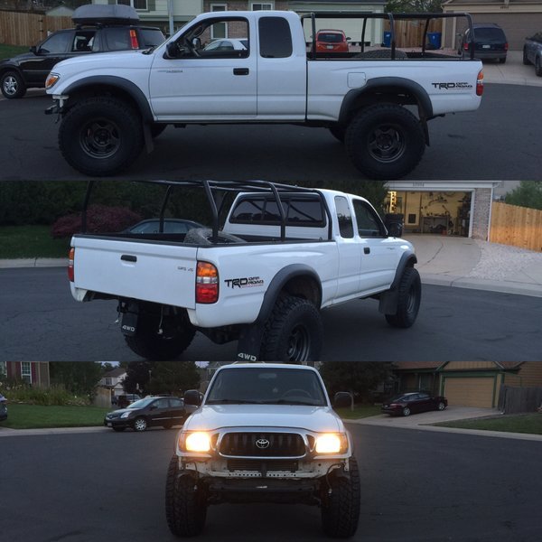

    Final ride height numbers with Expos and the King 2.5 coilovers set to 1-1/8" of threads showing:
    - Front Driver:
    24.0 (+2.75")
    - Front Passenger:
    24.0 (+3.5")
    - Rear Driver:
    25.50 (+3.5")
    - Rear Passenger:
    25.50 (+3.75")
    I'll get compression and droop numbers after the tubbing.
