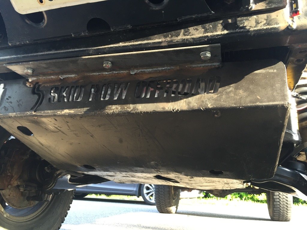

    That's exactly what I was looking for. My RAT skid is a little different that's your Skid Row, but here's what I'm thinking:
    • A flat piece of plate plasma cut to shape with three mounting holes in it for the crossmember interface.
    • Use the old holes in the mounting lip for rosette welds like you did and run a bead along the lip as well.
    • Since I wasn't thinking ahead with the crossmember, I'll drill three holes in the crossmember and carefully tack weld bolts through the holes so that I can just mount the skid over those and run down some nuts.
    Seems like that might not be too much of a pain in the ass. I just need to measure and draw something up to get it plasma/laser cut.
    And this will probably be what makes me finally buy a welder.
    ETA: I might grab some scrap metal and add some stiffeners to the skids as well once I have a MIG.
