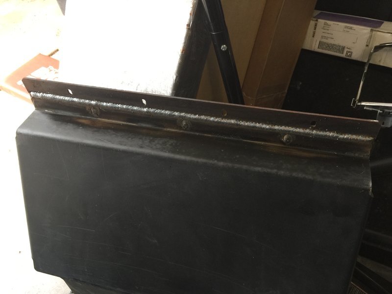

    Oh, and Tim kicked ass and did me a huge solid today.
    I now have a skid that will mount to my truck again!

    Stole all of Tim's dimes I see.
    TMFF and jubei[QUOTED][OP] like this.

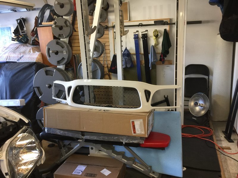

    I'll be interested if you can mount the come up without cutting the grill. I was always leaning towards the smittybuilt x2o 10k cause of its compact size.
    jubei[OP] likes this.
