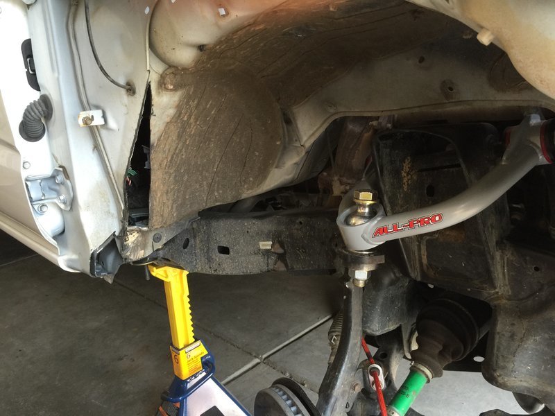

    Firewall Tubbing for 35s
    Progress!
    And still more to go:

    Hey, @Robmonster117 and @cynicalrider!
    Were you guys able to keep the front kick panel clip when you tubbed, or did you have to cut past it? I'm to the point now where I'm almost against the bump, but I'd need to go beyond that clip to get there. Thanks in advance!

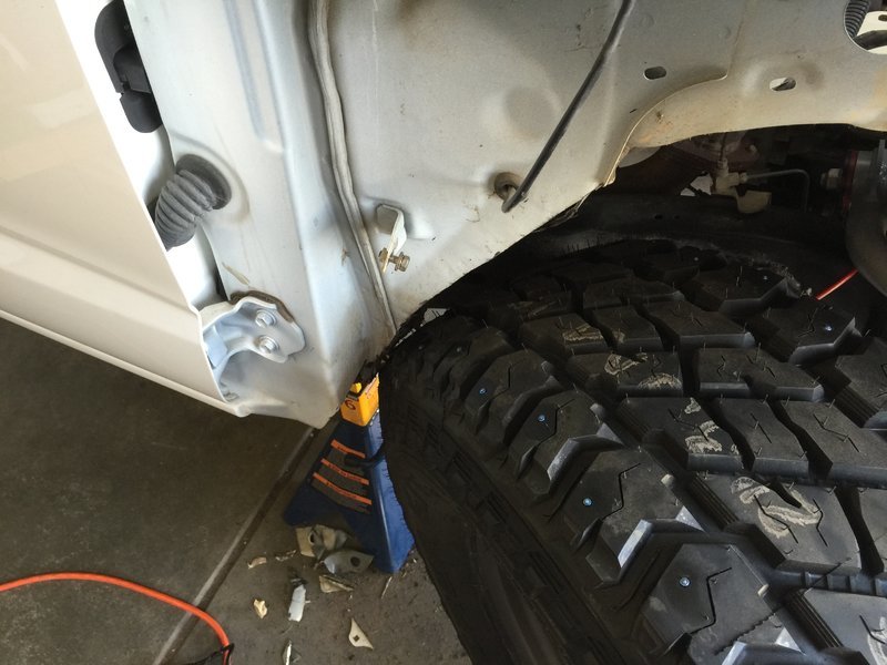

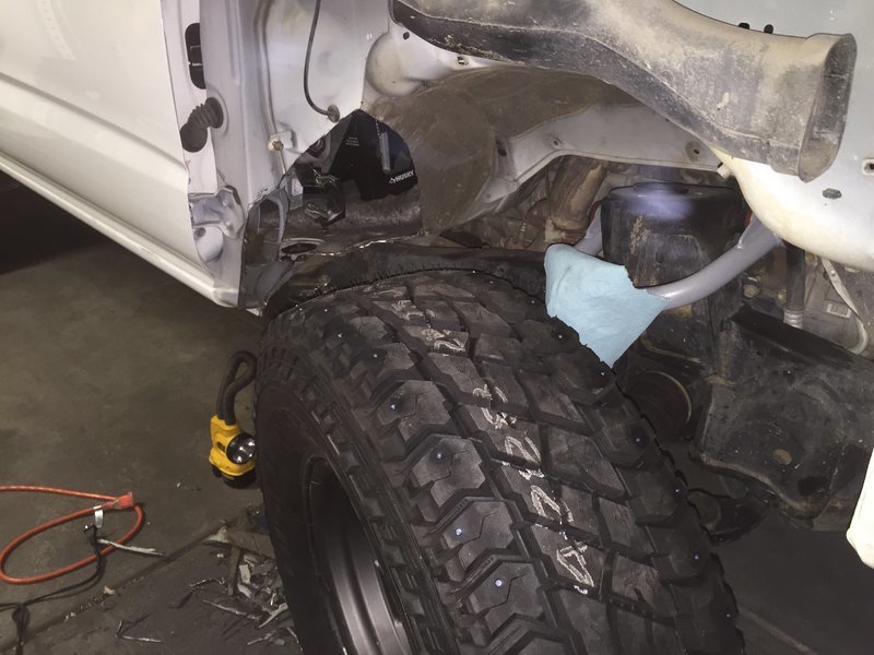

    Almost done with the passenger side!

    Mine got cut out, and I had to trim the kick panel to fit the new floor.

    Thanks, Tim. I just decided to cut past it figuring that the kick panel would have to be reworked anyway at that point. Did you rig anything up to give the panel another attachment point up front?
    How far did you end up going again? I'm probably gonna take out the entire concave section, and I thought you had said that you did about the same.
    Another thing to note with the 315s, 3.5BS wheel, etc.: The tire does indeed rub the frame at full lock, just like @Blackdawg said it would (go figure :rolleyes:).
    My 1" BORA spacers should arrive by mid-week, so we'll see if that helps, since it will put me at 2.5" total backspace. I foresee some possible rubbing issues toward the front of the front fenders on the opposite side at that point, but that can be dealt with.
