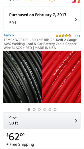

    I have left over cable from when I relocated my battery to the bed, you can have it. It's at least I can do for your help. I'm also working tomorrow so I can bring it then and you can pick it up from me. Any auto parts store would have the connectors.
    This is what I have.

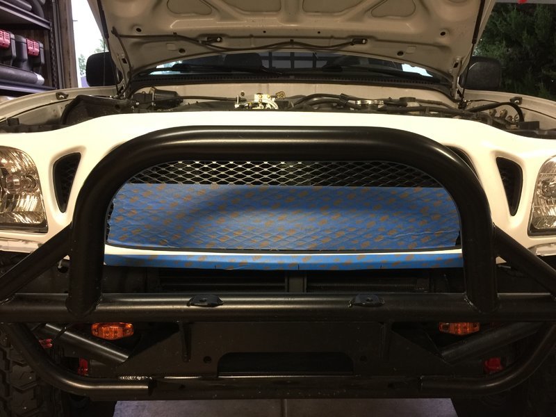

    Yeah, I'm gonna have a shitload of cabling to do, and I might as well get the tools and material to do it myself. I was looking at the contractor box, and it looks pretty straightforward to run new cables into it.
    That's a nice offer, Ray! How late are you working today?
    I'm nervous as hell, man :eek:

    Yep.
    Top of the winch plate to the bottom of the grille is only about 6". The height of the bars across the drum is about 7-1/2, IIRC. And the engagement handle sticks up further, especially when it's being moved. The entire lower painted section of the grille is gonna go bye bye, most likely.
    I thought this might be an artifact of the 1" BL :bananadead:, but the bumper moved up with the body, so not likely.

    Wait, wait, wait.
    The engage/disengage handle is on the motor side. You should be able to take the motor bolts loose pop the motor out slightly and rotate the handle toward you to the next bolt hole. Should set the handle at a 45° angle toward you instead of up at the top.
    That might save a little grill cutting.

    Nice catch!
    On the 9.5rs, the clocking increment is 90deg. I'm definitely gonna try to clock the handle forward, in which case I'll likely have to cut and grind away a bit of the face that the fairlead mounts to. The handle center is also forward of the grille when it's clocked vertical, but not quite enough to miss it when disengaged.
    YOU HAVE NO IDEA.
    :D
    But seriously, winch > grille. And I'm delusional enough to think I can make it look pretty decent.

    Ok Jason I have a pos and neg wire. Both 9'8" hopefully those are long enough. I start at 5am and should be there most of the day. Just shot me a text if you head over.
