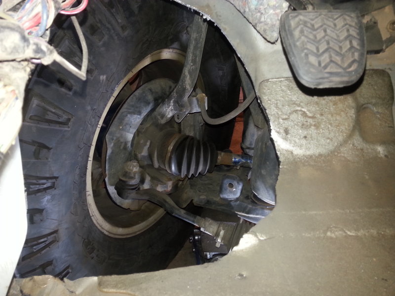

    This was the only kne I could find of the final cut drivers side. Ill be in and out of service today so if I don't respond quickly thats why. But ill try and check in as service comes

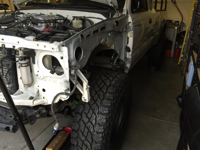

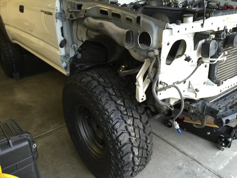

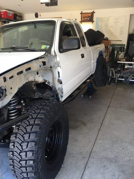

    Firewall Tubbing for 35s
    Well, I think I'm past the cutting. Not the prettiest job, and it'll present some challenges when it comes to welding in the sheet metal, but it's fucking done, and that's a very good thing.
    This week I have to get the grinding and welding prep done, along with cutting out the sheet metal, so that I can get the welding done Saturday, and seam seal and bed line on Sunday. Twelve hour days or not, it has to happen.
    Not the greatest pictures, but there are a couple big fooking holes!

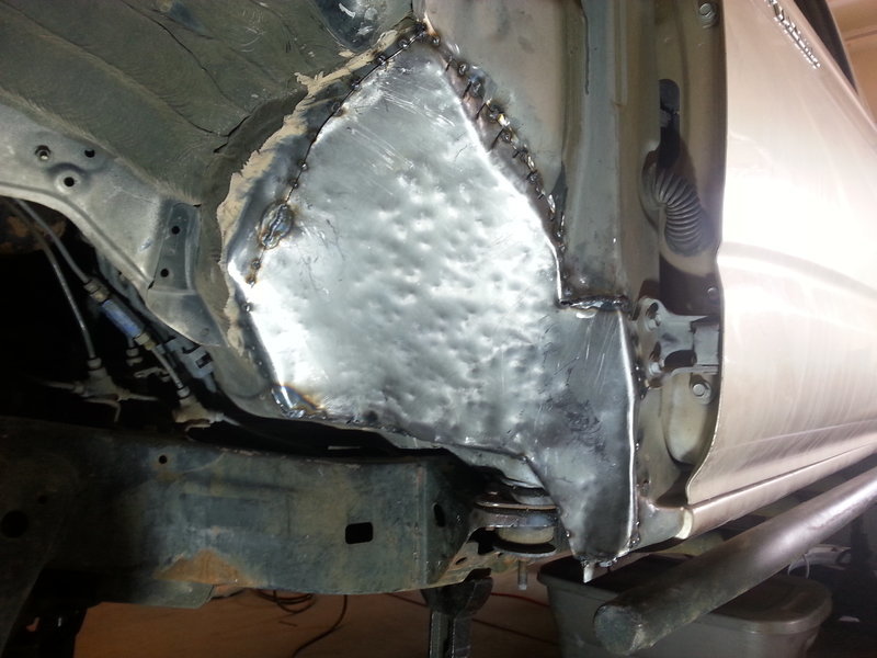

    this is what my drive side looked like from the inside.
    Easy CV inspection.
    outside before paint. The golf ball dents helps the MPG's

    That looks almost exactly like what I ended up with. The bumps were such a huge help. I'd much rather have too much room than not enough.
    One thing that I need to check though is my clutch pedal range. Hopefully I'm not going to find out that I lost the bottom end when it's disengaged.
    Laminar flow, bro. If it's good enough for golf balls, it's good enough for Tacos.

    The shape of the clutch pedal followed the cut out on mine so I didn't loose any range of movement.

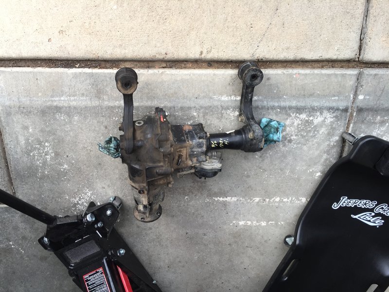

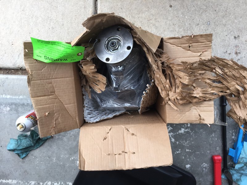

    Regear - New 3rd Member and Clamshell w/ARB
    Well, I made some progress, but not as much as I had hoped. Still, I'll take it!
    Got the front IFS diff out, but got stymied by the ADD tube. After some reassurance from Monte and Brett, it's likely that the only thing holding it on the diff is the gasket material. Time to hulk out on it and pull the stub shaft for transfer to the new 5.29 ARB hotness!
    Old and (not really) busted:
    New hotness, still in the box from ECGS:
