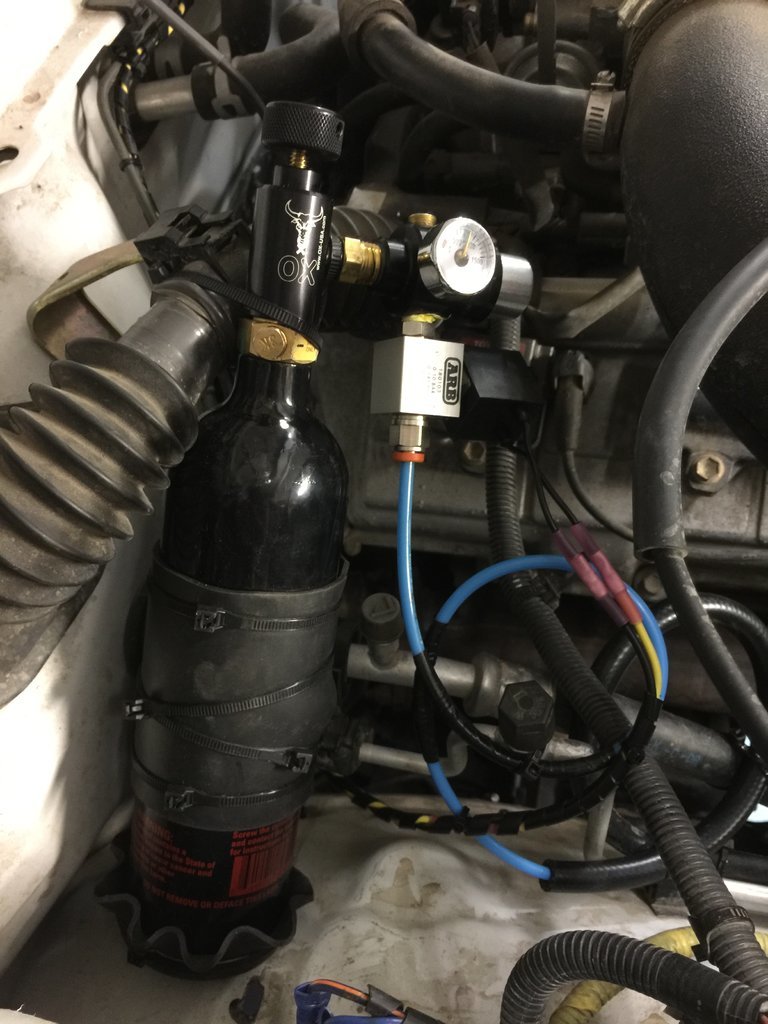

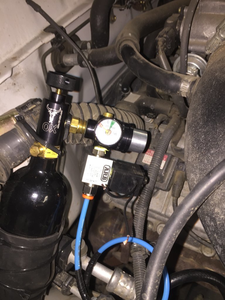

    Got my interim CO2 actuated ARB up and running finally! Had to ghetto fab the mounting for the tank, but I'm pretty proud of my sweet rubber sheeting isolation padding, if I do say so myself!
    It even turns on! Just need to find a good way to verify that the locker is actually locking...

    I know a treat way to test it, USE IT! But on my cruiser I tested it by trying to turn with it locked, it becomes really hard to turn. You could just jack it up and spin it too, but that's too easy.
    jubei[QUOTED][OP] and rngr like this.

    I would imagine getting off the pavement, locking it, and trying to turn while driving will tell you what you need to know.

    Hmm not sure the zip ties will last the bumps of the kokoplli..

    Maybe a steel band clamps might be a good option? I don't think rose garden will be an issue if we are going down. Mud is no bueno though haha also if it's jacked up on all 4 in 4wd you should be able to spin the front tire and they will spin opposite directions, and then lock and they spin in same direction.
