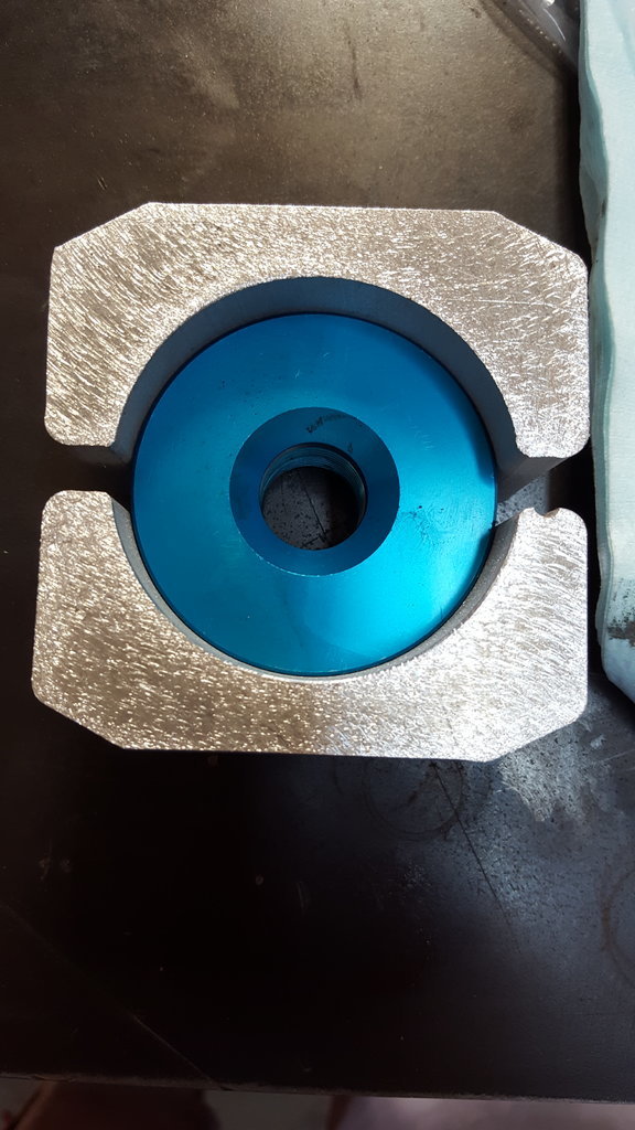

    Cutting 1.5" thick 6061 is pretty amazing.
    Some shock tools I cut out.
