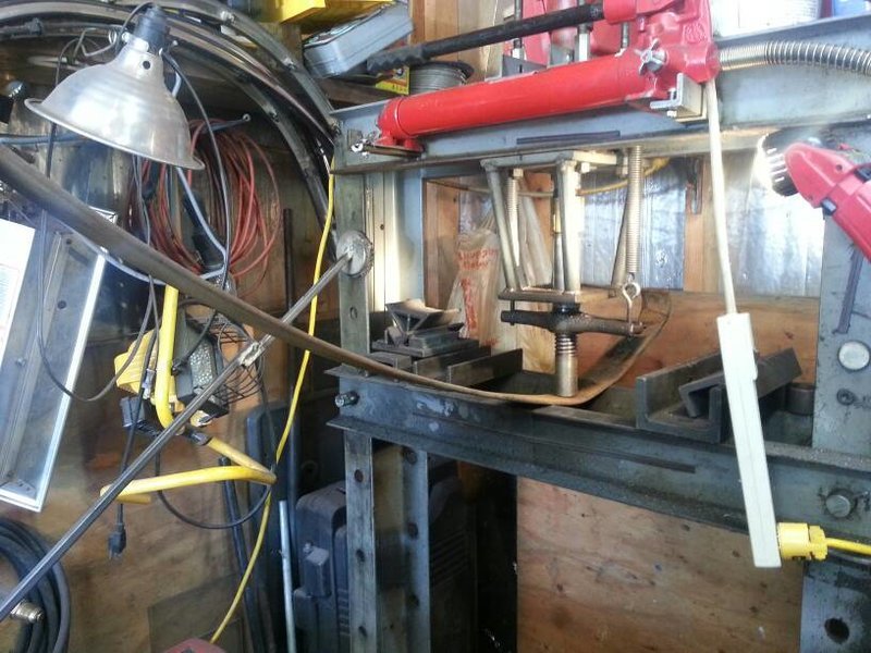

    Hey, @Squeaky Penguin, didn’t you and Old Brett re-arch your springs before you moved up to the new Alcans? How much of an ass pain was it?
    I’m pretty sure my heavy ass and my failure to relocate my bumpstops not only led to my bent axle flange, but also flattened out my driver side leaf pack quite a bit as well. When I got my Expos, the truck sat perfectly level and now I’m Taco leaning like crazy.
    I’d like to see if I can re-arch the springs prior to my shock relocate and get my ride height closer to the midpoint of the travel again. If that’s even possible...

    It's not difficult at all, just break down the spring pack and re-arch the leaves. You'll need a press. Do not arch the center by the centering pin, they will snap. I usually stay 8" or so away from the center and arch out to the ends.
    I think there is a pic somewhere of us in my garage with a leaf being bent up.

    the pic might actually be in @Squeaky Penguin build.

    Old Brett's spring arching.

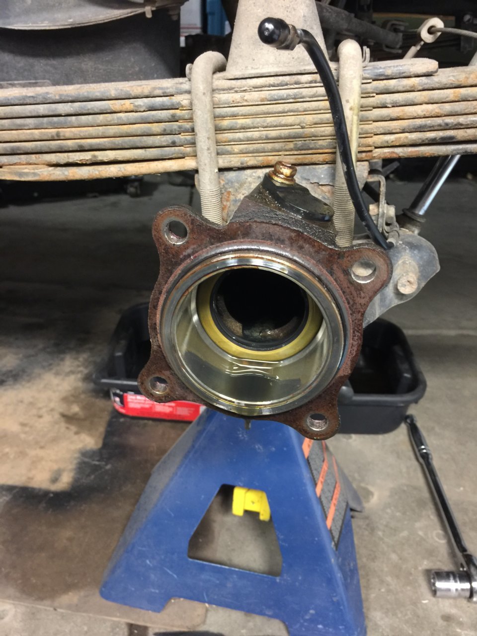

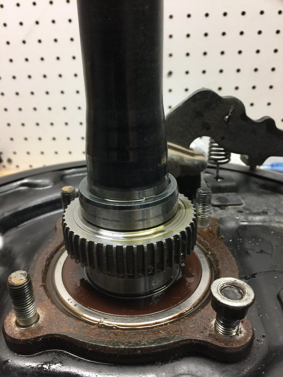

    Turns out bent axles shafts are bad for axle seals. Who knew?

    So that's what blown axle seals look like. If you don't get them done this weekend I'll be avaiable next weekend to lend a hand. Plus it would be a good learning experience before I do the tundra axle.

    Yeah, it hasn’t gotten bad enough to puke out onto the tire, but that would have been a matter of time. I’m hoping to get the new axles in after church today, but if it slips, I’ll definitely let you know, man!

    Once I got the drum off, I spun the axle and it’s got a good amount of both radial and out of plane runout. It’s bent good, for sure. Should be good as new, if not better, here shortly, though!
