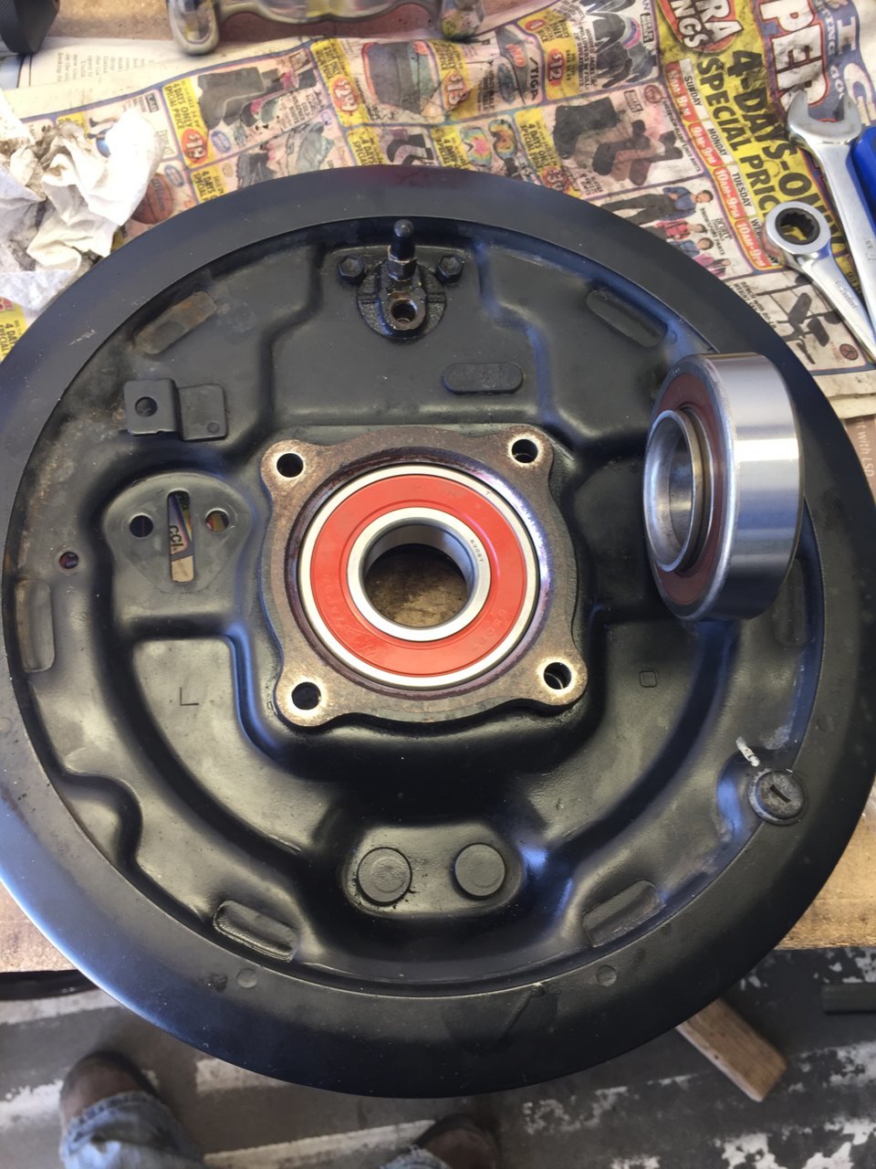

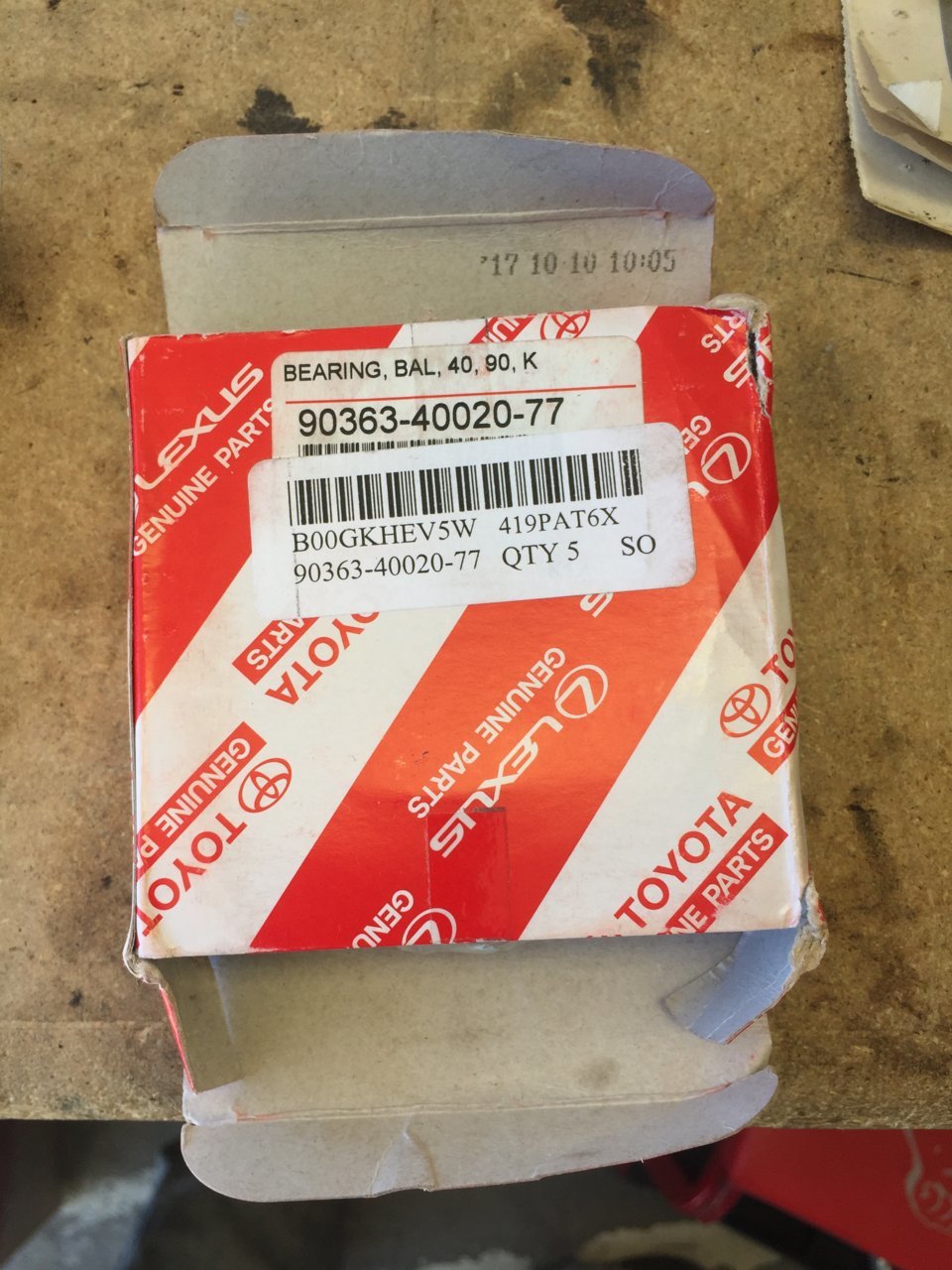

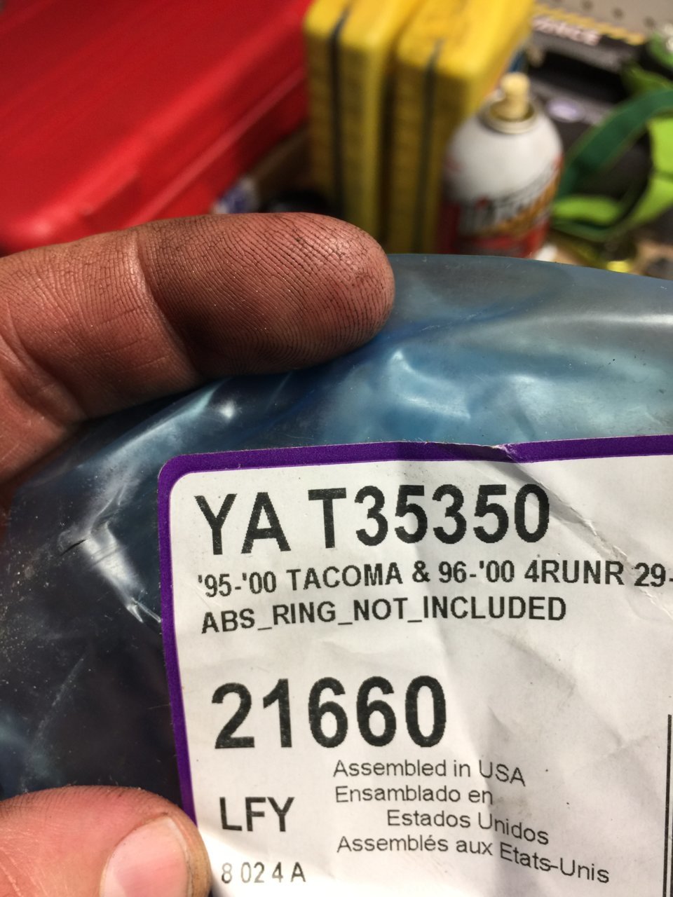

    Didn’t end up taking many pictures, but here are a few. I included the part numbers for the 4340 shafts and the early 1st Gen bearings. Ended up getting the inner retainers lined up almost perfectly over the seal, so hopefully that helps keep the gear oil where it’s supposed to be.
    Drove it about thirty miles tonight and the wobble is completely gone. Now it’s time to swap my ac tensioner pulley and slap a new bearing in the old one as a spare. It’s squealing pretty bad.

    That backing plate is so clean :eek:

    I was thinking the same thing! The entire outer ring rusted and fell off mine and then bent when I was changing the rear bearing lol!! So jelous of the dry climate!!

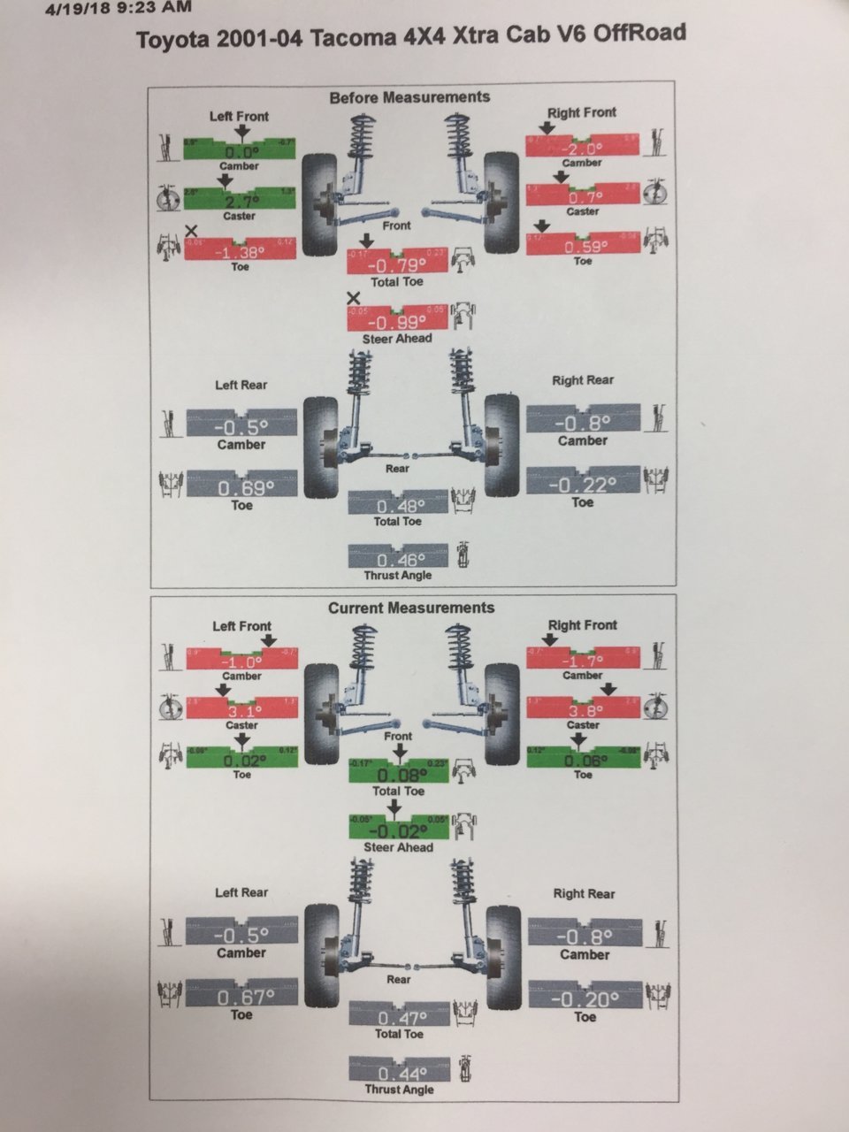

    After @TMFF was kind enough to swap my coils from 600s to 650s, I finally got a chance to hit up RSG Offroad for an alignment.
    Joel was awesome as usual, and was able to get me pretty decent numbers. I was willing to accept a bit of negative camber to get a bit more caster out of the LCAs.
    Damn nice to have a truck that tracks straight ahead with a centered wheel. Feels super planted in the turns too. I also got my ride height back along with a better balance of bump and droop travel. The 600s just couldn’t handle my fat ass.

    You are going to have tire wear issues with those numbers. That much negative camber is not good on these suspensions. You'll actually have scrub issues turning. Look for accelerated inner edge tire wear.
