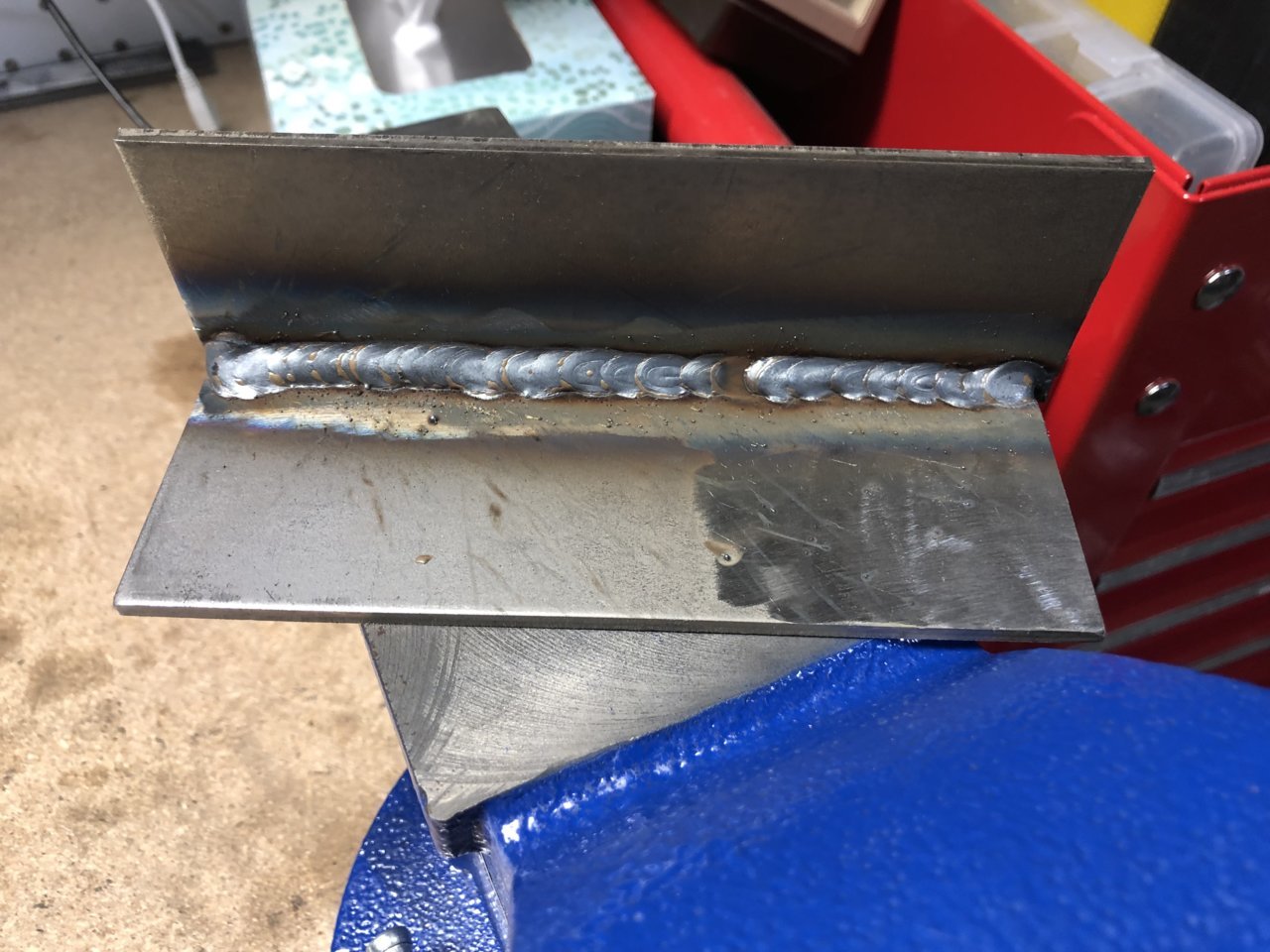

    More welding practice...

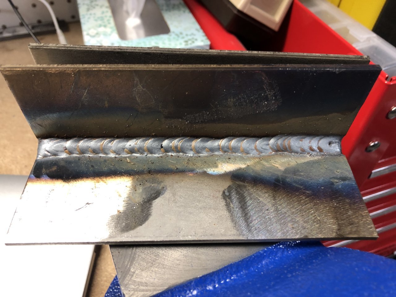

    2nd attempt.

    Looks good man! Thing that helped me a lot was getting in a comfortable position and stabilizing my torch hand and that gives me a real consistent bead. Now glue some cool stuff to the truck haha

    Thanks!
    You’re exactly right about being comfortable. I’ve been using my left hand to help prop up and steady the gun and it’s been night and day. It’s so much easier to keep the right angle and wire stick out. When I tried just using my right hand unsupported, I was all over the place.
    I’ve got a TON of welding to do here shortly. Gussets and limit straps up front and shock mounts and straps in the back along with frame reinforcement. I’m getting a lot closer to finally feeling confident enough to weld on the truck, but I still need a little more time. Can’t wait!

    That looks plenty good to start burning stuff onto the truck! :thumbsup:
    The one thing I wish I would have practiced more was out of position welding. Hard to simulate all the positions you'll end up in though. I can lay nice beads on a bench, but a lot of time you can't get into a great position welding on the truck.
    I've found taking several dry passes to get comfortable and get yourself in a position where you can smoothly move the gun is what really helps.

    I was just about to say. Great job!
    till you try it upside down :laugh:
    Practice that. Upside down with one hand half blind. You'll be doing some of that. Also vertical welds.

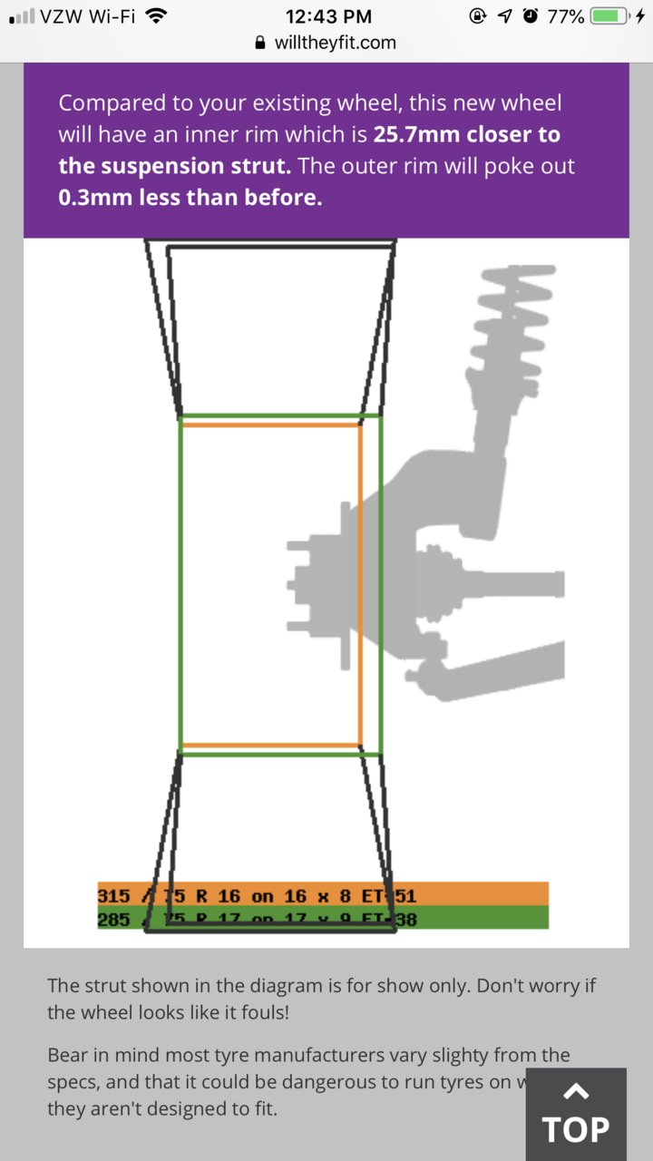

    I’ll definitely be practicing in all positions, and I’m sure vertical and overhead will be a bitch! That said, I’m pretty excited to try it out and see how I do. I have a ton of scrap, so I should be able to practice all the positions and all of the joints. I really enjoy it so far.
    And the 315s aren’t going anywhere! At least not for awhile. I may see if I can unload them at around the 20-25k mark, but that’s still a ways away. I was mostly just goofing off with the calculator and visualizer.

    Thanks, Brett!
    I like the idea of getting the setup nailed down as best as possible and then doing some dry passes first. Great idea when it actually comes time to weld on the truck.
