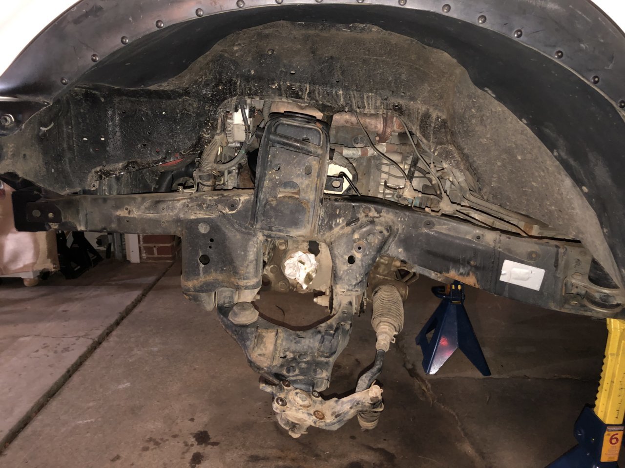

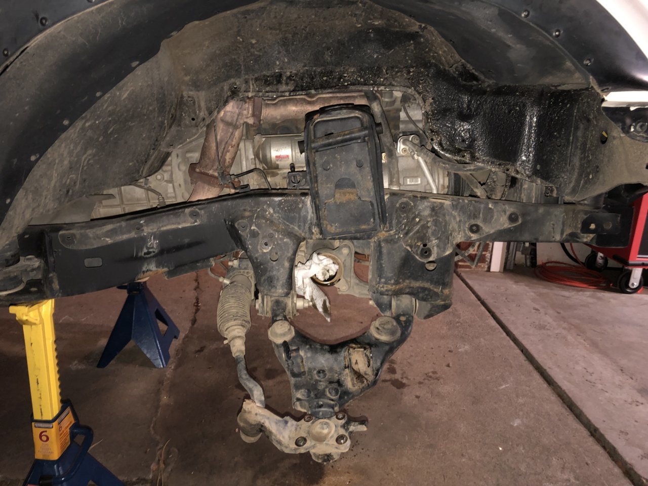

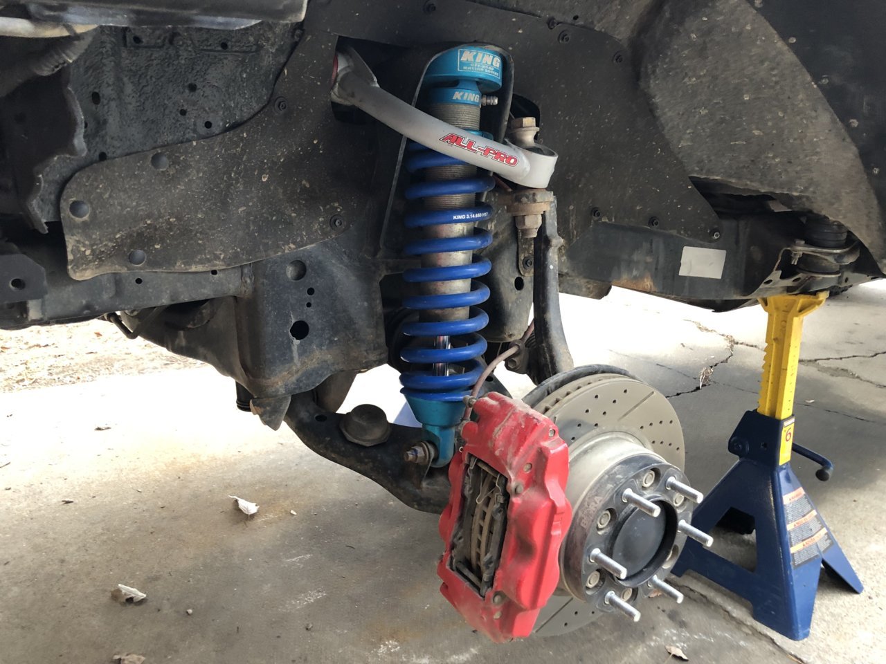

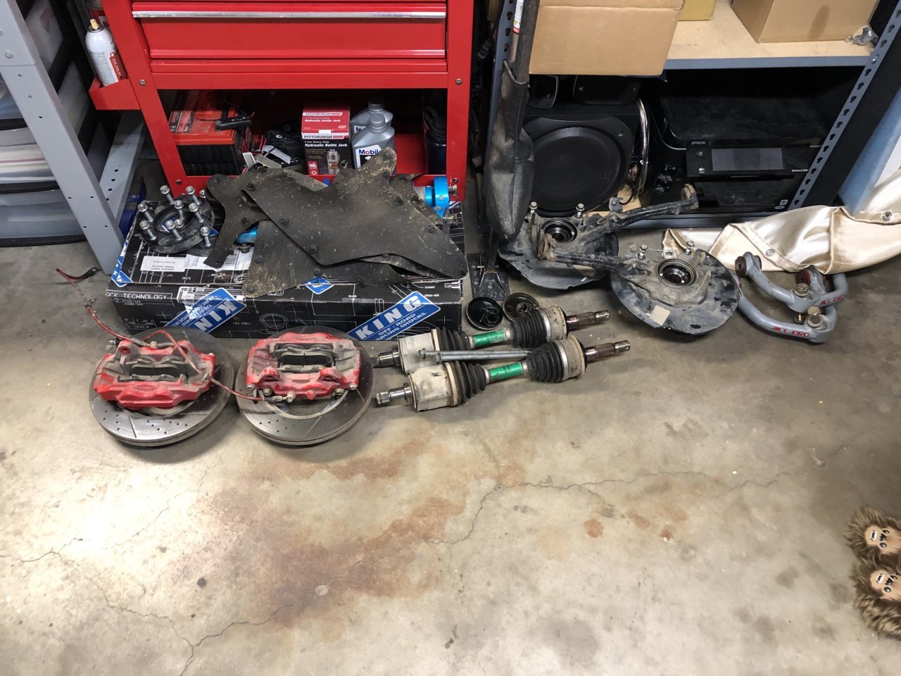

    Despite some nasty wind earlier, today was a great day.
    I started with this:
    And pulled all of this:
    To get to this:
    If all goes well, tomorrow I’ll be pulling the rack, as well as the LBJs and LCAs. Then it’ll be time to start tearing off the old cam tabs.

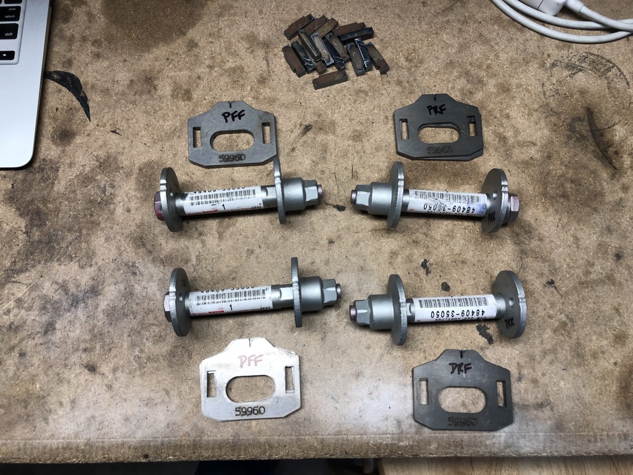

    Also have new cam hardware ready to go in once the Whitelines get swapped into the LCAs.

    Oem bolts?
  13. Dec 12, 2018 at 8:02 PM
    #1833
    jubei
    jubei [OP] would rather be doing something else
    Mar 17, 2016
    #181549
    6,061
    Jason
    NoCo
    White 2002 XC TRD and Yellow 1971 JEEP CJ5
    Stuff. Also things.
    For the alignment cams?
    Yep!

    Don’t be afraid to burn the shit out of those. You can always grind down whatever is in the way. Good amount of heat.

    Are you referring to when you’re welding the 1/4” bar stock to the tab or the tabs to the truck? Or both?

    The 1/4” stock. Think of it this way, you’re trying to make it into one solid piece. Also it wouldn’t hurt to run a bead along the outside of the stock.
    Welding it to the truck with a few stich welds should be fine because the washers of the bolts keep compressed against the tab.
    jubei[QUOTED][OP] likes this.
