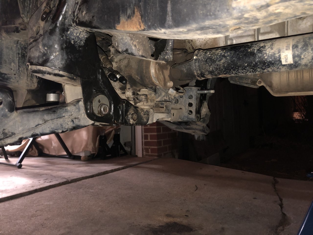

    Got the LBJs and rack pulled and threw them on the pile. Also picked up a spot weld bit (thanks to @Squeaky Penguin for the idea) so I can start removing the stock cam tabs.
    Not as far as I wanted to get today, but progress none the less.
