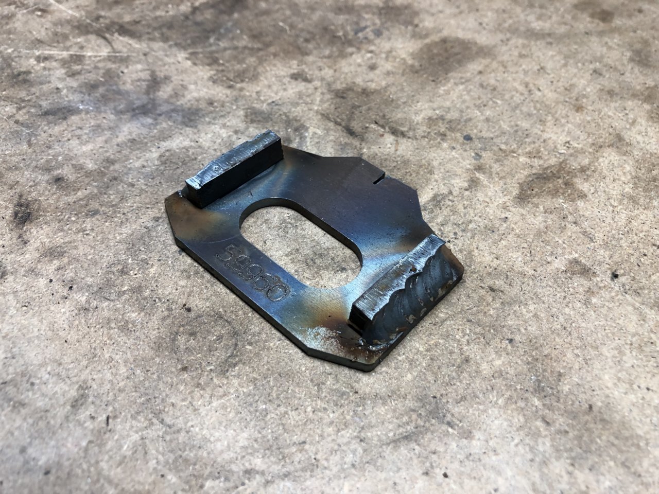

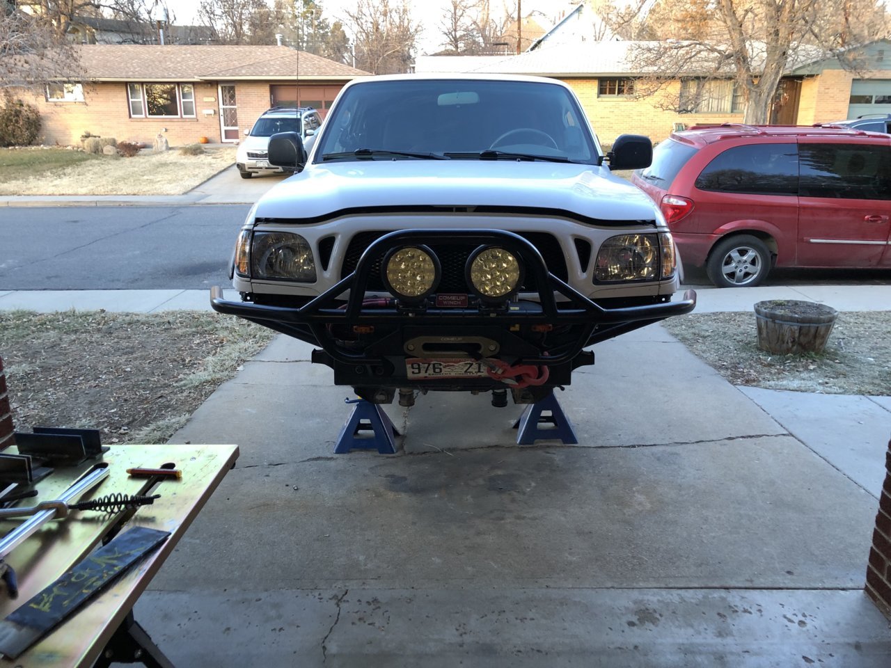

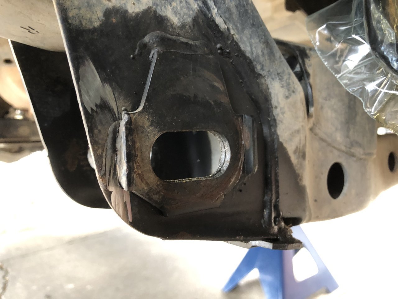

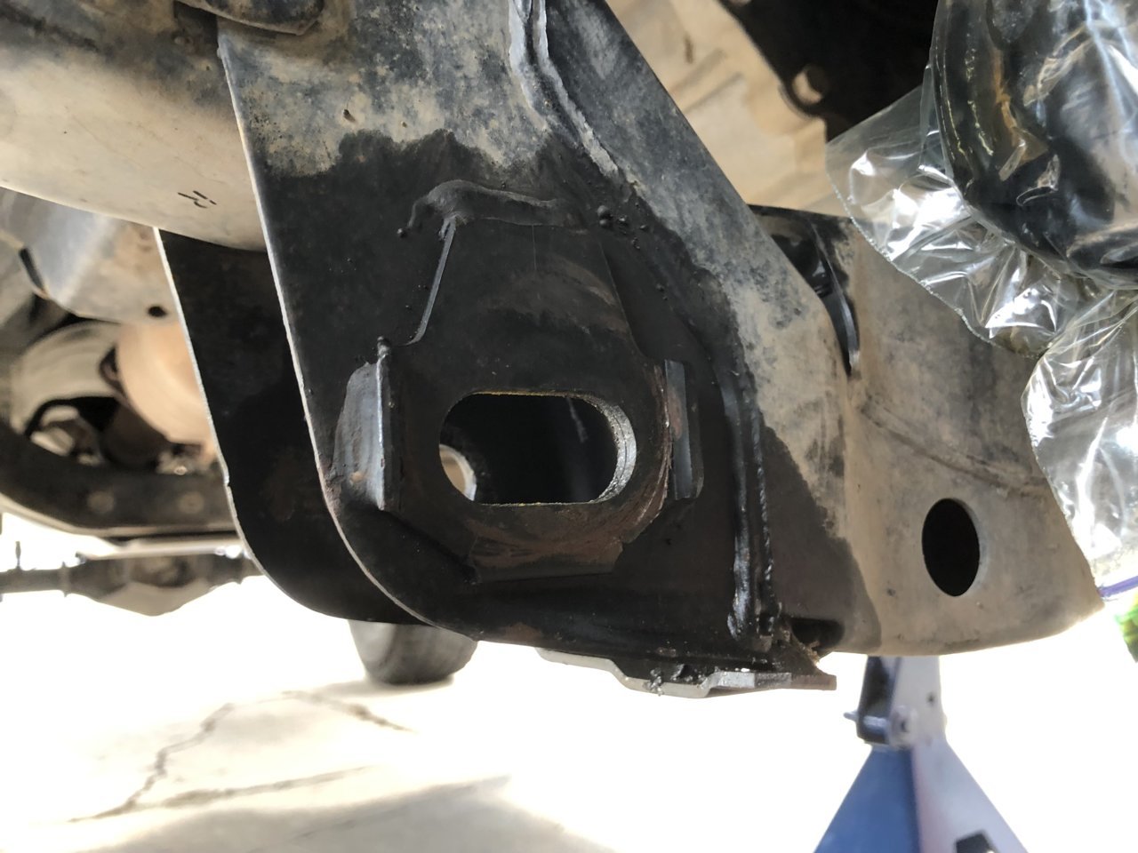

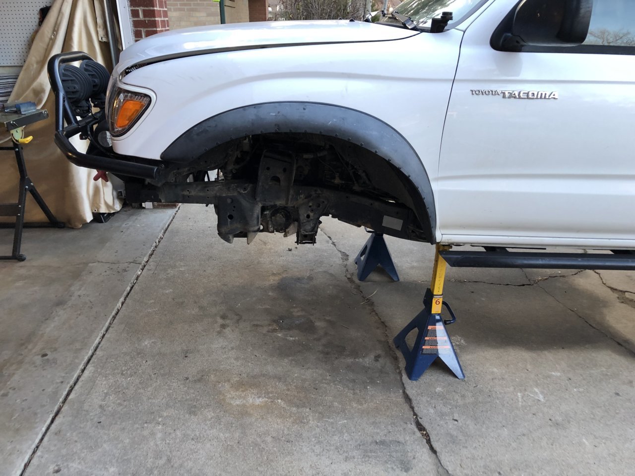

    Got a little bit more done today.
    The truck looks like it has a nasty overbite after tearing everything down.

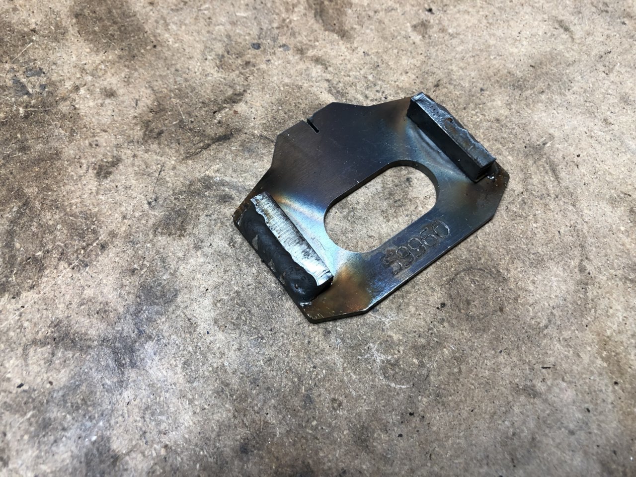

    I was able to get the cam tab gussets welded up. They’re a little rough, but they’ll do the job. I went a little hotter and I got a little bit of undercut at the top edge of the 1/4” stock. Should be fine, just not super pretty.

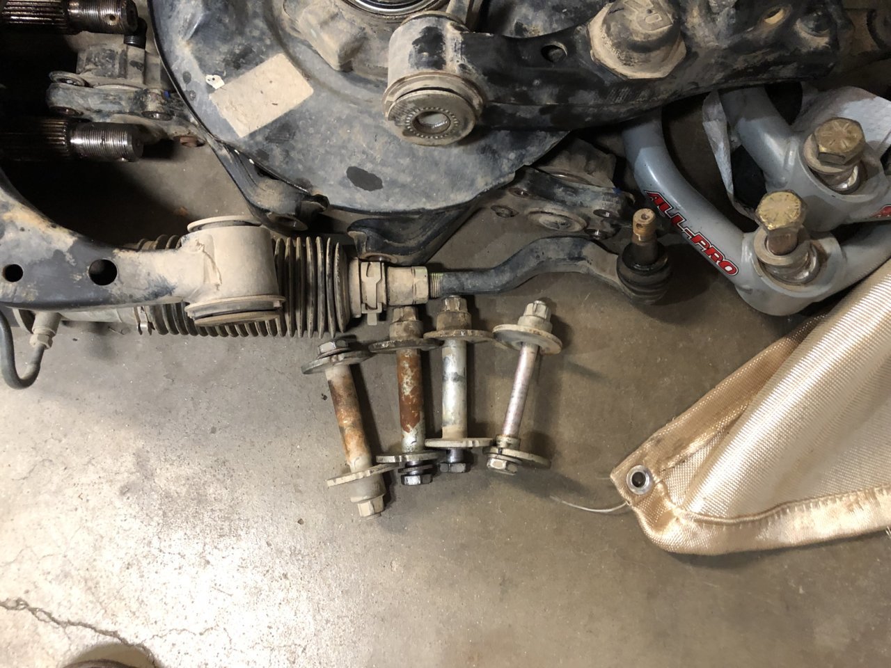

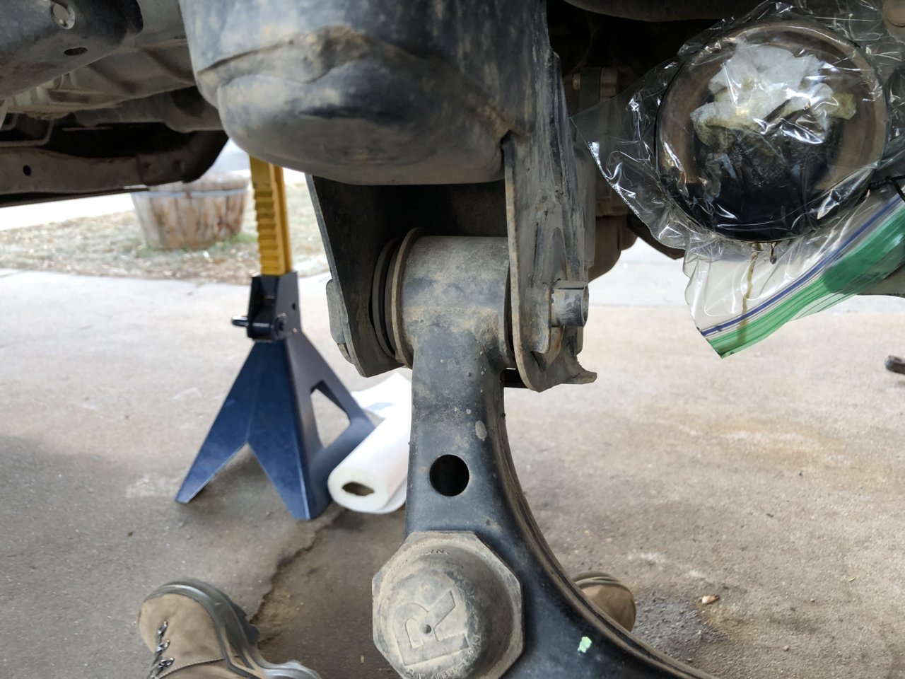

    I also pulled the LCAs, which for the most part was not a huge deal. Turns out, @thefatkid was right. I had a seized cam that required a sawzall to remove. Two of the other cams were pretty rusty as well. I’m definitely gonna anti-seize the shit out of the new ones when they go in with the new bushings.

    You don't want to put too much anti-seize on those cams. If you put too much on it could cause it to slip. So just a nice thin film on there will be perfect.
  5. Dec 14, 2018 at 4:47 PM
    #1865
    Reh5108
    Reh5108 Well-Known Member
    Feb 18, 2013
    #97832
    5,774
    Idaho
    2004 SR5 4X4 2.7L Extra Cab
    OME lift, 4x sliders, Demello rear bumper, custom front bumper, Engo 9000lb winch
    Careful with the antiseize. Theoretically the clamping force from the bolt should keep your alignment so make sure the mating surfaces are clean and dry. A very think layer should suffice just to prevent corrosion Honestly since you have SPC uppers once you set your cams for max castor you shouldn't ever need to adjust them. If they seize again it shouldn't matter unless you need to replace a lca.

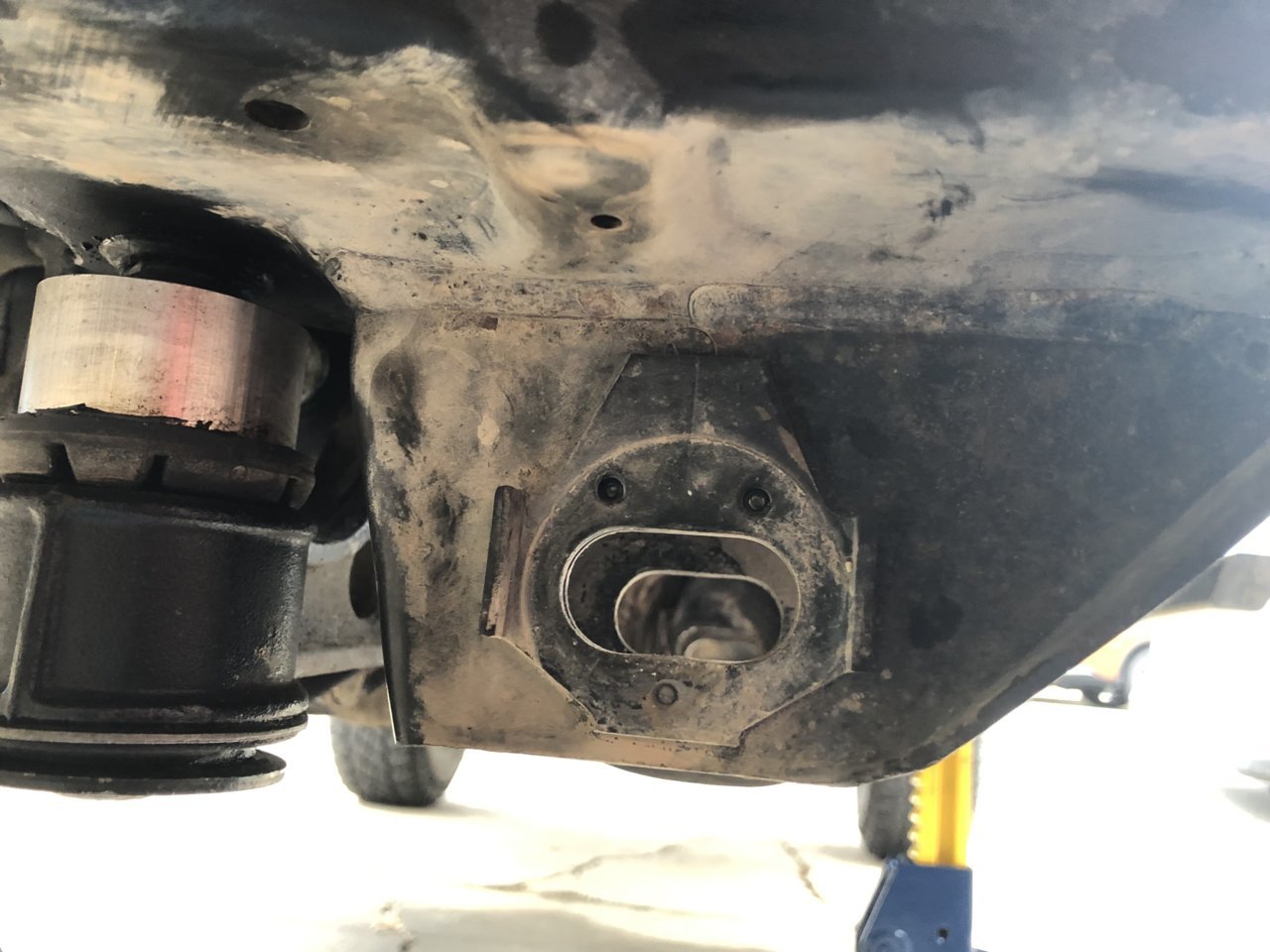

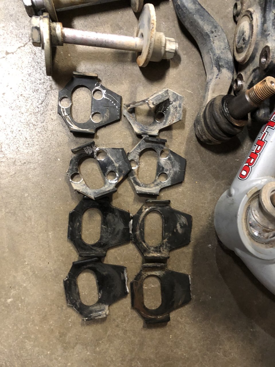

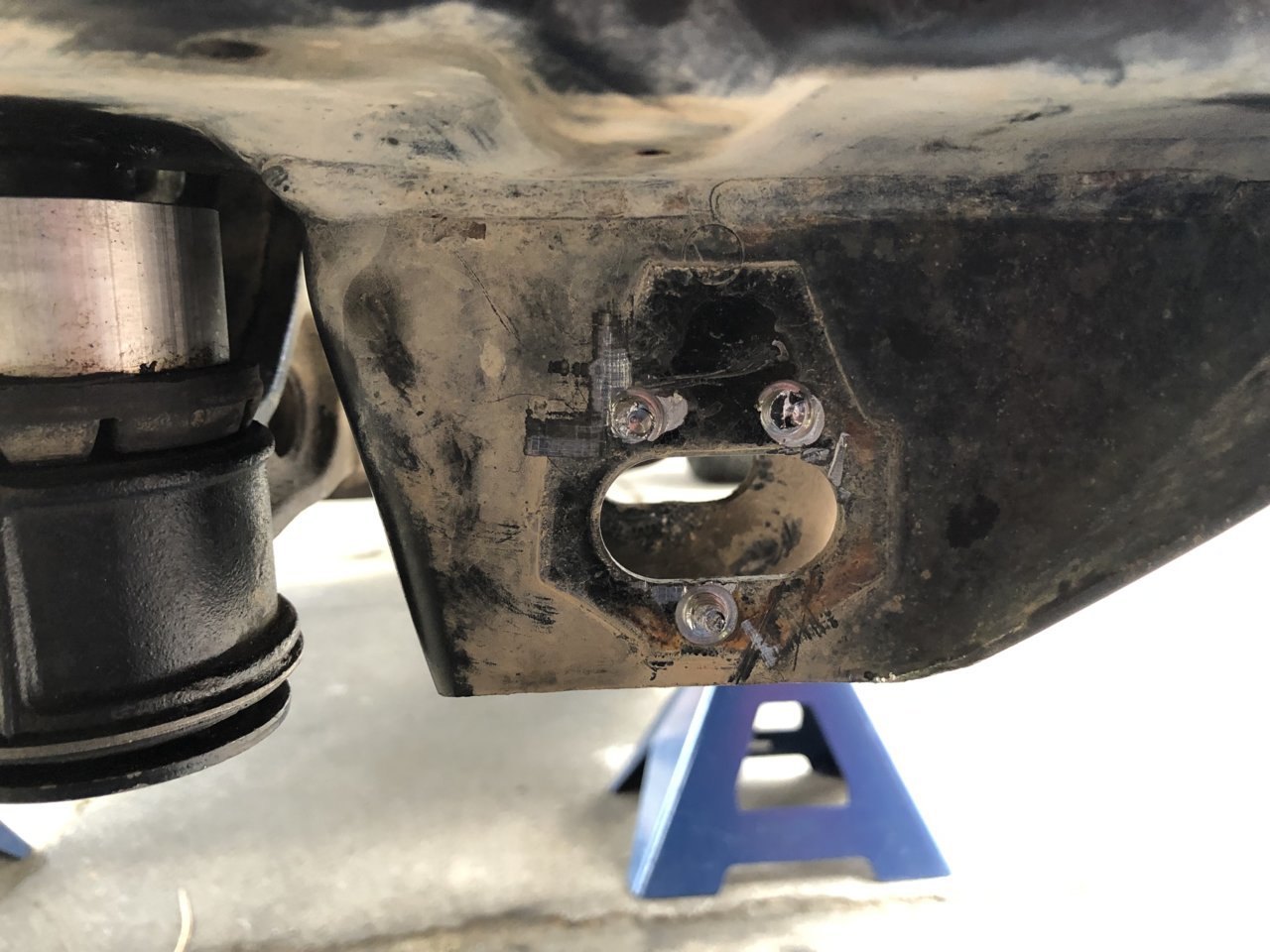

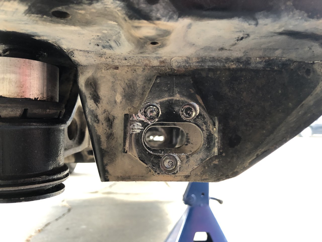

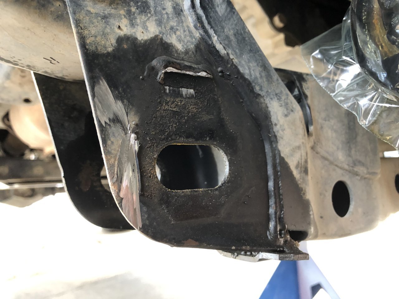

    Just got the OEM cam tabs off. Took some doing, but it really wasn’t too bad. Not sure if I’ll get to welding the new tabs on today or not, but it’s definitely good to have this behind me. It also means that I’m committed at this point. Gotta see this through and get her back on four wheels!
    Pile of old parts.

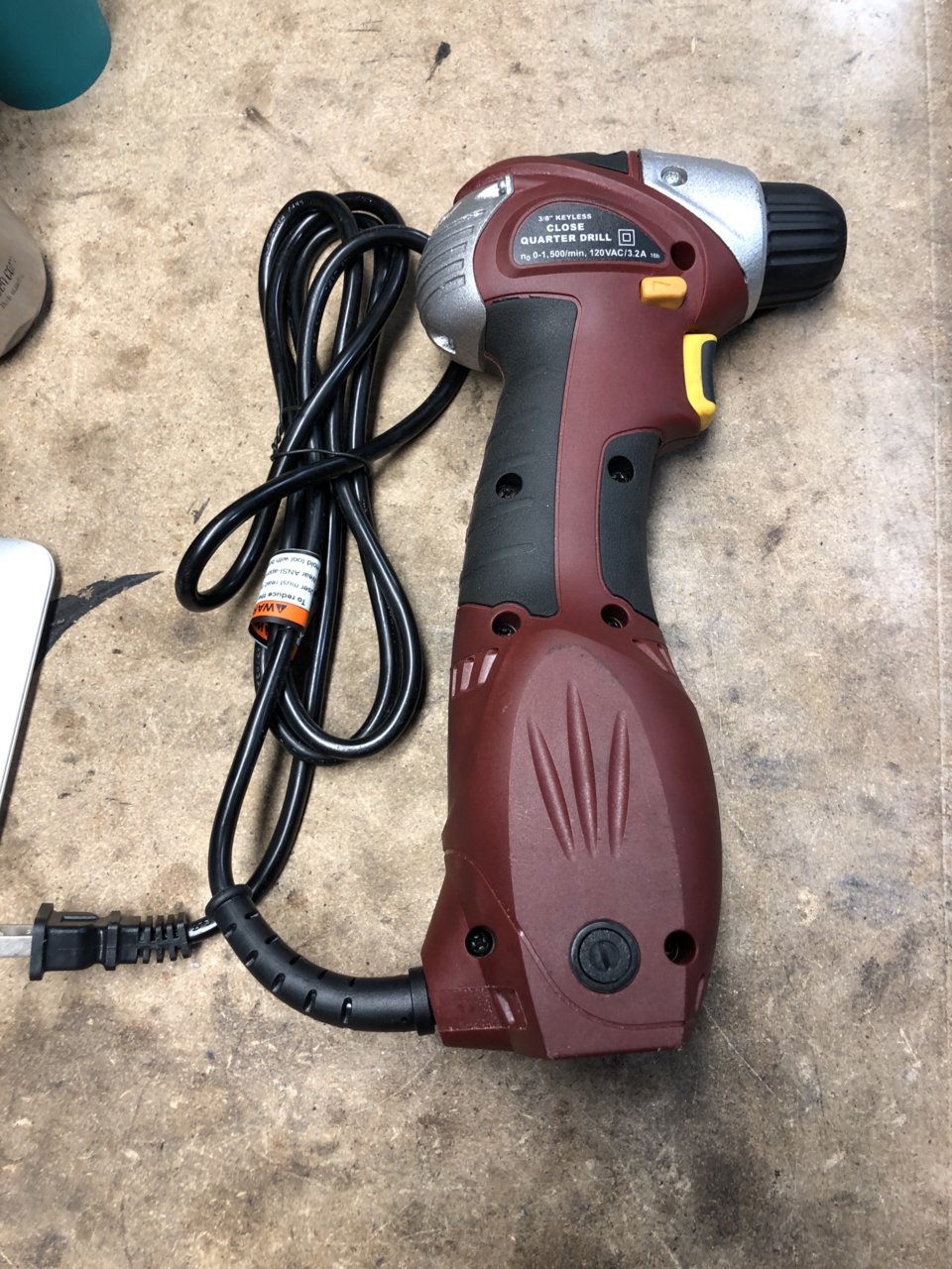

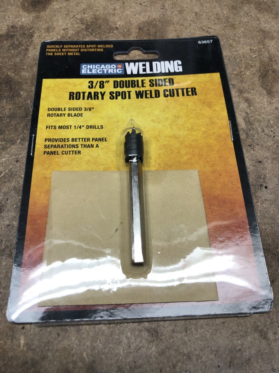

    Sweet spot weld drill. I went through two of them due to breaking the teeth once the bit went through the original tab. Totally worth it and pretty cheap at Harbor Freight.
    This helped a ton with drilling out the spot welds on the inside front mounts. Highly recommended.
    Pretty straight forward process. The tabs on the front mount are the ones that require the spot welds to be drilled out. Once that’s done, it’s a (relatively) straightforward job of wailing on the tabs with a hammer and chisel until they pop off.
    The back mounts are much easier. They are welded at the top and on the outside edge. I hit the outside weld with a cutoff wheel and then pried the tab off. They did require a little chisel work, but all in all, not too bad.
    Now I just need to break out the right angle die grinder and grind off the leftover spot and stitch welds. Then I’ll sand down to bare metal, sand the new tabs, and burn those shits on!

    I wish I had a 90* drill when I did my cam tabs.

    The spot welds we’re a pain, but that drill made it so much better.

    Ya the spot weld drill bit was great. My stock tabs had been welded a little because they got flattened out at one point. So they were a giant pain.

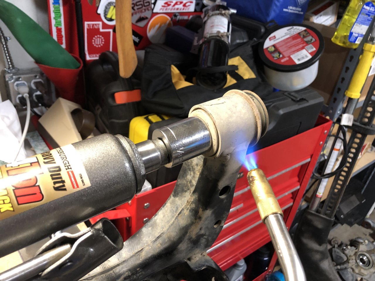

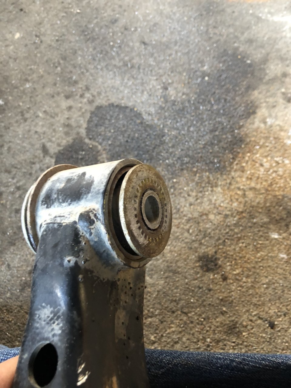

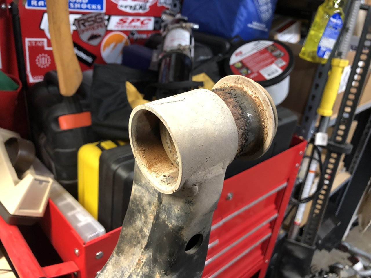

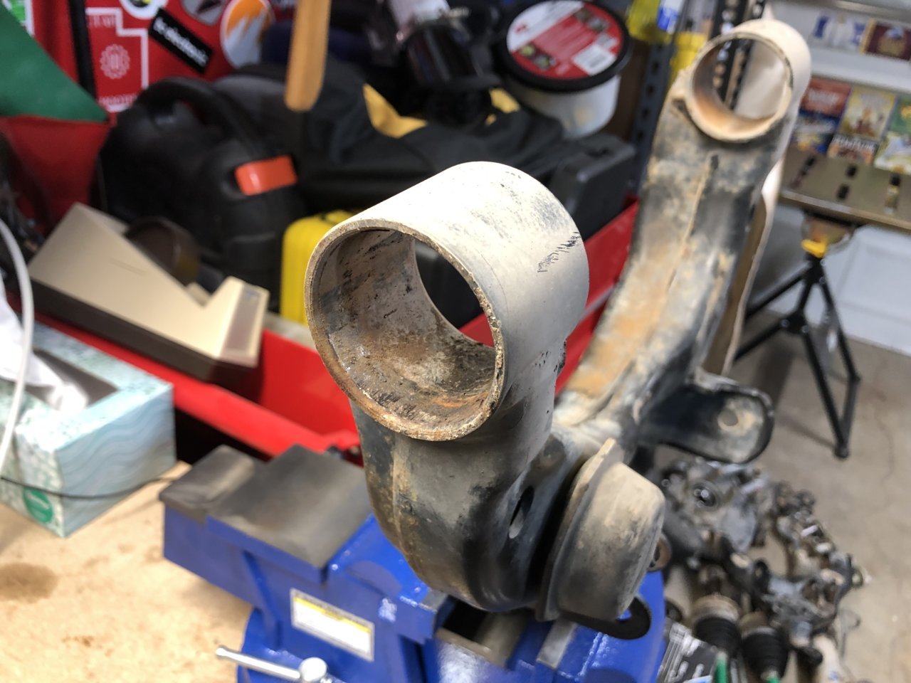

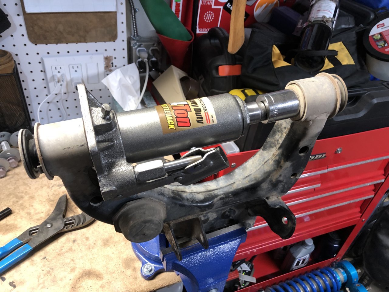

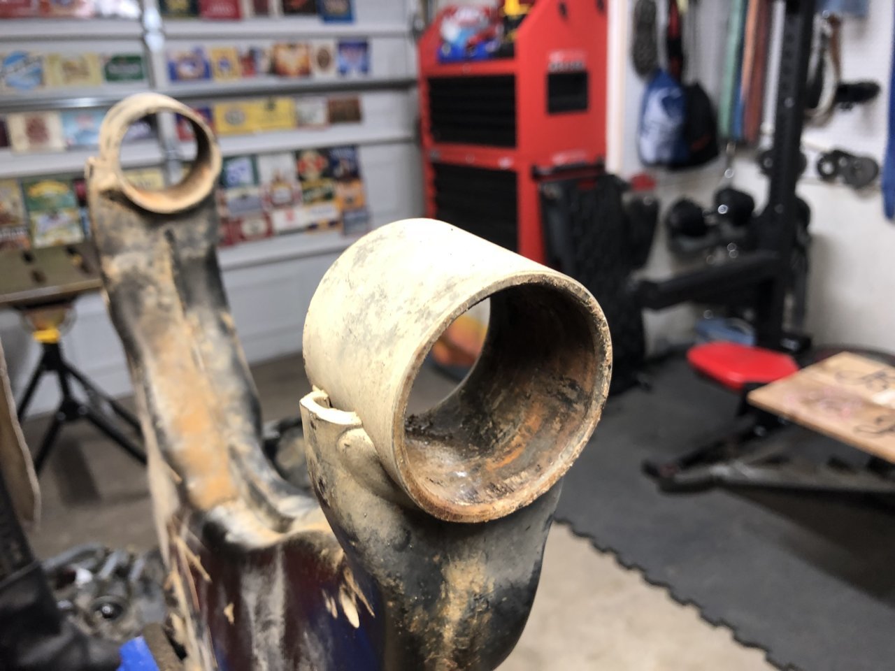

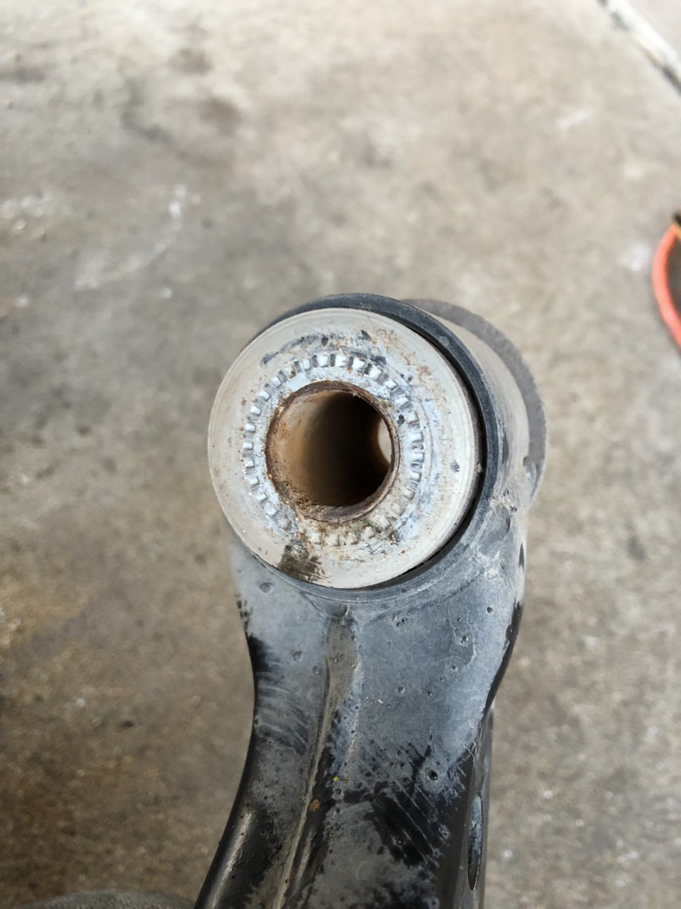

    Finally getting over this shitty stomach flu, and I decided I wanted to make at least a little more progress on things today. Unfortunately, due to really gusty wind all day, I wasn’t able to get the new cam tab gussets burned onto the truck. Instead, I decided to take a shot at removing the old OEM LCA bushings and the spherical bearings from my coilovers.
    Turns out, the bottle jack and MAP torch trick works like a charm. The old bushings came out no problem despite a decent amount of rust. All in all, it was a fairly straightforward process.
