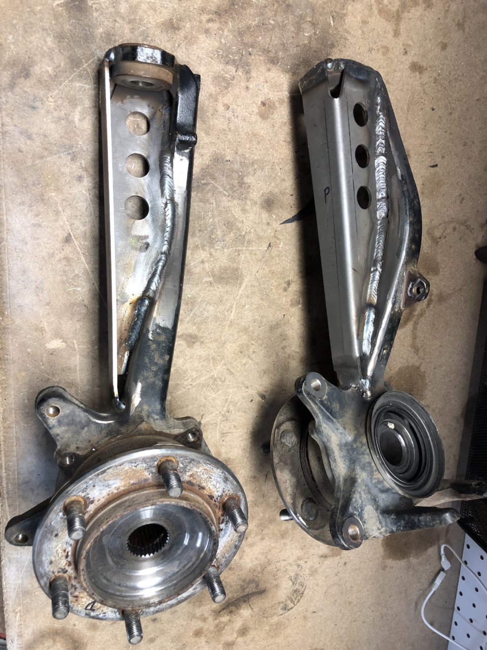

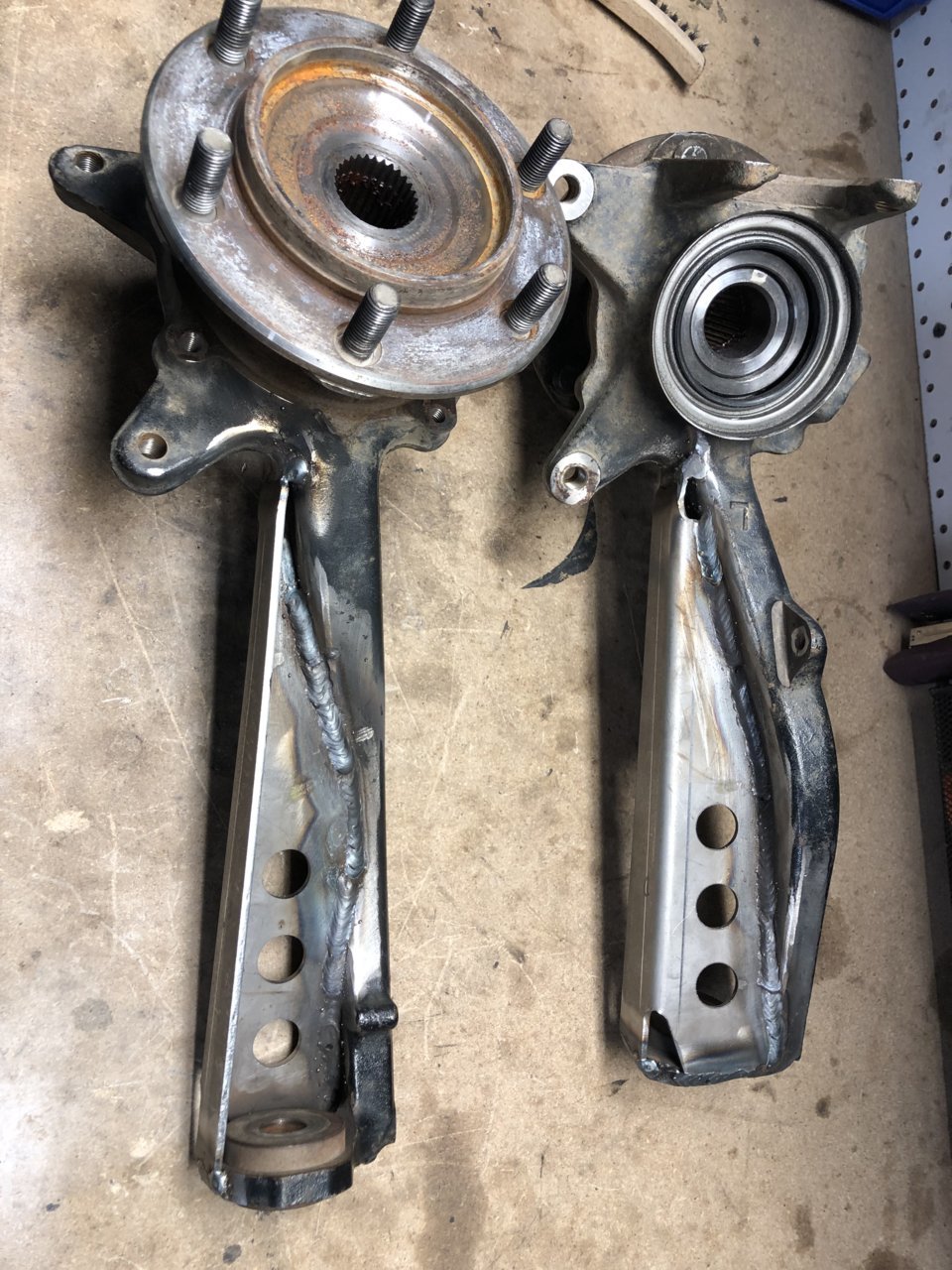

    As always, stuff takes much longer than I anticipated, but it’s getting there. I’m bailing on the coil bucket gussets for now, but I’ll keep them for later when the opportunity presents itself. I just finished welding up the spindle gussets earlier this week, but I haven’t posted up any pics yet. I’m pretty happy with the results.

    Got these dudes welded on! I feel really damn good about how they turned out.
