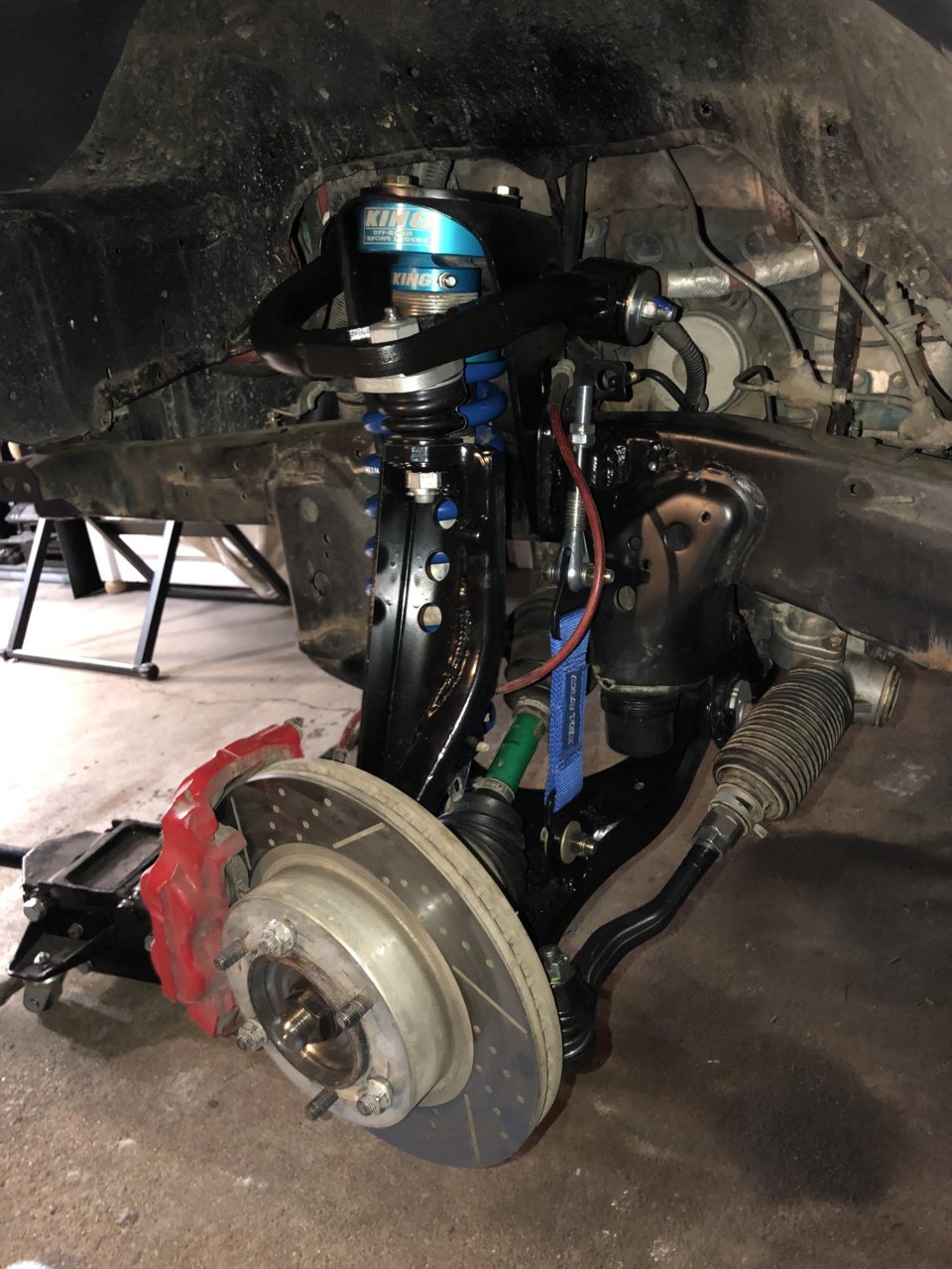

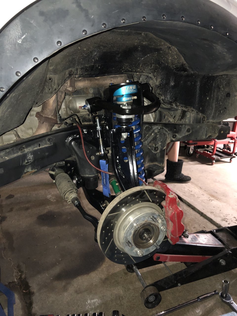

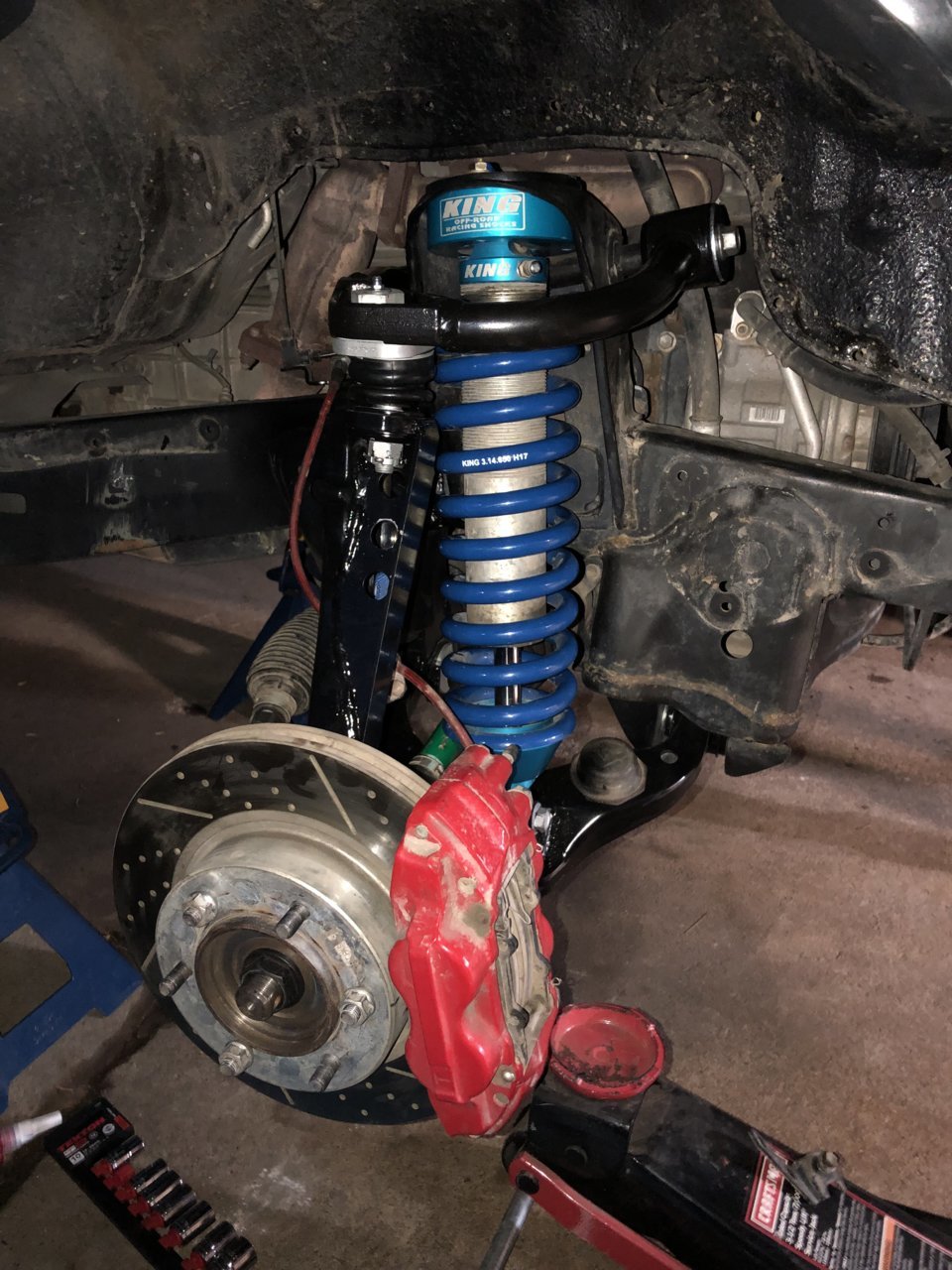

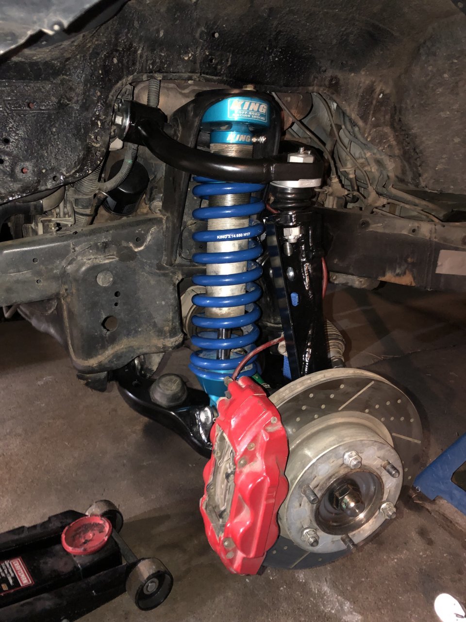

    Got the passenger side reassembled. Hoping to get the driver side done tonight as well.

    Driver side is done!
    Next up is the power steering cooler and filter. After that, I can fill the brakes and the PS fluid and bleed them.
    Almost there!!!
