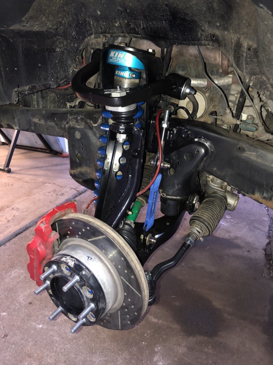

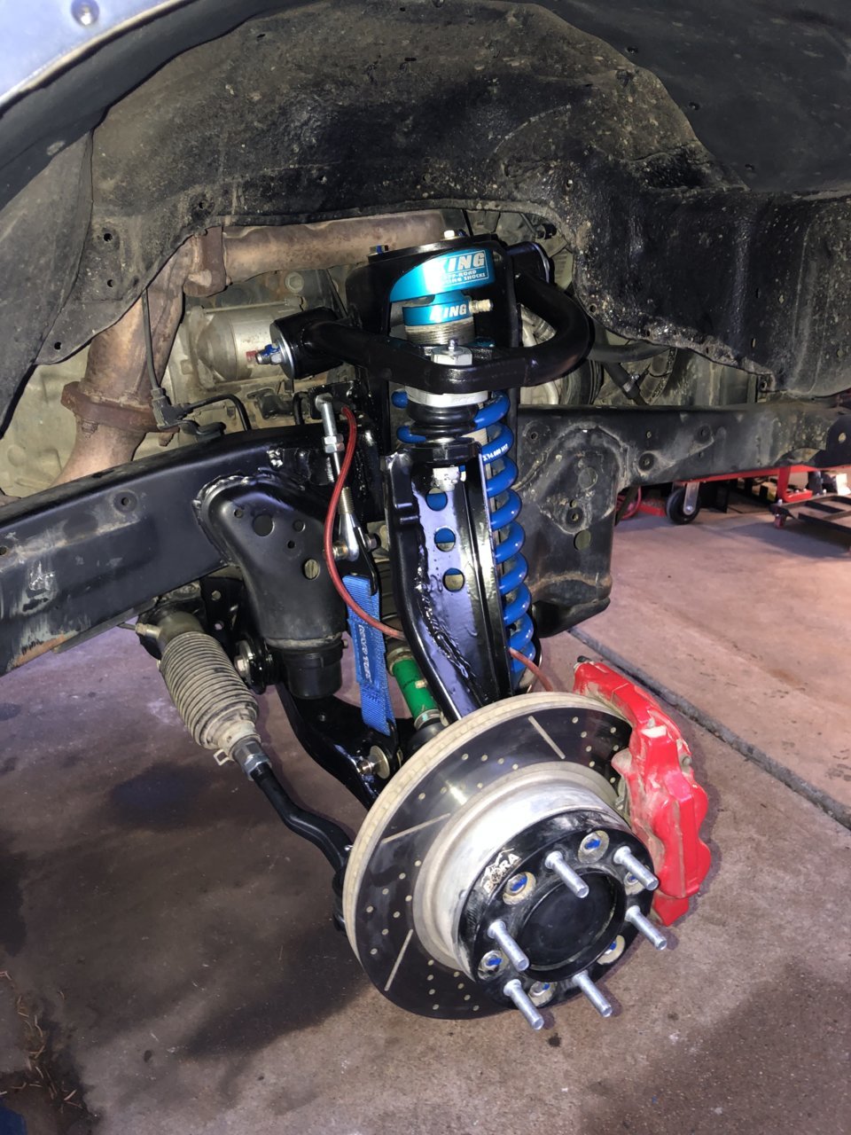

    Got the brakes hooked up again, the CVs torqued, and the spacers mounted up and staked. Just need to fill the front diff, power steering fluid and brake fluid, do some bleeding and then I’m basically done. It does look like my toe is off despite trying to replicate what I had before, so I need to get that back to normal before I drive it to get it aligned for real.

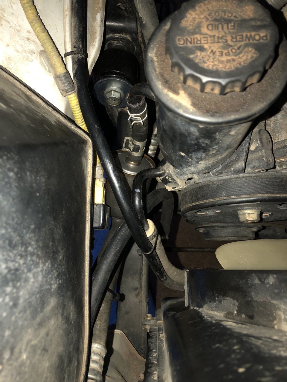

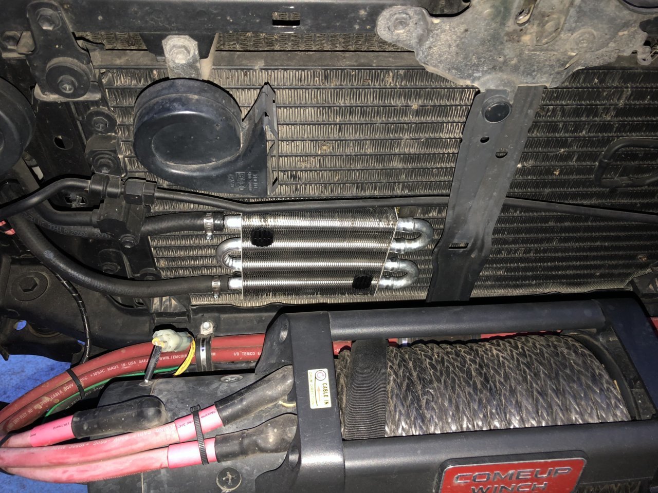

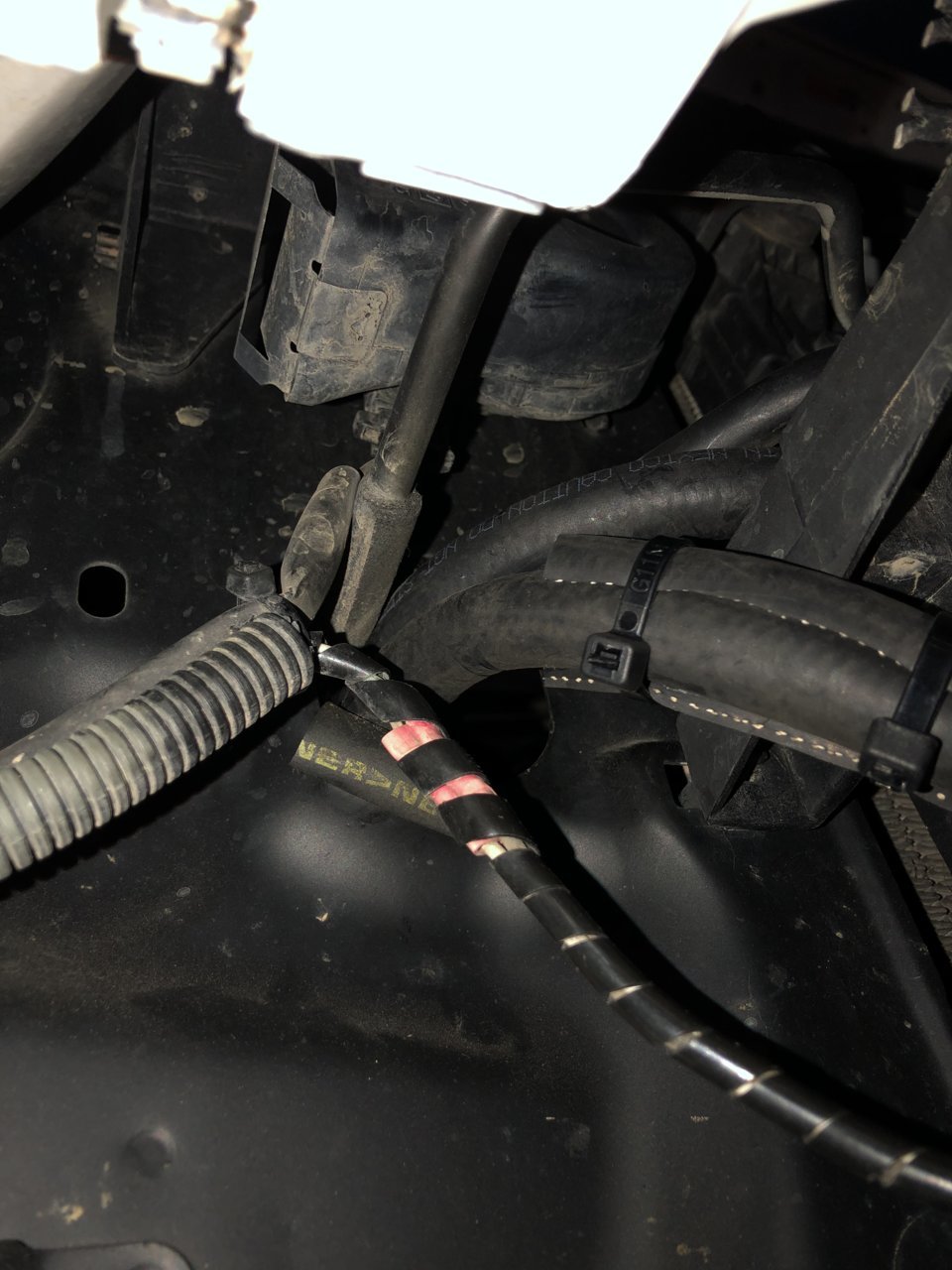

    I also got the power steering fluid cooler and filter installed, which should help the pump and the rack immensely. I ended up using some of the leftover hose for abrasion sleeves and a ghetto grommet where the hoses go through the core support.

    What's the main purpose of adding a filter and cooler to the power steering? Will it actually benefit it enough to justify doing it?

    The filter will definitely be a benefit. The cooler is kind of a toss up but is so cheap and easy enough to do, why not install one? It helps increase the fluid capacity slightly and isn't going to hurt anything. And just about any kind of wheeling puts a good strain on the power steering system, which will build heat. I see it as preventative maintenance that will hopefully help the steering rack and pump last longer.

    Filter is a great idea. The mesh in the reservoir gets plugged all the time which causes more problems then not. Easier to clean a filter then that thing.
    Cooler idk if it'll help. Can't hurt especially for big tires.

    Running 315s even for the relatively short time that I have had pretty much zorched my power steering fluid. When I pulled the steering rack the fluid was brown. Not even a little bit red. Since my rack and pump are still in really good shape I figured it’s worth it for such a small investment.
    I’d consider it since you’re running basically a brand new rack, right?
