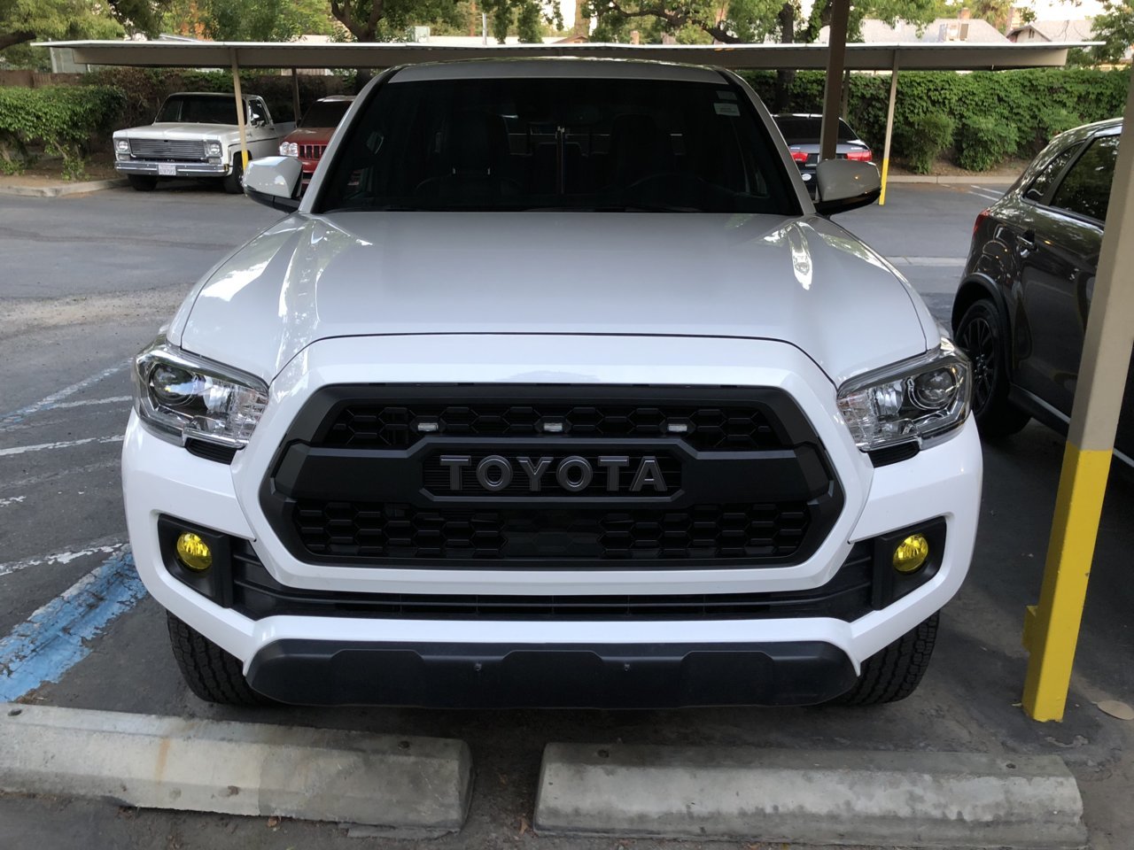

    0188D3DF-F339-4626-8220-50D3BEAF1E78.jpg B61CE0AE-3107-43F2-906D-44422B105E62.jpg

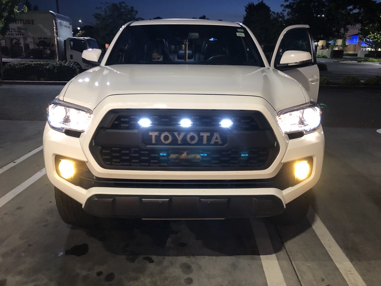

    I installed mine a couple days ago on my super white OR, loving them so far.

    -285/70/17 Toyo AT3 -Tuned
    Can you elaborate more on this? Maybe link the products you used?
