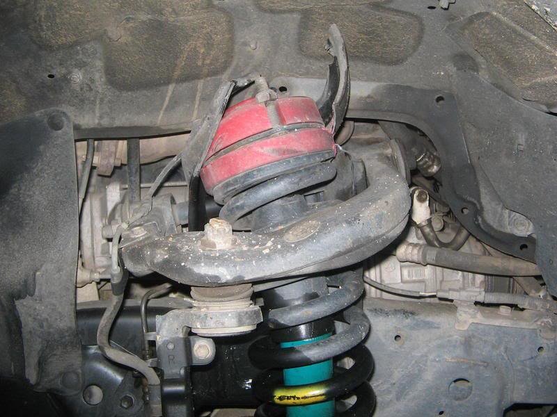

    Spacer lift will damage your truck.
    Save your money and do it right.
    Good luck with your truck.

    Yes as long as you aren’t using truck hard and bottoming out the front end a lot. Regardless of what people do it doesn’t make it right. When you lift using spacers no matter what the bump stops need to also be spaced down to ensure the shock won’t be the bump stop, but the upper control arm will be the limit strap which is never good. That’s why smart people don’t recommend them.

    I’m not acting any sort of way, I’m simply stating facts about spacer lifts. They are fine for street driven trucks, or very light Offroad. But there is a reason for bump stops and the way they are set up from factory and as soon as you space the shock down with a spacer on top in the event the truck bottoms out and (In my opinion that’s pretty darn easy) guess what happens? The bump stop is not taking the force like it should and your coil buckets and shocks are taking the force in a hard bottom out. It’s simple math. The most spacer height you can add without worry is about 1/4” to 1/2” on top of a factory shock.

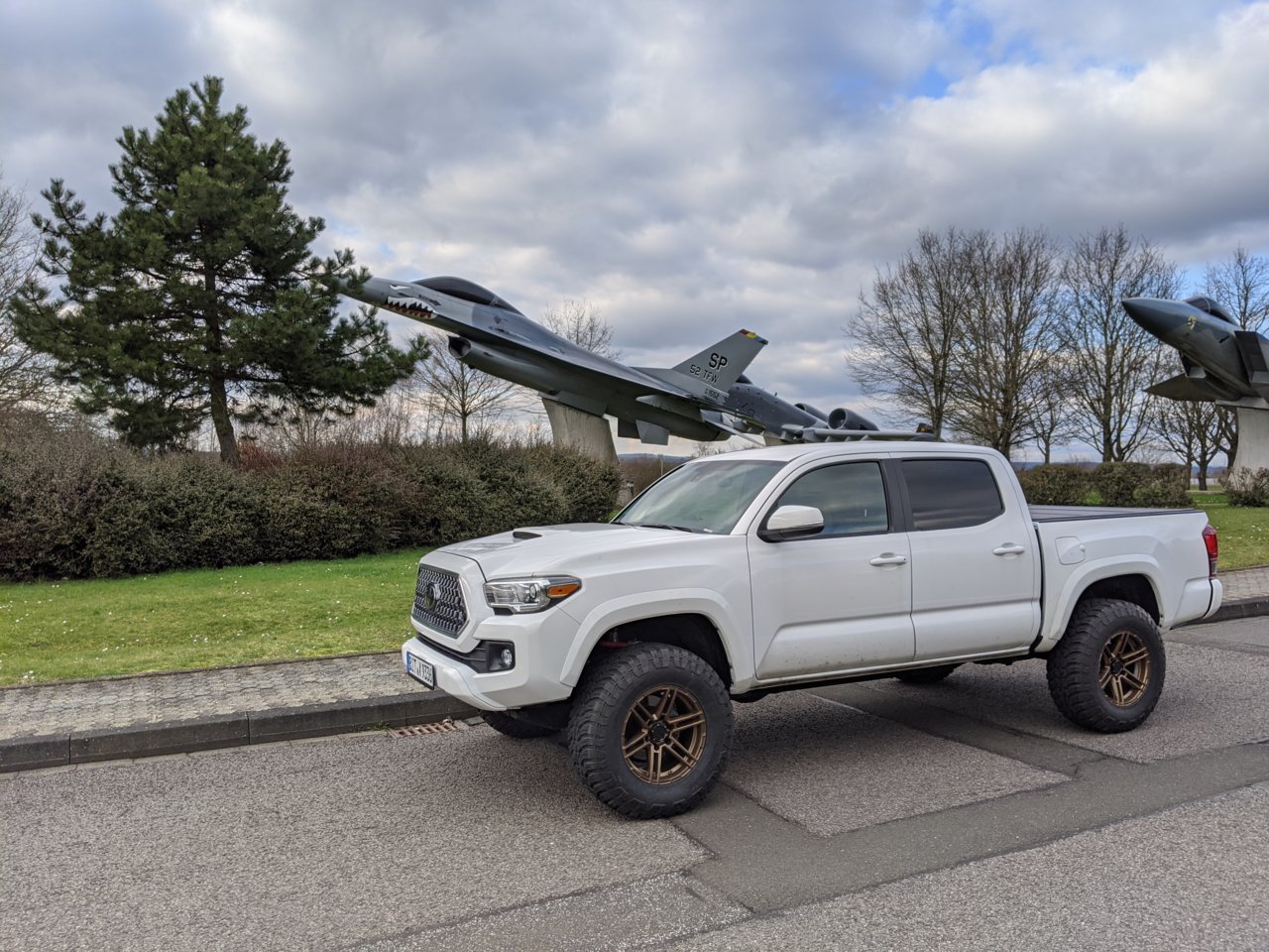

    Op, if your looking for pics my truck is lift 2" in the front and 1.5 in the rear with spacers. Currently it has 265/70r17 Nitto Ridge Grapplers. This is not quite a 33. 31.61x10.43 is what that translates to. I think it looks great.

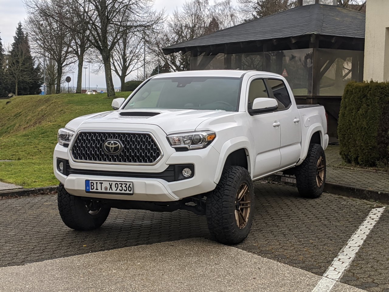

    Thank you. If your really interested in them Venomrex runs sales pretty frequently. I bought the on black Friday, buy 3 get 1 free. The finish and fitment is amazing.
    Here's the truck on new suspension, and 285/70r17 Grabber X3's. IMG_20200307_160823.jpg IMG_20200307_160735.jpg IMG_20200307_160823.jpg IMG_20200307_160823.jpg IMG_20200307_160735.jpg

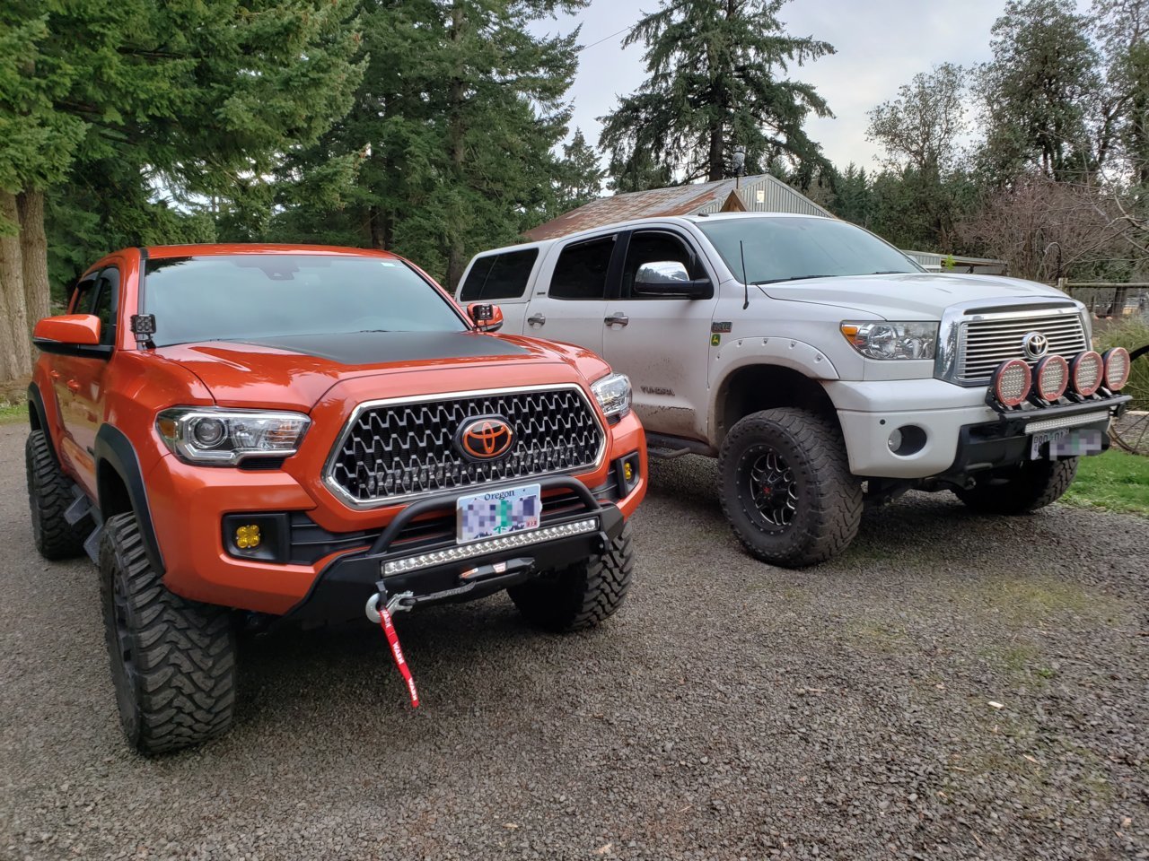

    This isn't what happens because it's a spacer lift it's what happens when you have a spacer lift and no extended bump stops. This guy obviously came down super hard and blew out not only his shock but also the top mount. I have a 6" spacer lift with the diff drop and bump extensions on my Tundra and I've never had a problem. I have King 2.5's on my Tacoma but that's whole other discussion and a whole other ride 20190111_151355.jpg
