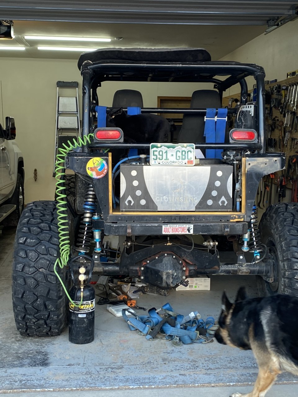

    Other topics we should argue about on TW:
    -Russian vs American ballet dancers.
    -Tighty whities vs boxers vs free balling.
    -Batman vs Superman.
    -King vs Fox shocks.
    -Cats vs Dogs.
    -Whiskey vs whisky.
    -Craft beer vs domestic piss.
    Power tanks are for lazy people. I like the foot pump idea.

    Randy
    West Valley, AZ
    2017 4Runner
    That is the most adorable Powertank I have ever seen.
