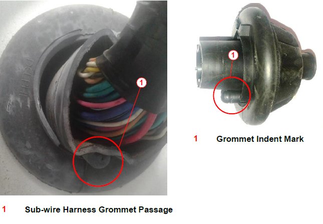

    The boot most poke n cut has a nipple below that is meant to be used for added access of wire(s). Most don't even look for it. They just duplicate what someone else did and say it's the best.

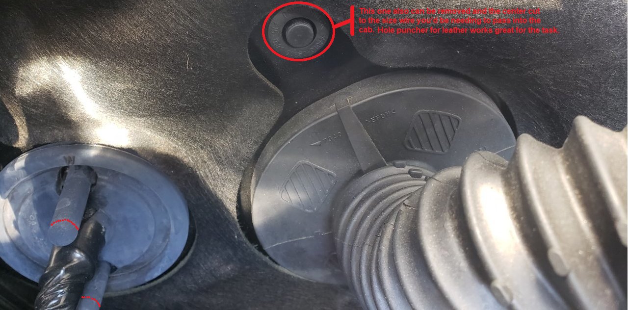

    Everyone uses the stupid main firewall boot when using the 3/4” grommet that is replaceable should you remove the accessory, up near the brake booster, is way fricken easier. Pop it out, poke a hole thru the carpet layer behind it, cut a hole in grommet for wire, run wire through, done.

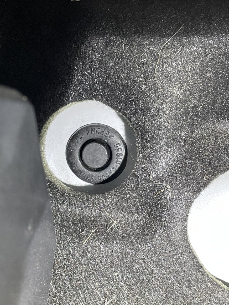

    The OEM cover won't completely shut, but I was able to get two of the three latches to shut.
  13. Mar 23, 2021 at 3:25 PM
    #33
    Diesel156
    Diesel156 Well-Known Member
    Feb 5, 2021
    #355166
    104

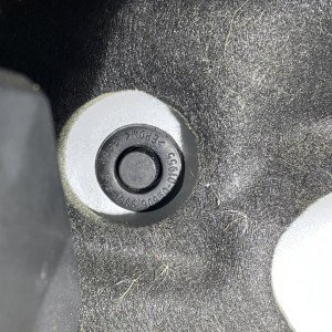

    Found this grommet above the big grommet with the harness. Looks like part number 90950-01955
  14. Mar 23, 2021 at 3:26 PM
    #34
    piff
    piff Well-Known Member
    Oct 4, 2019
    #307042
    463
    Minnesota
    2019 Quicksand Tacoma TRD OR DCLB AT
    Bone stock baby
    i poked a hole through that for a front camera install.

    There is also one behind the master cylinder. It's a bit easier to get to in the TRD OR since there is not a booster in the way.
    It is how I ran the cable for My Genesis off-road G screen

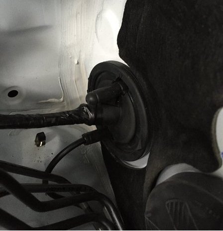

    @JdevTac Will this work on an '07?
    I'm running 2 10ga wires to rear of the bed - passenger side - to wire up a 12v outlet.
  20. Mar 29, 2021 at 4:56 PM
    #40
    JdevTac
    JdevTac Well-Known Member
    Jan 8, 2012
    #70234
    6,332
    Josh
    MD/GA
    2nd gen
    It should. You’d see the grommet right next to the brake booster. The photo below is not mine and is from a 4Runner but the grommet is in the same spot as you see there next to the booster (left hand corner of photo with black large wire). Only issue might be if you have the vacuum booster. If that is the case there is an identical 3/4” grommet on the passenger side firewall. Process is same. Remove grommet, punch hole carefully thru carpet directly behind, run wires through a slit or hole cut in the 3/4” grommet, snake wires into cab, fit grommet back in place.
