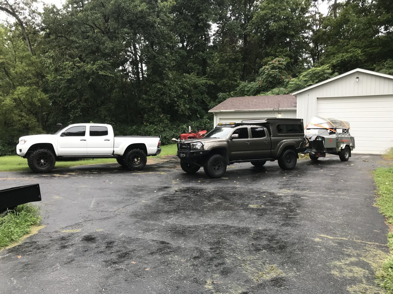

    I run beadlock wheels on my Ford because I debeaded a tire running it a 9PSI. I don't run them on the road because I don't want to wear out my comp cut Boggers. I drive on highway tires to the mud, swap them out when I get there and then change back to the highway tires at the end of the day. Here's pics of my truck.
