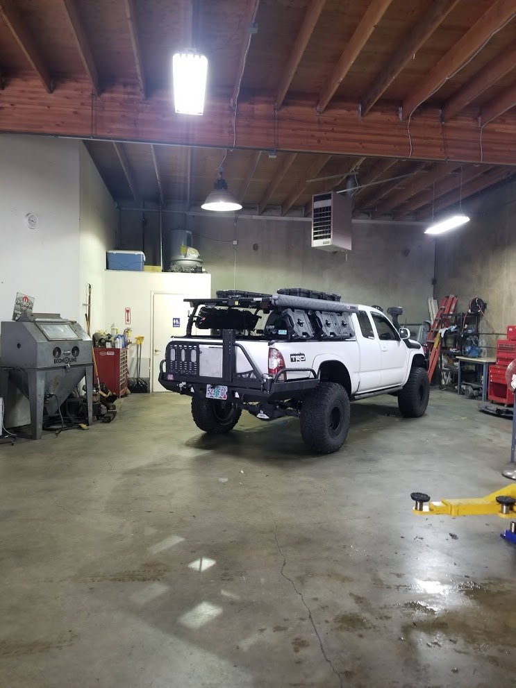

    I hope so as it would make things allot easier when I switch to 37” Pit Bull Rockers like the ones mounted on the white Tacoma in that picture.

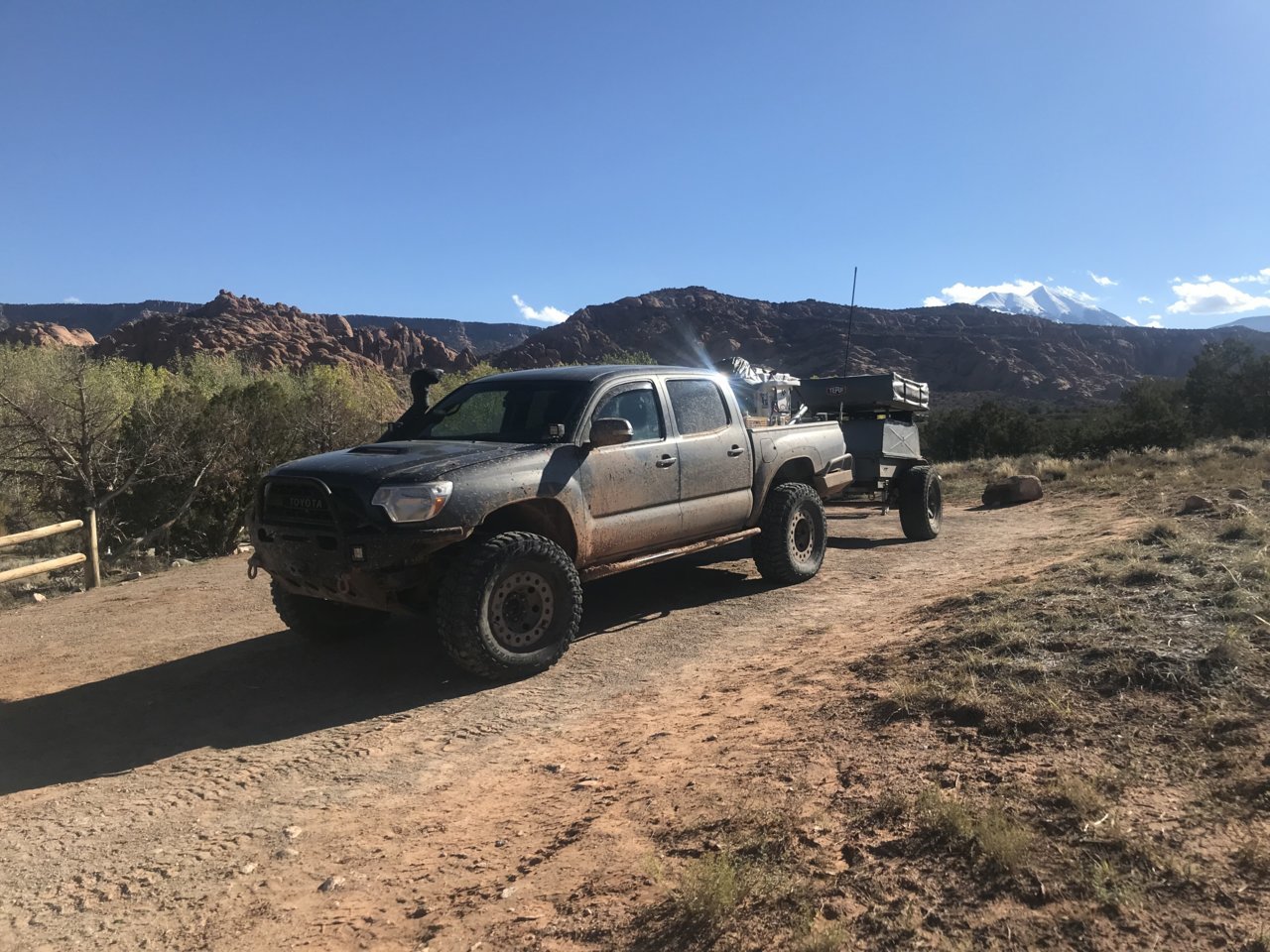

    i run them, they dont balance well with normal methods but work great with beads. I check the bolts every 3k when i rotate and they dont leak air as some mentioned.
    They are the only wheel i have so i cant really switch them out....they are heavy and suck fuel to turn. They are there when i need them tho and have ran them for most of the trucks life

    Are those weld ons? I’ve been looking at TMIs weld on kits. I just received the notification that my 37s were delivered.
    I’m leaning towards getting some Pro Co series 97 wheels and welding Beadlocks to them.
    https://youtu.be/Fstd_hA7E2Q
    Same process as the rock rings I put on my current wheels
