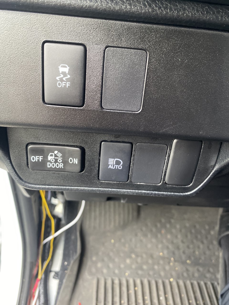

    Does your 2020 SR5 have the Cargo Lamp switch?
  4. Feb 13, 2021 at 10:49 AM
    #24
    Prime1017
    Prime1017 [OP] Member
    Feb 7, 2021
    #355370
    16
    2020 Toyota Tacoma SR5
    Yes it does.

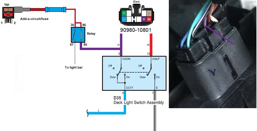

    Excellent! If you like, contact @kmorgan3 and purchase a custom harness that includes the purple wire branch or T-tap it.
    And do this:
    https://www.summitracing.com/parts/dnp-567-0004
    Add a fuse to an always "hot" circuit. Use the Dome fuse.

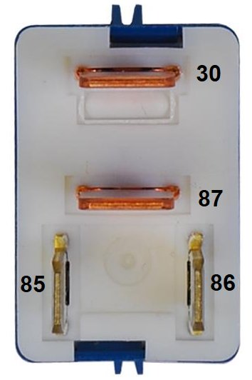

    Add the relay to the add-a-fuse.
    Wire coming from the add a fuse pins 30 & 86 of the relay.
    Pin 87 to the light bar white wire.
    Pin 85 to the purple wire on the D35 Cargo Lamp connector.
    P.S. Remove the vehicle battery negative terminal BEFORE you work on those wires.

    Yeah that’d be easy. I even have spare relays and fuse taps. Only thing going through the firewall would be the wire to the accessory.

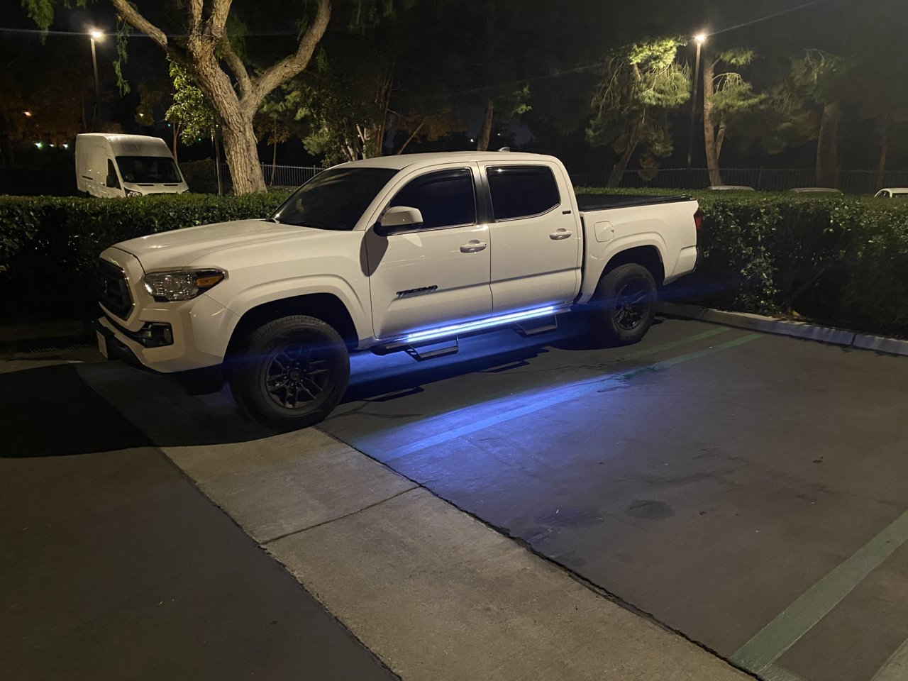

    was able to get the wiring finished up with the custom wire harness thanks to @kmorgan3.
    The wiring harness was a bridge from the cargo light, the “DOME” fuse and the led itself.
    turn signals were tapped into the blue and yellow wire as advised.
    the red wire used an add a fuse to the “TAIL” fuse
    The courtesy light was wired to the custom harness which plugged into the cargo light, from there an add a fuse was connected to the “DOME” fuse.
    grounded to a factory bolt.
    Once again, big thanks to @caribe makaira and @kmorgan3 for helping me figure this out. The lights work perfectly as advertised.
