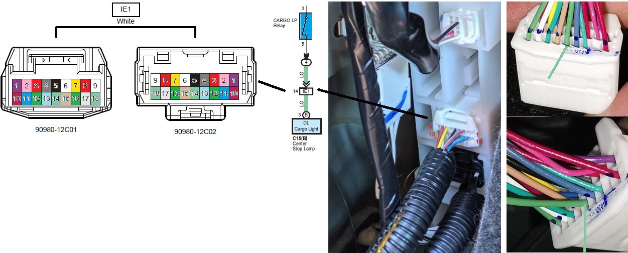

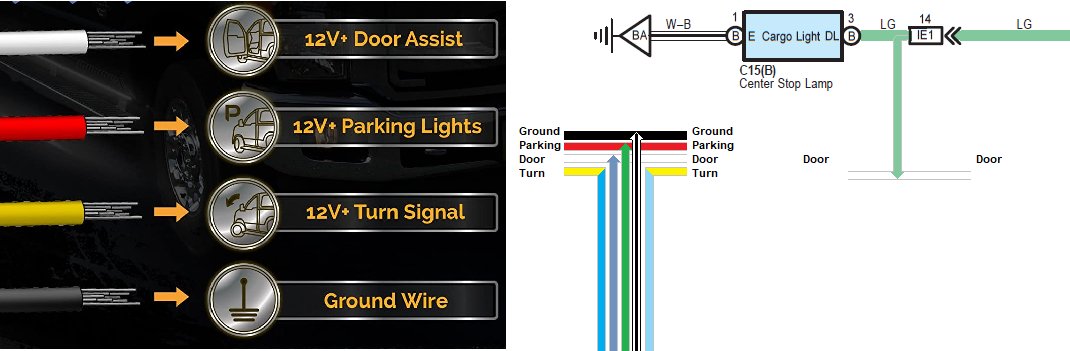

    Because the light was wired to the cargo light,
    If I was parked, but my headlights are on, my amber running lights would be on. If I turn on my truck bed (cargo) light, the running board lights will turn white. This is with the door closed.
    So the cargo switch can manually turn on the white light but not the amber.
  12. Dec 1, 2021 at 11:22 AM
    #52
    caribe makaira
    caribe makaira Well-Known Member
    Feb 13, 2011
    #51121
    11,788
    Caribbean, Puerto Rico
    05 PreRunner TRD Offroad AutoTrans
    Hood Struts, My version Fogs always ON, Map & Overhead Light Mod,
    Change the tap from the Cargo Switch connector's blue wire to the Cargo Lamp IE1 connector pin 14 (lime green) that way you'll get amber or white with Cargo Lamp switch position.

    Thank you, but I think it’s ok the way it is. the only thing I would want to add, is a way to turn off the running board lights completely while driving at night, let’s say I was cruising down the highway at 90mph, no doubt the cops will trace exactly where my bright amber lights are.
    My idea was some how add a rocker switch to the ground? Not sure ahaha just an idea.
    thanks for the help, glad others also think it’s a good idea for courtesy/ running board lights.

    Switch to ground = all off.
    Switch to Parking tap = Amber OFF.
