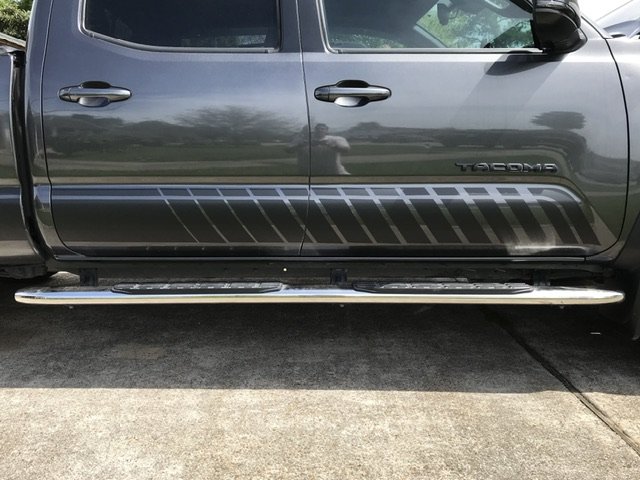

    There isn't one. This board was made for the 2nd gen but will fit our 3rd gen. If you like it buy it.

    They will fit the 3rd gen even if the part# is for the 2nd gen. I have a 2018 TRD and bought the ones you are referring but ended up selling them for a different ones.

    Thank you! I had a feeling the bolt pattern was the same but wanted to check with the experts here first.

    Yes. Bolt pattern for running boards/nerfs are the same.

    But make sure the cab/bed config match up. i.e. Only 2nd Gen DCSB will fit 3rd Gen DCSB

    Don't forget that LB are different than SB (obvs longer).

    Just an update incase anyone else finds this thread ...works fine on long bed.

    DCSB will fit DCLB, it just turns at the end of cab. DCLB won’t fit DCSB, as it has the longer tail to fill the extra space before the wheel. It will instead interfere due to the bed/wheel difference. AC is different altogether is my understanding.

    I bolted those exact running boards on my 3rd Gen after taking them off my 2nd Gen. DCLB

    Those are the SB, I can see by the hardware locations. I have the SB on my LB.

    I was able to get them installed fine. Threw me for a loop as i didn't realize the mounting posts adjusted L/R as they were not initially matching up with holes. After i figured out and adjusted they matched fine. My previous ones didnt adjust so was a little different. These look so much better even though its the abs or whatever plastic. I dont need sliders.
