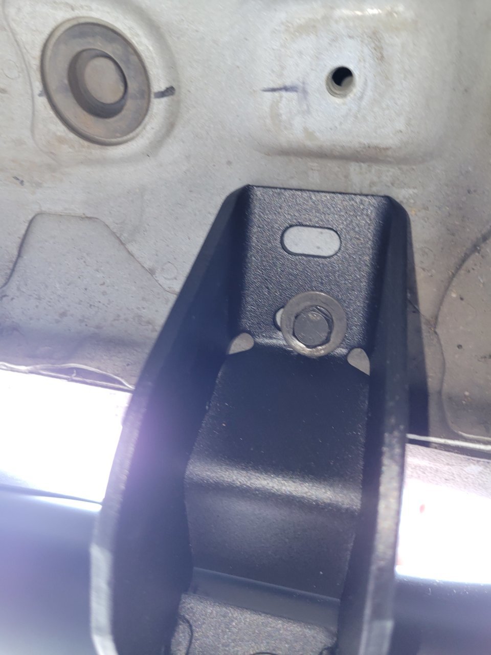

    Question for those who installed the 767-35112 on a 3rd gen DCSB, did all 6 bolts line up on the drivers side? On mine, the front bracket is 2-3" short to reach the upper hole on the rocker so the the bolt is in the top step brkt hole but in the bottom thread hole on the rocker. Hope I explained that right. I saw a Utube vid of someone with a similar issue but was with Rough Country steps but nothing on these. My passenger side fit perfect. I redid the drivers side twice but there's just no way!

    Pittsburgh, PA
    2019 Tacoma TRD Off Road Premium Cavalry Blue
    A few.
    With a set of the toyota oem running boards I had to elongate one of the holes on the front running board bracket to get it to line up with the mounting hole under the cab

    Thank-you for your feedback, at least now I know it's not just me. I was thinking maybe the board was warped.
    You made 1 hole bigger but still could use both boots?

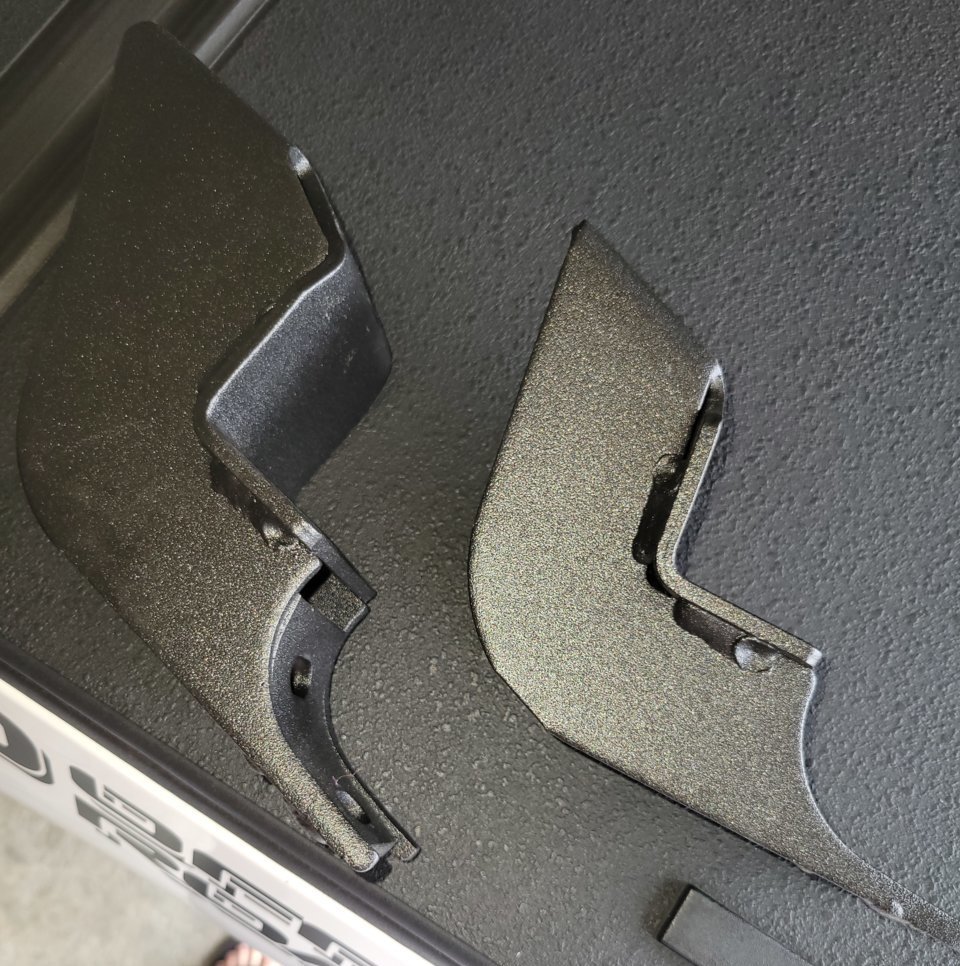

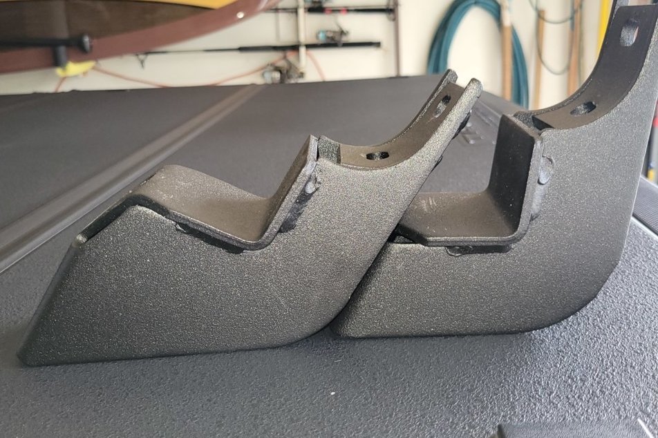

    So I figured it out, the front brackets are slightly different from the middle and rears. Sadly my box came with 5 of the same and 1 just front.
    Gotta research to see if I can find just a front bracket. Going to swap the driver and passenger front brkt for now, want the 2 bolts under me, I'm heavier.

    It’s always helpful to find the PDF install instructions. It will show you these differences. If you still need brackets, keep in mind the part number with “HK” at the end designates the hardware kit that corresponds with the steps. Below is an example

    Thank-you for the link. The pdf instructions on this model does not show the brackets since they come preattached with loose bolts for adjustments.
    I found the kit, looks like gotta buy all 6 brackets vs just the 1 front. I wish the kit link had individual part numbers, it would help with the search.

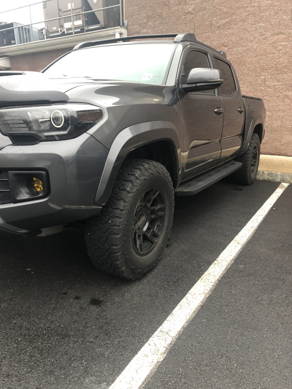

    The curve on that running board goes to the front of the truck? Are they on the wrong side?curve.jpg

    Mine fit perfectly. Are you sure you have them on the correct side? Notice that mine are further back than yours. i.e. mine reach the bed, yours do not. Try switching them.
    Here's a side picture. Notice how the step reaches the bed.
