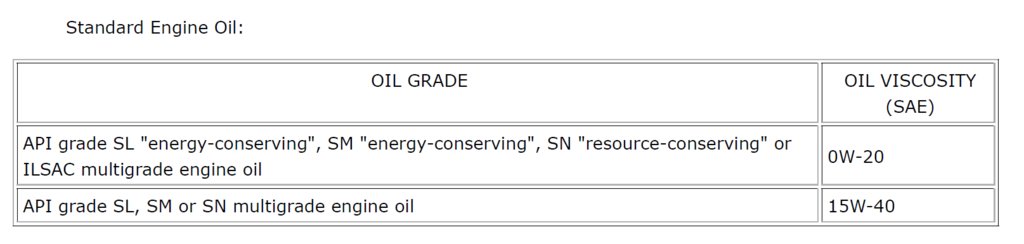

    I found a chart in the widely-circulated 2016 TSM that says that 15W-40 oil is OK in the 2 GR engine.
    Spuds509 likes this.

    The manual says that you can run a higher viscosity oil if you are operating under high load conditions. That tells me that it is ok to run a higher viscosity oil. I run 5w-30.
