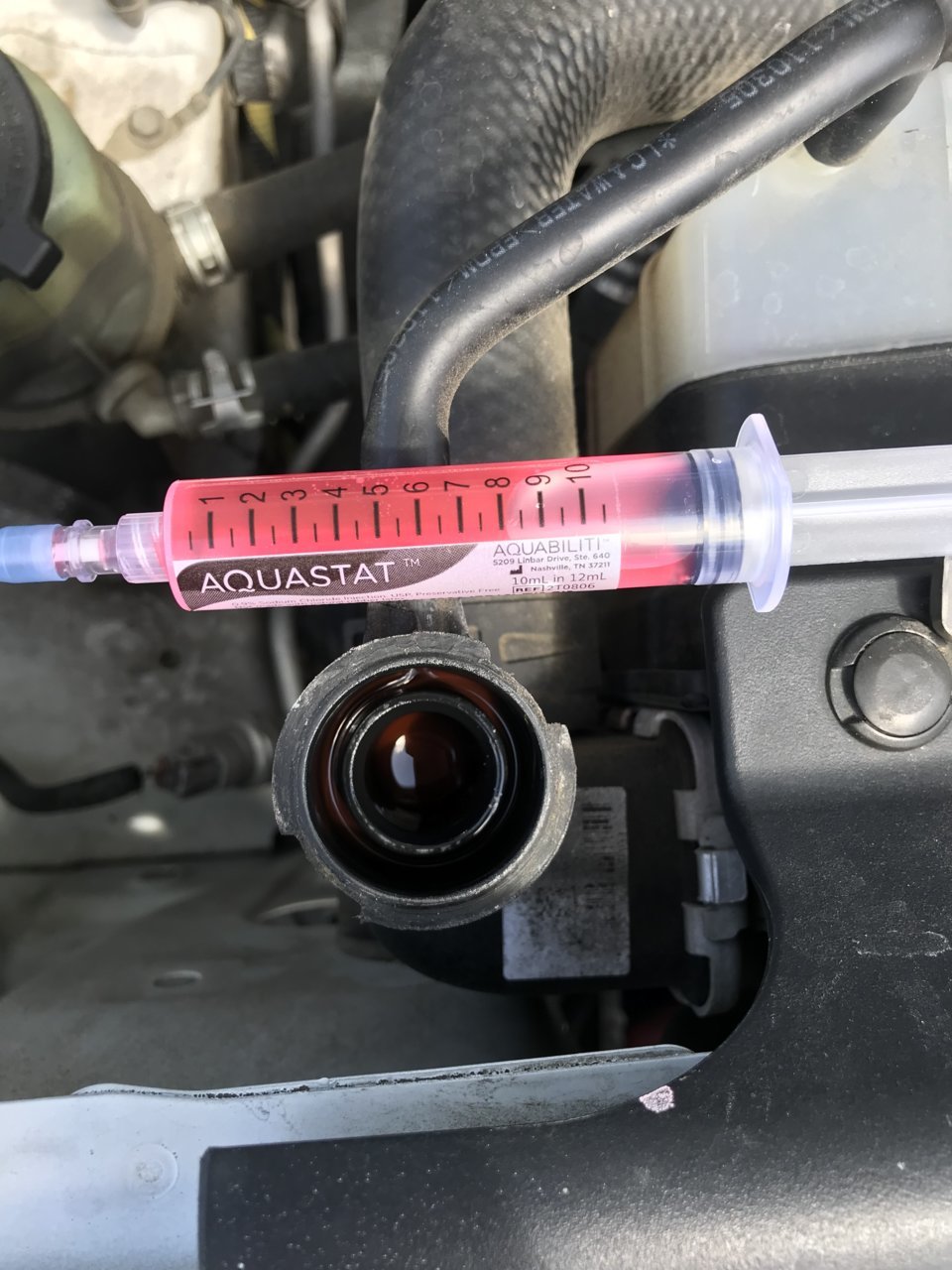

    I bought it with 77k miles, now has 102k. The coolant in the reservoir is bright pink so it may be an optical illusion looking into the radiator. I dipped a paper towel into the radiator and it turned the towel pink, not brown, so I may just be seeing shit that’s not there.
    I’m going to get a syringe and pull some out of the radiator. I’ll post a pic of the color.

    Took a pic of the actual fluid out of the rad. And showing how it looks brown down in the radiator. The fluid is definitely pink and not brown.
