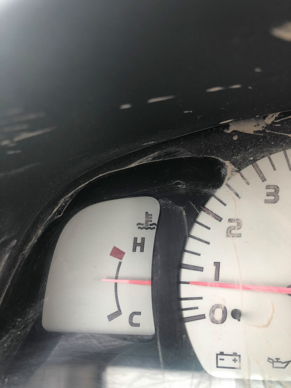

    Hey y'all
    So noticed today that my thermostat was a hair higher than it normally is. I checked the coolant and Im about half full, would that make a difference? I am topping it off once it cools down. Maybe I am paranoid but the gauge is slightly above halfway which is where its always been. Any ideas or reasons to worry? Thanks!

    Looks normal?
    And by "half full" you mean the tank was half full? cause its not supposed to be full

    It's been said on here before. That's an idiot gauge. Once it gets near / at / above H, it's too late.
    From the tachometer and white background on the gauges, it looks like you have a 2001-2004 Tacoma SR5...
    Do yourself a favor and buy a Scangauge, Ultragauge, or WiFi/Bluetooth OBD II reader and use it with a phone app to get an actual temperature reading on the coolant.
    If you have an automatic transmission, you can also program that in and see the temperature of the transmission fluid.

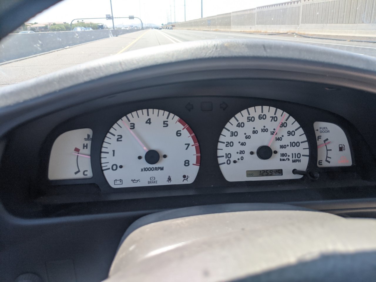

    Does the needle on the gauge normally sit a little above the middle mark like that? I know some people claim that there's does, mine has always sat dead center.
    Any way about it though, you won't know if you're actually running hot or not unless you get an accurate temp reading. Pick up an OBDII plugin off Amazon for a few bucks and download the Torque app on your phone, you can read your coolant temp along with a lot of other good info.
    I've gotten my truck up to about 208˚ pulling up long highway grades with a lot of weight in the back, and the dash gauge stays dead center. So when it starts to climb you are already getting into dangerously hot territory well before it hits the red mark.

    That temp is dead spot on it is not hot it's normal Red is not pull over and let it cool off other than that drive home.

    Nah but seriously my gauge used to be dead center but after hg, head, and ECT sensor change my gauge sits where urs is so I wouldn't worry as mentioned.
