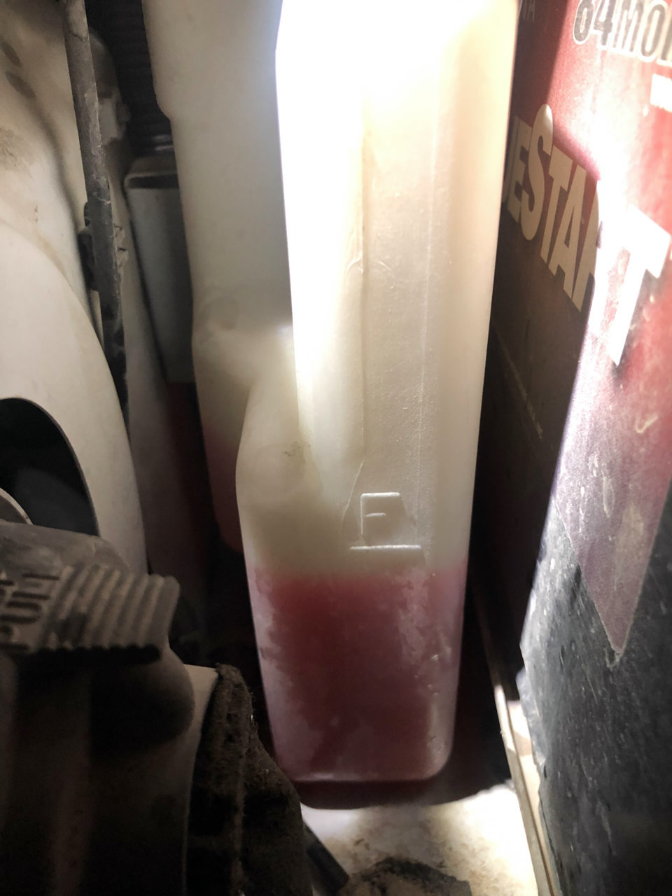

    sorry my terminology maybe is incorrect. here is what I am calling the reservoir.. I drove maybe 30 minutes ago and it looks fuller than when I checked this am and said it was half full

    The coolant reservoir level will go up and down depending on engine temp. But you want to make sure it doesn't get below the low mark. If it's consistently getting lower and lower then you either have a leak or coolant is going somewhere it should'nt be.
    We need to know exactly what your coolant temp is though before knowing whether or not you actually have an overheating issue, or if you're gauge just displays the normal temp a little above the middle mark. Some people on here have said that theirs sits a little over the middle normally. It's just not good to go off the dash gauge for that kind of info, you want a scanner so you can know for sure.

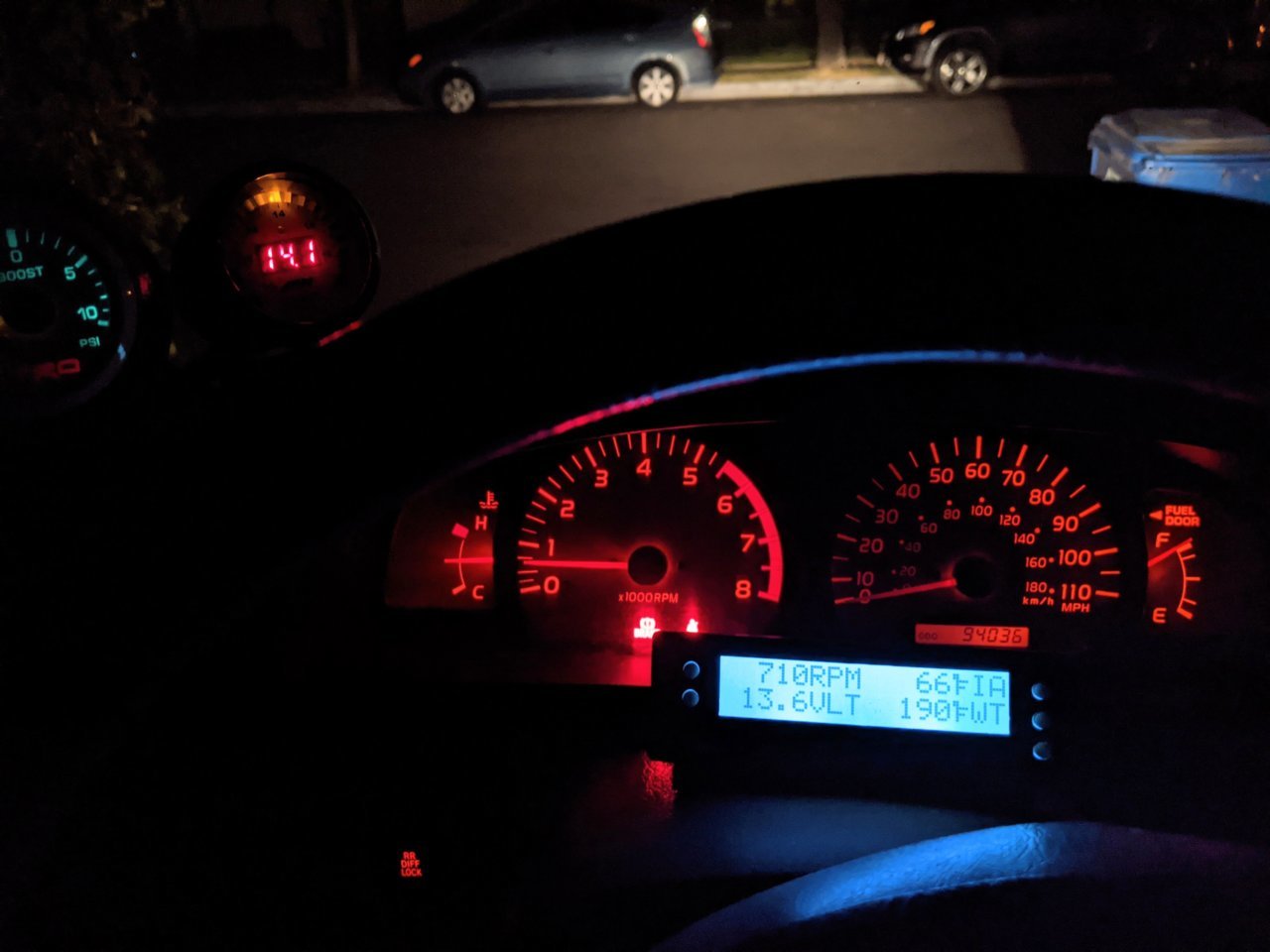

    OBDII will tell you a ton of info, way more than what you'll get from just your dash gauges.
    Here's a pic of my scangauge mounted above my wheel, I have it set currently to display exact RPM, intake air temperature, battery voltage and coolant temperature.
    You can have it set to read a hundred different things, including ignition timing, long and short term fuel trims, gas mileage, auto transmission temp (01-04 models), MAF sensor reading, etc.

    I keep the backlight turned at the lowest setting at night, just turned it up for the photo so he could see it. Driving with it at full brightness like that at night would be a huge distraction, I agree. But it's not any more distracting than the normal gauges when you turn it all the way down.
