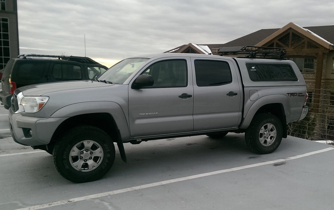

    OME 2.5 886 Dakkar suspension, ARE shell, with Thule bars and cargo rack,
    I'll post pics in a bit. I just did the 886 on my 2015 DCSB last fall and the lift is 2.5" in the front and 2.25" in the back. Note - the back has an ARE shell and cargo rack - probably the reason for the difference. I'm putting sliders and a lightweight low profile bumper/winch on the front but even without those the stiffness doesn't bother me. This may be because I drive a 2015 Chevvy 2500 at work with a ridiculously stiff suspension.

    Note - prior to OME 886 lift I upsized tires to the largest one could go to without rubbing 265-75-R16. I am not convinced I need to go bigger and I have other items on the build list such as rock sliders to put on first. Obviously bigger wheels and tires will now fit.

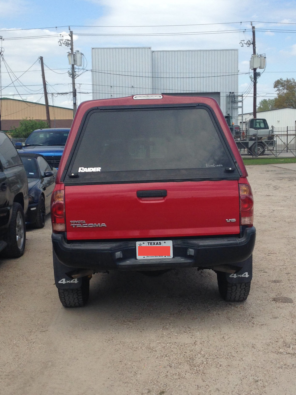

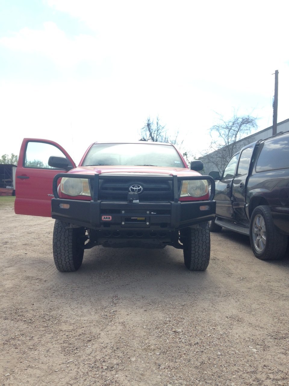

    Got the lift finally on! Rides like a dream! For the access cab guys wondering about OME 887s? they are perfect in my opinion, got around 2.5inch of lift in front and rear (from Dakars).
