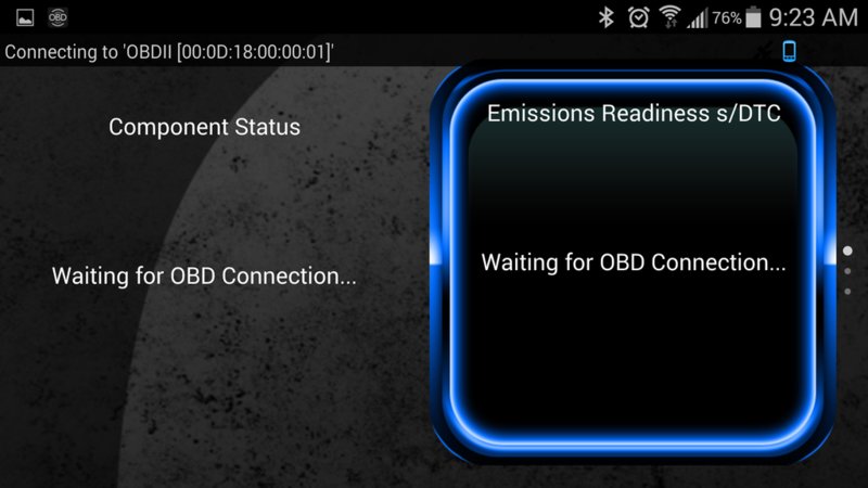

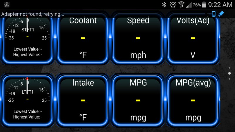

    One thing I noticed that wasn't really mentioned is the brake booster being bad. While parked, rev the engine and keep note it's performance. Afterwards, turn the truck off, remove the booster hose at the intake, plug it with something that wont let any air pass in like a rubber cork, turn on and see if you get better performance. If it's old enough, the diaphragm inside will have a small crack and will let air pass through causing your system to THINK it's running rich.
    Keep in mind, your computer may show it's running rich, but that's assuming the air coming through the MAF is the only air coming in. If there is a leak, then there's unmetered air coming in from somewhere causing the reading. Try listening for a hissing/sucking sound in the engine compartment. Mainly around all the intake and vacuum tubing or large units like the booster. Another option would be to spray butane or soapy water along all of the tubes. Butane will get sucked in and either improve or worsen the performance. Soapy water will bubble at cracks.
    If you have a 96 or newer, I recommend getting an ELM327 (bluetooth) and the Torque app. its like 10 dollars in total and provides valuable information regarding the performance of your vehicle. it's not shop/dealer grade, but it's pretty damn close if you know what to look for. Study long term and short term fuel trim.
