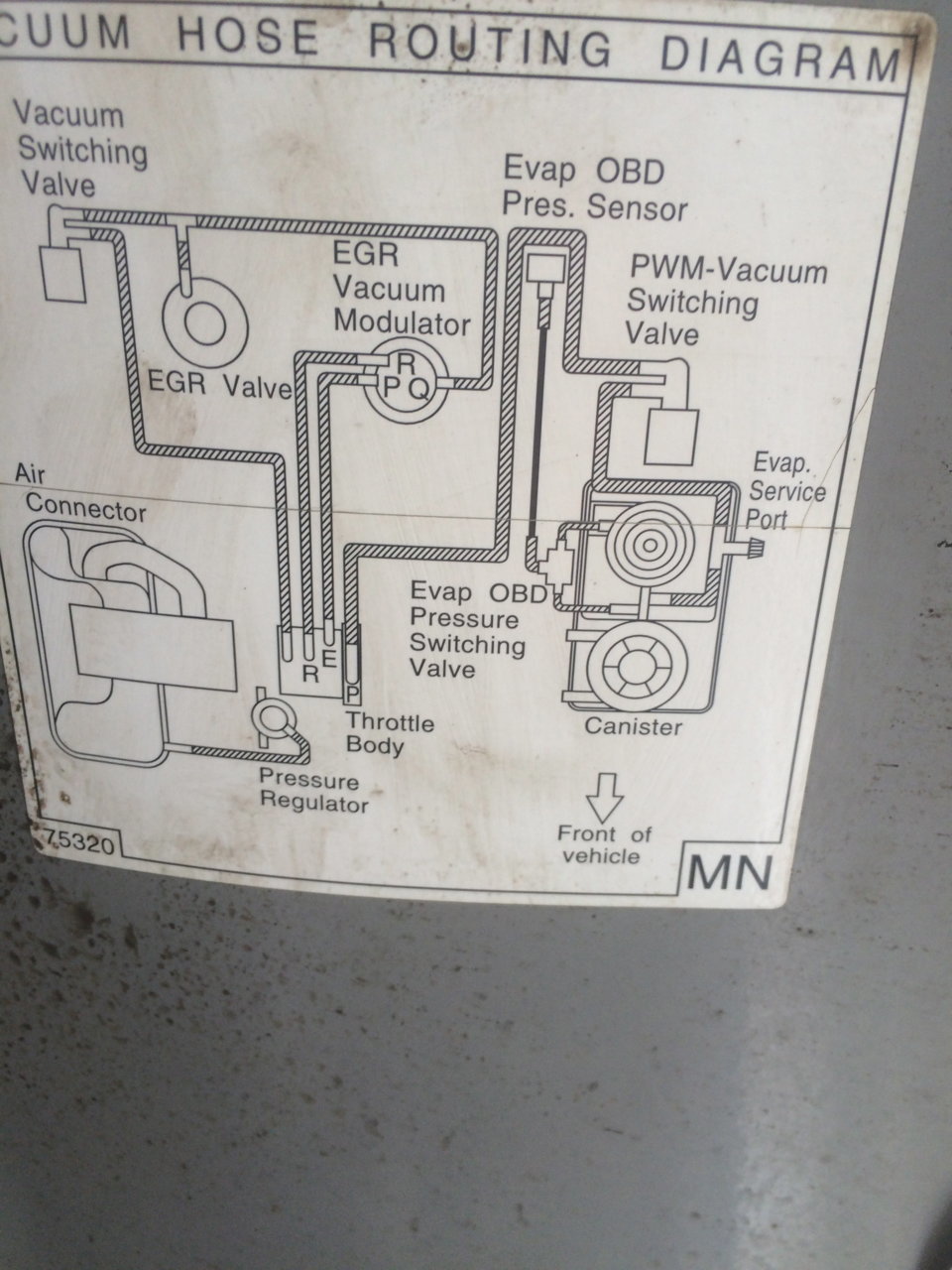

    interesting that they indicate that line the same as they do all other vacuum lines on the diagram under the hood

    Sorry been supper busy. There should be some info some where on the site. Search may bring it up. Try driving i with the vacuum line off the egr and also you can remove egr and check for carbon holding it open. Also could have an evap system causing richness. Post a pick of you vacuum diagram and i'll show you which line to plug and test drive.

    been very busy myself. so what i did was pulled the vacuum line off of the EGR and applied vacuum (by mouth) and could hear the valve opening and closing.
    here is a pic of the diagram:
