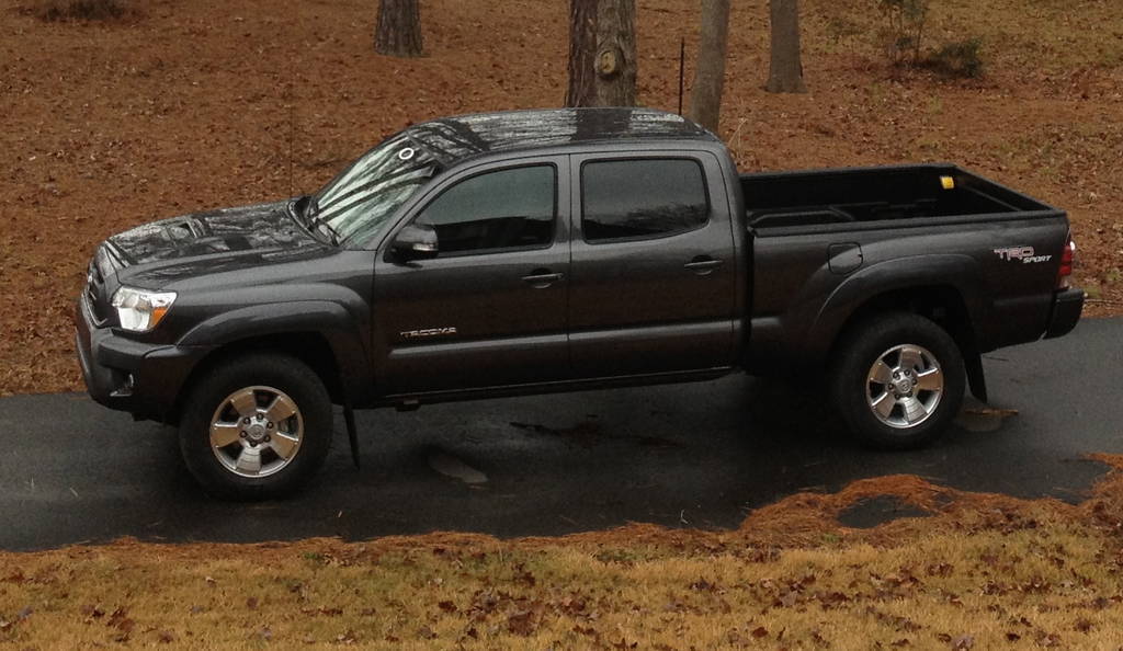

    Completely Stock:

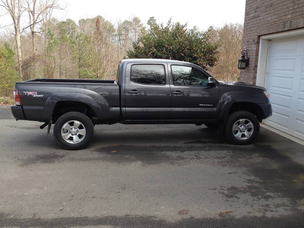

    Everything Stock + Ready Lift SST 3" lift:

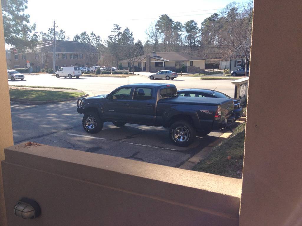

    Ready Lift SST 3" Lift + 265/70R17 Cooper AT3 + UnderCover Tonneau + ARB:
