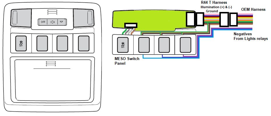

    Hey guys, thinking of running the Meso customs added 3 switch panel in my 2018 trd sports above head console. This will be used for ditch lights, light bar, and rear trail/setup lights.
    are there any good resources on how to run the wiring to the console? I’ve seen on YouTube how to remove it. But not much on how to get the wiring up there. My panel to the left of the steering wheel is already spoken for for the compressor and front/rear lockers. So I’m curious what you all know or have done in the above head.

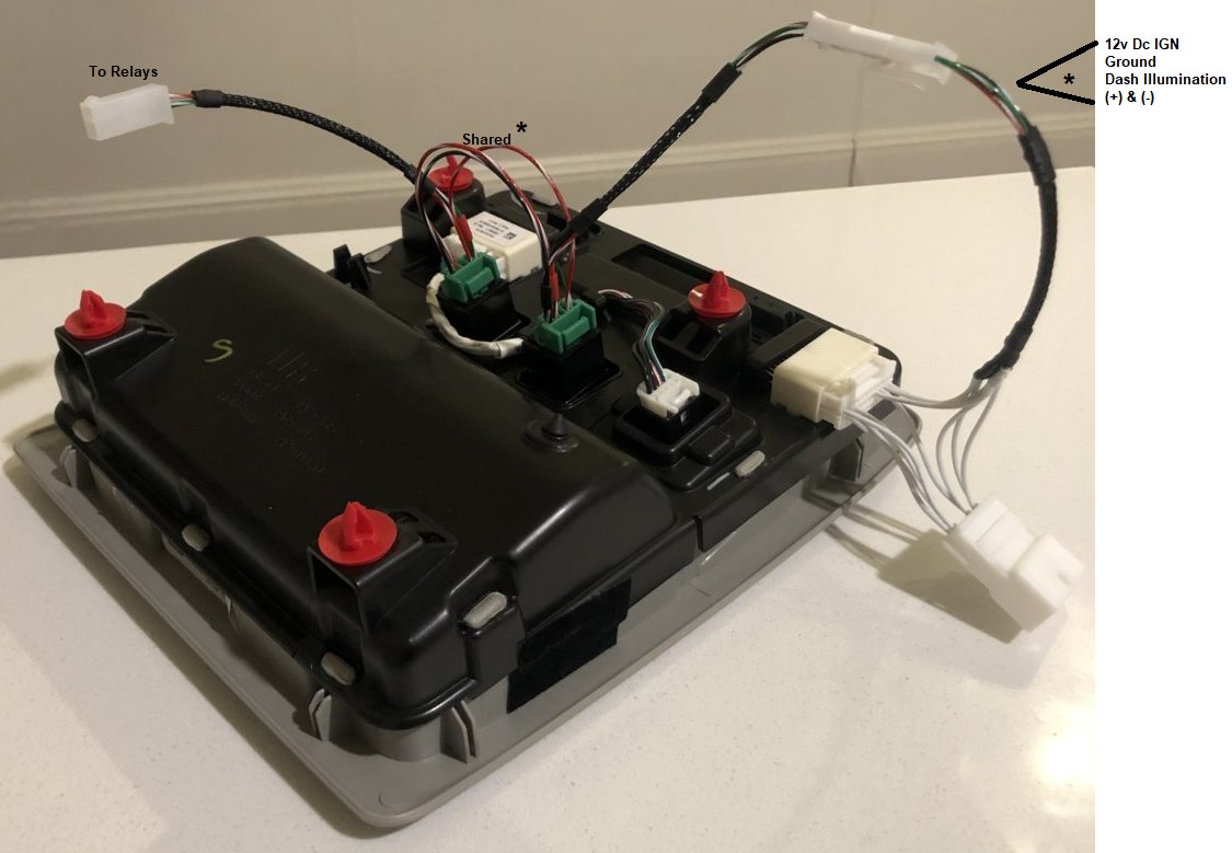

    Its super easy to run, first thing you will want to do is make your harness. For this you will want to take your panel, put in your switches, then wire all the switches. They can all share the same common ground, the same illumination wires, and the same power wire, then you just need to run a single wire for each trigger on the switches.
    Once you have made the harness, remove the A pillar trim (10mm bolt behind srs cover) then just pull it off. You can run the wires from the overhead console, under the headliner (you can just tuck it by the windshield) then down the pillar and then it will fit into a hole in side of the dash and to your feet area.
    Here is the harness that I made for mine. You can see the common power, common ground, and common illumination. Then the blue wires are the triggers that go to each of my lights. Triggers are loomed in a different wire loom than power/ground/illumination so that I could run the triggers to a different place than the power wires.
