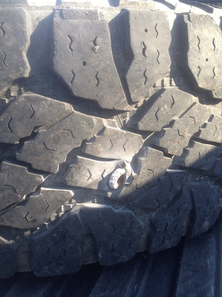

    I hope it can be patched 3669fc9c39409ded31727fe2d2420232_841aae3d1af138d2f8435f31230c34db28427ab1.jpg

    Plug and patch and you'll be good.

    Should I pull it out before taking it to the tire shop?

    No

    Ok. I'm just hoping the plug patch will fix it
    It's big o tires and I know anywhere near the sidewall is usually turned away. To me, although on top of tire this looks pretty bad.

    Only way they won't repair that is if it is only part of an extremely larger eye bolt or whatever it is. As long as it's a single hole puncture you should be fine.
    If it is a much longer or larger chunk below and it tore some belts or separated multiple plies in the footprint they might refuse repair.
    Looks relatively harmless from the picture though, but I've seen them look like that and then when pulling it out it turns into something unexpected.

    ^X2. Looks patchable. Looks like the tread block took the brunt of the damage.
