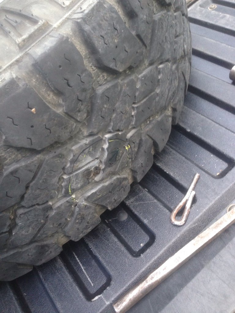

    Wouldn't be a big deal. Just like driving around in a circle a bunch of times.
    Next time throw the smaller tire on the front. You can easily correct steering and it won't damage a diff.

    Plug it and carry on. Always keep a plug kit in the truck with you.

    Spend the money and get a matching spare! You won't have to worry after that. :thumbsup:

    We digress. You'll be fine but get it plugged soon. I plugged a BFG AT with 800 miles on it and it lasted until 60k and I decided to up a size. I wore that tire down to almost the wear indicator with no issues.

    While plug kits and a compressor are good ides, I'd much rather have a good spare, jack and lug wrench even if the spare was 2" smaller than the remaining 3.
    Plugs will only repair a small amount of punctures, most of which are slower leaks and often times drove on far too long when low or flat. Plugs are great for trail use, but on highways one doean't always know how long they have driven on a severely deflated tire. That alone can cause serious issues reinflating, let alone driving on again. You'd be amazed the amount of internal damage caused by driving on a flat or nearly flat tire for an extended period of time.
    I've seen tires with a similar look to the OP's only to pull out a 5" eyebolt with 2 3/8" nuts and a couple 1/2" diameter washers on the other side. A plug won't save you there.

    When I was a kid I recall someone saying two different tire sizes would destroy the rear (on a different car)... Some things just stick with you in your thoughts I guess. Nonetheless I pulled it out due to curiosity. Looks like a simple fix. I'm one to replace all four tires if one gets destroyed because you can't have 1 new tire and 3 old with 4wd (so I've been told. So I was concerned about losing $1000db721af2d70497cbe59698f9f7afc146_87d38747058fe0f2fb0c448063790671b7ca5a77.jpg

    It all good bud. Don't go spending a grand for nothing.
