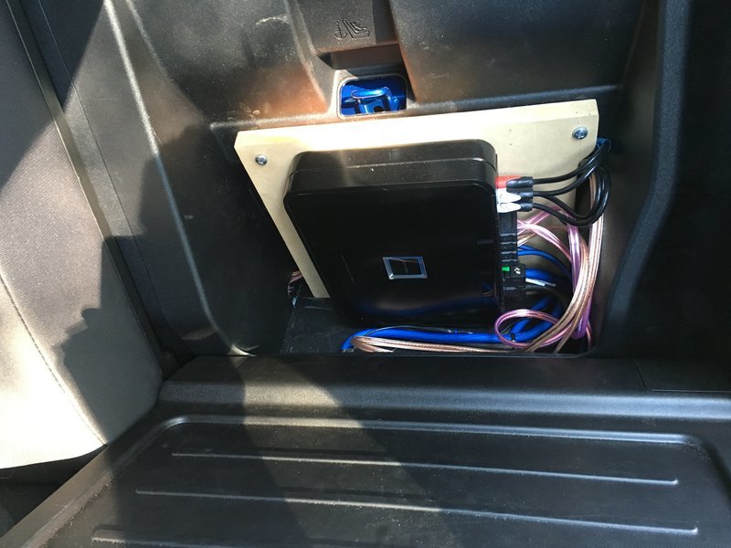

    Second item was to decide on amp mounting location. I tried playing with the amp under the front seats, but it was tight, and I’m worried about the snow and salt coming into the cab during the winter. That and kids in the back kicking with their dirty boots! So, behind the back driver’s side seat it will go. I may go with the LC7i under the back driver’s side seat. I like the look of that setup. The delivery of the LC7i is a bit behind due to the change of mind so I will wait until it arrives to decide.

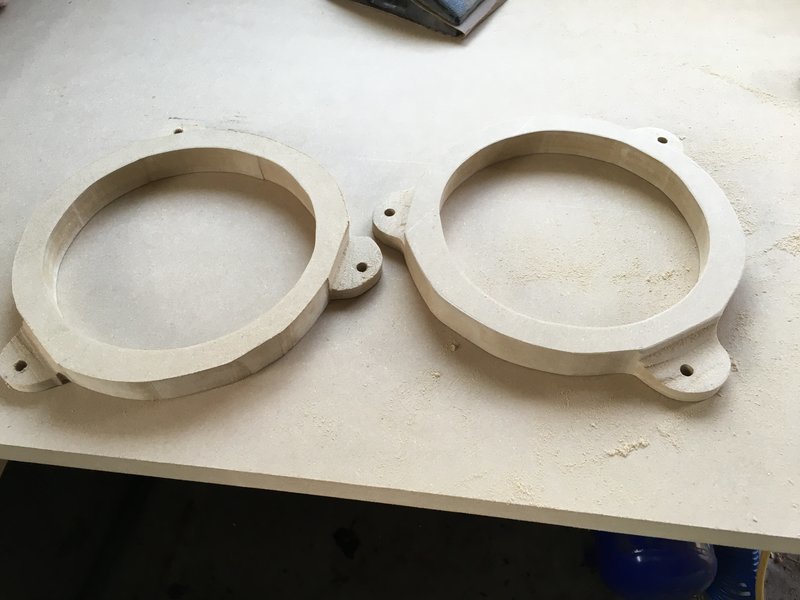

    Next order of business: Rear speaker brackets. I picked up some ¾” MDF and decided to make my own. I got home before everyone else yesterday so I pulled apart my rear passenger side door using the OEMaudioplus video as a guide. No issues. The door was apart in about 15 mins. I pulled out the rear speaker and traced it on the MDF. I compared the Hertz speaker. It is pretty tight! I will end up making the adaptor a larger diameter than the OEM speaker bracket to ensure I have a good mounting surface.
    I spent some time on the adapters when I got home tonight. Here is the finished product.

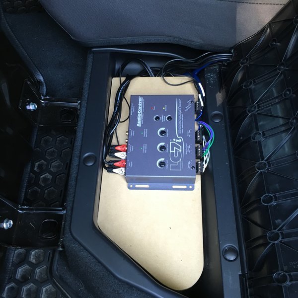

    i found there was plenty of room under the driver and passenger seats, even if there are going to be passengers in the back. I placed the amp and LC7i above the rear foot vents. Still have to make brackets to keep them in place but that will come shortly and they haven't moved around that much in the short time they've been located there.

    I made the mounting boards for the amp and LC7i today. Also got the 4awg power cable from the engine bay to the cab. What a pain that was! Maybe this is where my inexperience shows, or maybe it was because I have a manual but it took me a good 5-6 attempts, 45 mins and two bloody knuckles!

    Make sure you seal the snot out of those MDF adapters before installing them.

    Sounds good. I didn't think about sealing them. Just use paint or is there something else you suggest?

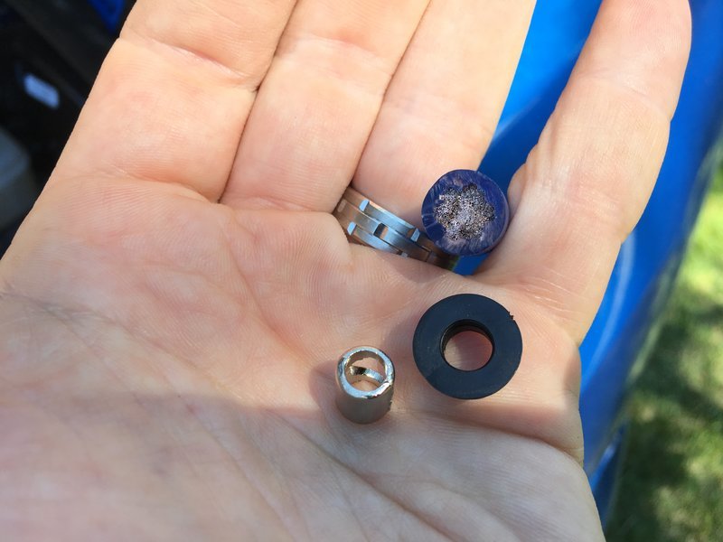

    First struggle. Ant I feel like an idiot. I can't get the damn power cable into the grommet and holder for the fuse block! Seems like I got the wrong size block. Any tips for how to do this? I just keep fraying the hell out of the cable. image.jpg

    Paint might work, but the big story is keeping moisture out. If you don't seal them they will swell and deform. A lot of people have them sprayed with bedliner. I flat out refuse to put MDF in my doors either way & use cutting boards as material for adapters.
    On the grommet, looks like you need a bigger one. Or find another way to seal that up.

    The rear speaker adapters have been painted twice and I will do a clear coat in the morning. I'll keep an eye on them. They are soaking up the paint. I may need to switch out to plastic in the future.

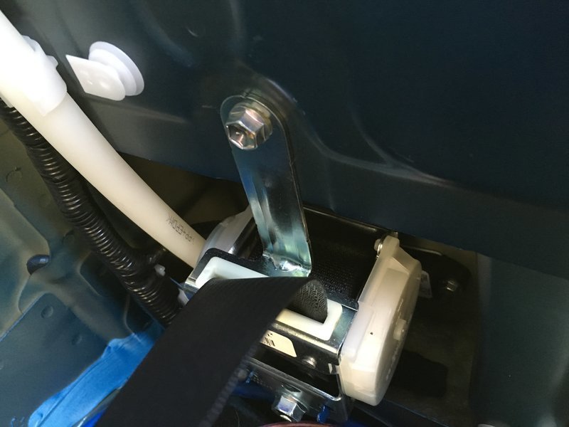

    The truck is going back together! All speakers in and doors back together. I ran the speedwire down the passengers side and tied it into the LC7i. I was getting ready to cut the holes needed to run all the cables into the rear drivers side cargo hold when I ran into a planning issue. Not sure wher to connect the ground! The ring terminal I have is too small for the bolts holding in the seatbelts. There is one bracket on the rear set elf I was thinking of using but there is some wiring too it. Will using this bolt mess anything up?
    I guess the other option is to open up the ring clamp. I've read a good ground is critical so I didn't want to reduce the surface area. Thoughts?
    thanks!

    I may be a bit paranoid, but i've never attached anything to my seat belt mounts. they are engineered to save my life.

    I've opened up the connector to make my ground fit on the seat belt bolts and haven't had any issues.

    Anyways, everything is back together for now. I ended up using the bottom middle panel mounting bolt location on the rear drivers side back panel for a ground location. No issues with noise.

    Other than that, I need to do some more cleanup for my LC7i mounting. I struggled getting the clips off for the under seat storage unit, so I need to revisit that. I also need to get shorter RCA cables and trim some of the wire leading to the amp. Is also like to pretty it all up by carpeting or spraying the amp and LC7i mounts.
