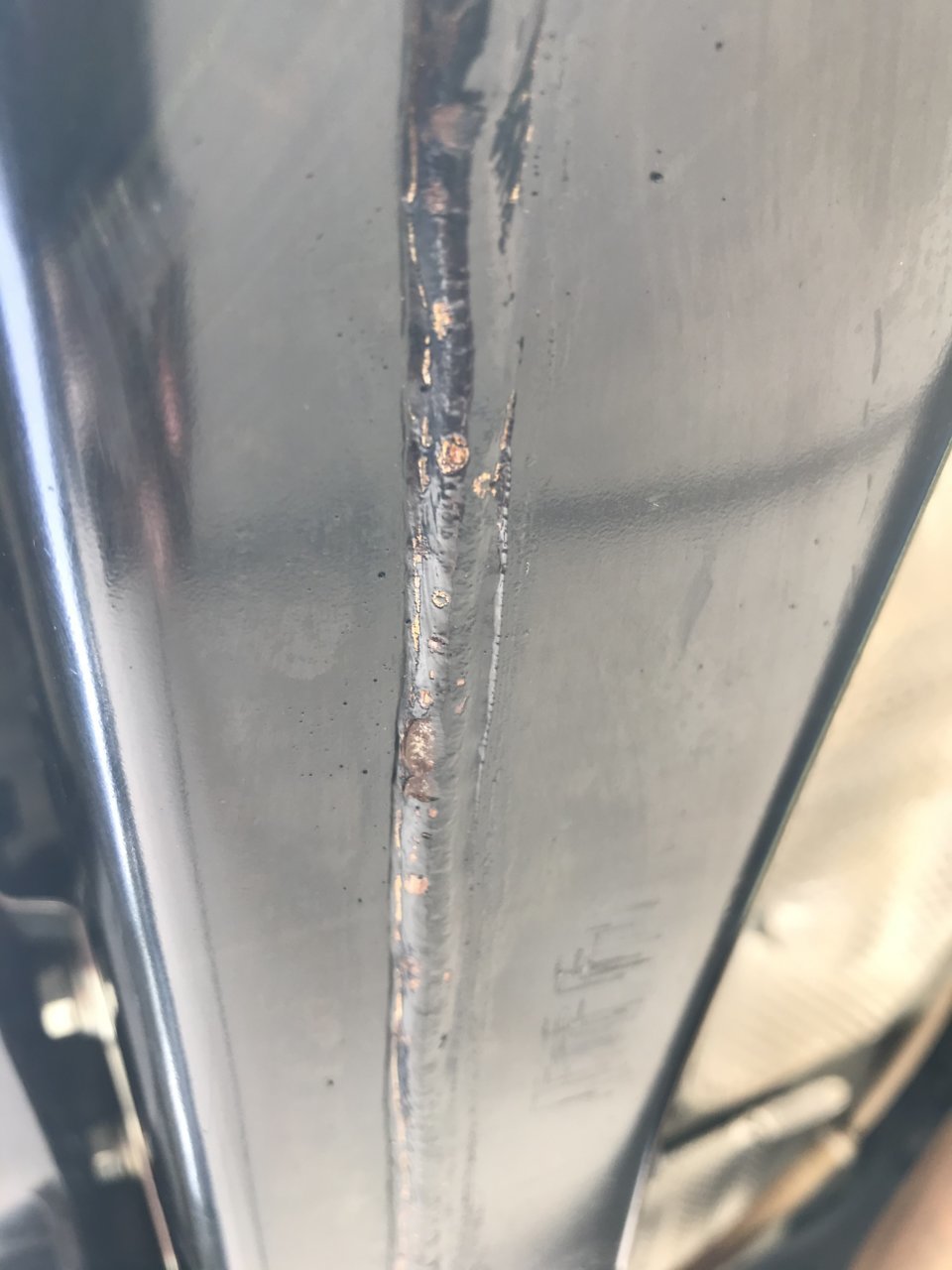

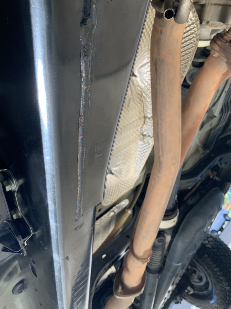

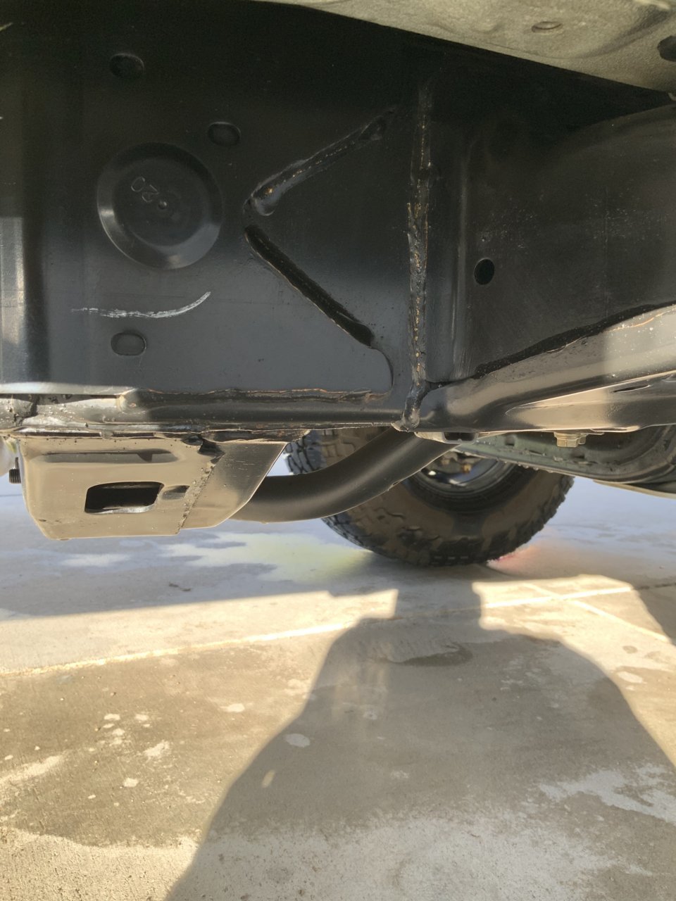

    Does anybody else have rust starting in these locations on there frame?
    I only have 9000 miles on truck, live in California but I do off-road a lot.

    Not sure that's rust. A lot of the welds have a goldish color peeking out.

    ^This right here was addressed by an experienced welder on a previous thread. The jist was certain welding process turn the weld this color which is usually mistaken for rust which it is not. Toyota is one company that uses this process. Just read previous threads on protecting your frame and underbody and you should be fine. I live in the rust belt and go the fluid film route with great success. Good luck

    That's not rust.

    That's the welds. If you're not in a rust belt state I would not worry much unless you drive on the beach.
    Remove any loose paint with a wire brush spray it with some rust-oleum rust reformer then some black paint if you like. The rust reformer will leave a matte black like finish itself. I used to do that to the steel rock rails on my old Jeep but I'd use bed liner in place of paint on them.
