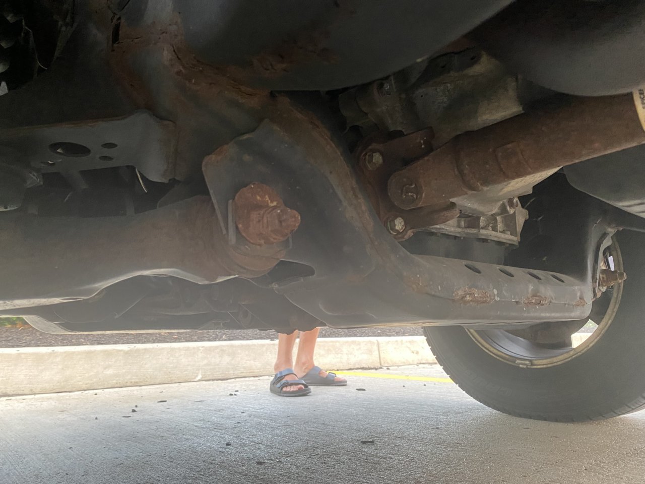

    Wondering if this slight crack and hole in the upper corner will affect pa inspection
    The frame was sprayed and still has resin in it but I wonder if they missed this spot above the a arm…
    look at the upper left corner
    You might need to blow it up
    A shame tge truck drives like new.

    Anymore with how strict they have become with rust it most likely will fail.
    It comes down to how close that shop looks.

    That’s what I was thinking glad I spotted it before putting out thousands on what otherwise was a very nice truck

    did anyone else ever see that rust stress crack and or that whole in their frame here?

    If that is the only spot You should be able to get it fixed so your truck can keep living.
    The liquid brine is rough on every Thing under the Truck.

    2012 should still be covered for a new frame from Toyota.
