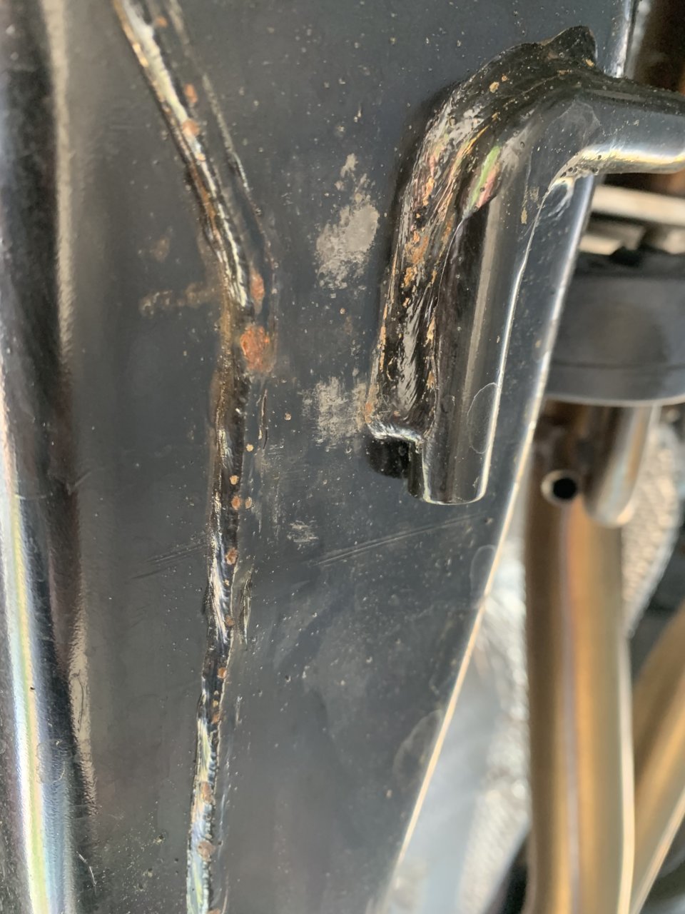

    noticed some rust on my frame on my brand new 19’ Tacoma after only 500 miles... I’ve never owned a new vehicle before and couldn’t tel you if this acceptable or not..
    Thoughts?
    Thanks!

    That's pretty substantial rust imo (live in Colorado so im kinda bias probably)
    I'd still take it back to the dealer.

    Hit it with a wire brush and spray your favorite black paint over it, problem solved.

    looks like something hit it. they may just slap some paint on it

    100% normal and nothing to worry about.

    If you go complain at the Dealer they are simply going to spray paint over it and send you on your way, at least if you do it yourself you can take your time and remove the surface rust before you spray paint over it.

    When your truck traveled on the train and shipped on the trucks they tie it down with chains and the frame gets scraped up, clean and paint it and you are good to go, no warranty issue.

    In Toyota's case for the frame it's basically nothing but a spritz of Krylon in semi gloss while the frame internals are bare metal. We're now two generations into Tacoma frame rust and they still can't fix this problem.
    It's in everyone's best interest to buy a case of 3M cavity wax and the wand kit and have at it.
