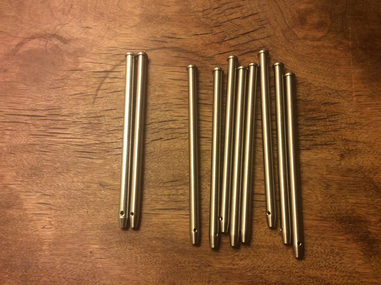

    I have the machine shop running a couple of these off to get an idea of the cost. The material is a basic 304 18/8, cold formed to the main pin diameter. 316 may be a better option. Need to hit up folks in the know to see what the stock pins are likely to be made from.

    Here's a hand full.... They cost more than I thought... titanium would be crazy expensive. I'm going to check and see if mass producing them will get pricing to an acceptable level.

    Good Job, they look awesome!!!
