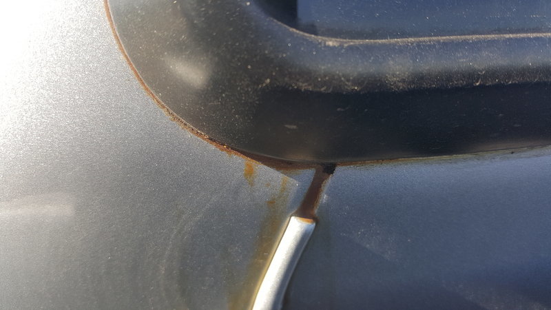

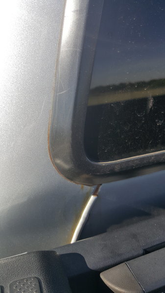

    Anyone getting rust around the rear window under the weather stripping? I reported it to Toyota and they said its not their problem. If you have it post it here, with pictures. I would like to create a case to turn into Toyota because I think this is a design flaw.

    Well, for once I agree with Toyota. I mean it is a 10 year old vehicle.
    If you want do something useful, pull the window, repair the rust properly, reset the glass and enjoy your truck.

    you could cut the glass out which trust me is a real PITA.. especially if its been out before. grind all the rust off prime it with either glass primer or pinchweld primer and reinstall the glass.

    Without seeing the rest of the window I can't from these pictures assume that this is an ISSUE. It actually looks like rusty weeping/ dripping from something above and not the window installation. Are you parking under a rusty tin roof?
    Like others even though you're in Texas metal rusts. Take it to a body shop and have it investigated and repaired.
