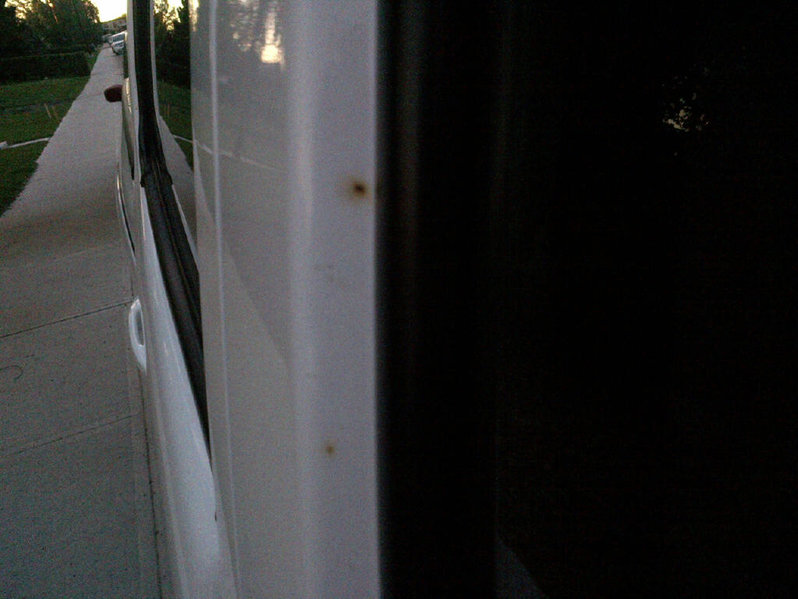

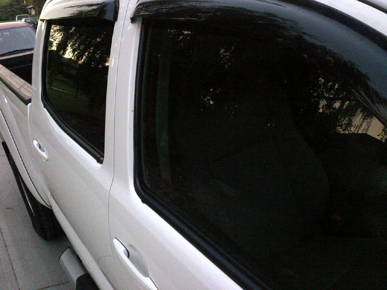

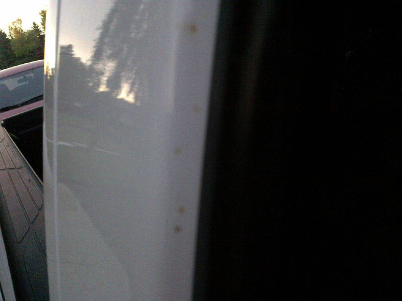

    Hello everyone.
    I drive almost exclusively pavement highways.
    I have almost 60,000kms on my 2010 TRD DBL CAB Tacoma.
    Do any of you have the same rust issues coming through around your windows? There are no rock chips, this looks to me like the rust is coming through from the bottom - on all four windows, see pictures below.

    Thanks for the confirmation I'm not losing my mind. I have regular rock chips in the paint on top of the hood and on the side of the body in a few places (right through to the metal underneath), and those spots have yet to rust. So yeah, this is a bit unique. I bought the dealer's protection package too, so I'll be having an interesting discussion with the dealer.

    Your truck is a 2010..maybe it could be rail dust from when the truck was delivered? Have you tried to compound/claybar them off?

    That looks like tar stains from new asphalt or crack sealing in your area. My dads white F150 has the same little tar stains all over it. You may not notice tiny bits of tar on your paint, and they leave stains over time. Im sure it would come out with a clay bar.
    Seeing as how you spend a ton of time on pavement I bet this is what we are seeing. Is the truck washed frequently? Ive only driven through Edmonton once, they must do a ton of pot hole filling, crack sealing etc.

    Yes see dealer. And I second the rail dust. If the truck was detailed properly before you picked it up you wouldn't have this issue. This shows poor customer service and that's not the kind of thing Toyota Corp want to hear.

    I just thoroughly washed my truck, it has the same little orange speckles as the OP except they are all along the bottom of the doors, box sides and inner lip of the tail gate.
    It's tar. And its stained. I have silver streak mica so it's less noticeable. If you want to see rust, take a look underneath.

    Took my truck to dealership, and was then told to take it to autobody for a quote/estimate to repair with pictures, and then dealership will submit claim. Will let all of you know the results.

    Wow. Surprising news, Toyota has agreed to fix the rust issue around the windows of my Tacoma - I'm supposed to schedule an appointment with the autobody company that prepared the estimate. There is a God(s)!

    From the pics it looks like typical rock chips left to rust out.

    So I just picked up my Tacoma from the autobody shop, all fixed. The shop buffed each mark down to metal and re-painted. I also got new window visors put back on too. Shop owner says that he was surprised that Tacoma agreed to pay for this, but, that he just received another quote-request for the same year, make and model for the exact same problem. Keep an eye out folks! And this was all covered under factory warranty too fyi (ie before 60,000 kms)

    And these weren't rock chips, the rusted spots were also on the inside-forward/front edge around each window (ie not facing the road or direction of travel). I also have small rock chips in the paint all over the front of my truck and on various parts on the side of the body (now at 72,000 kms and going), and none of those chips had progressed to rust near as much as these weird spots around the windows.

    I have some on mine, same year same color. But my rust spots are turning up on the plastic fenders, took it to my old work (auto body shop) and he told me that it looks like my brakes need to be checked. It's been 30k miles and I've not looked at my breaks yet. But apparently you can get metal shavings that fly out from the wheel wells and adhere to the paint and then THOSE start rusting. Weird.
