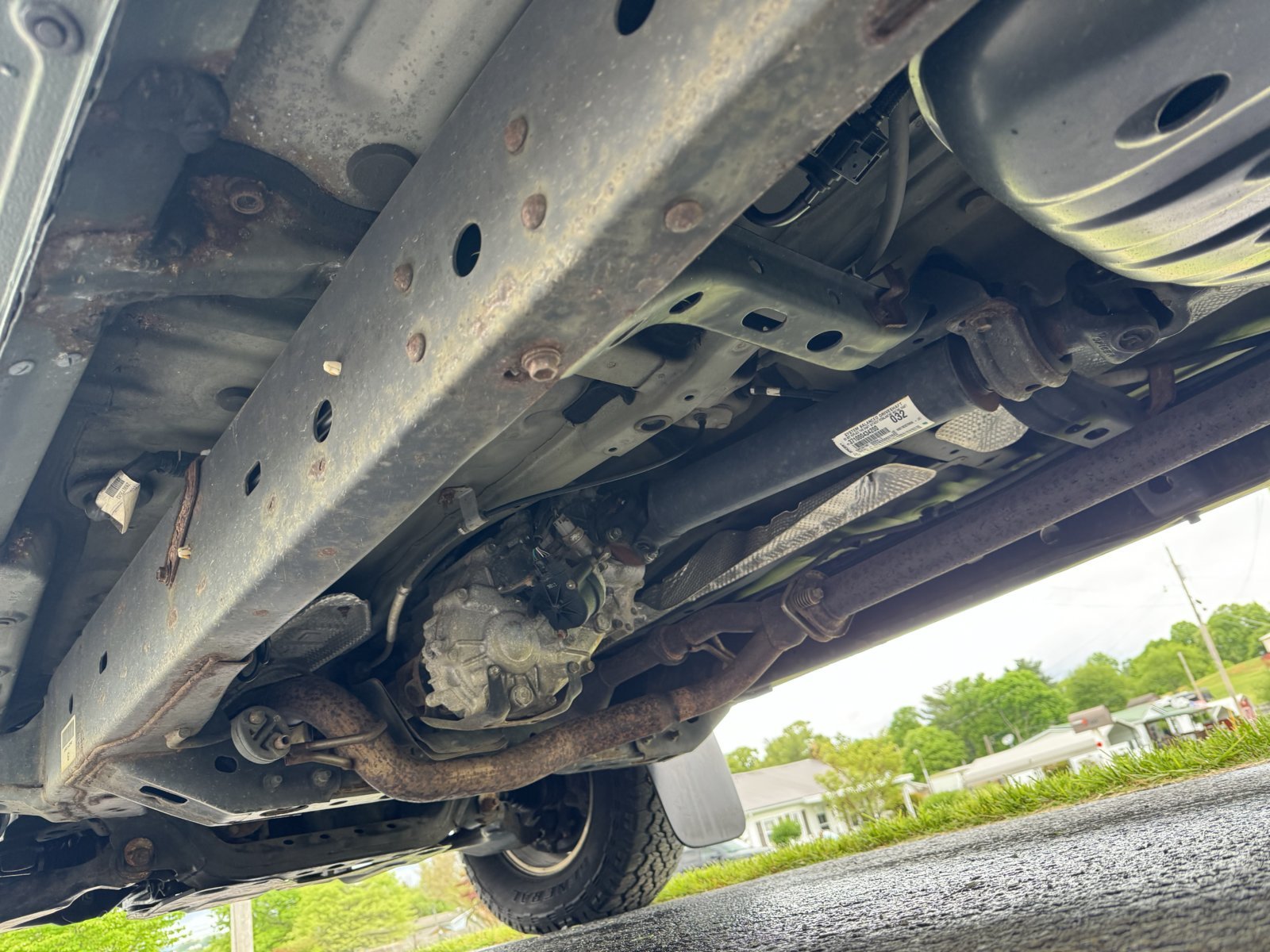

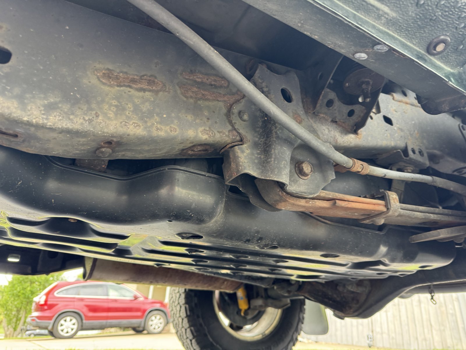

    I’m looking for a 2G to replace my 3G. I’m considering a higher mile option to reduce the upfront cost and also remove guilt from the equation when using it for work and play. I am still feeling out what is too nice, appropriately bad, and too far gone (I spent most of my adult life west of the rockies so this iron oxide stuff…).
    This one for example is very high miles but one owner and well maintained; unfortunately he says it was only driven in the south but it still looks like he got in to some road salt regularly. The rust on the welds doesn’t worry me so much as what looks to be taking hold of the body (check out the left most areas outside of the frame at the rocker) - my assumption is that has started from the inside so what is visible is the ‘nice’ side. I have seen quite a few like this in different areas of the country.
    So, does this seem like it’s still solid and I am worrying about minor stuff that WoolWax will slow down; or would this be buying regret for top dollar?

    What's the price?
    At first glance I thought nbd, but on second look, I would probe the spots just forward of the spring mount. Those might be nothing, or they might be early stage cancer.

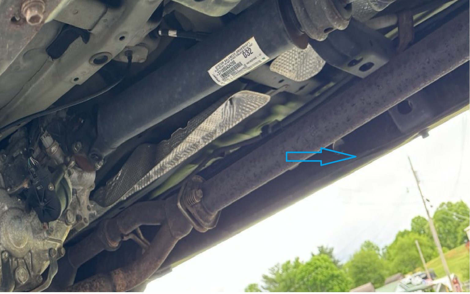

    The phots are insufficient to tell.
    You need pictures from the middle looking out.
    The the rust starts in the layered sections of the frame. Then started growing and eventually pushes the layers apart in big rust chunks.
    Below is 1 of many laminated areas.
    Also look at the inside of the frame next to the converters. Driver's side is usually the worst.
    Next place would be along the frame in the back where it goes up nest to the exhaust pipe.

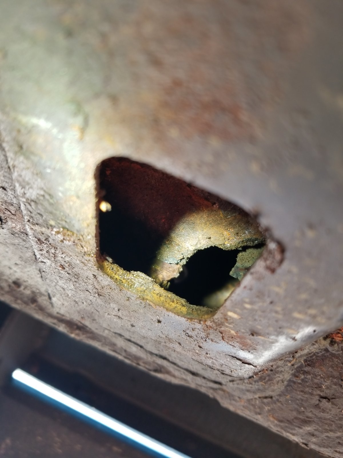

    X2! Now this is rust! Found this little soft spot on my old 2nd gen...
