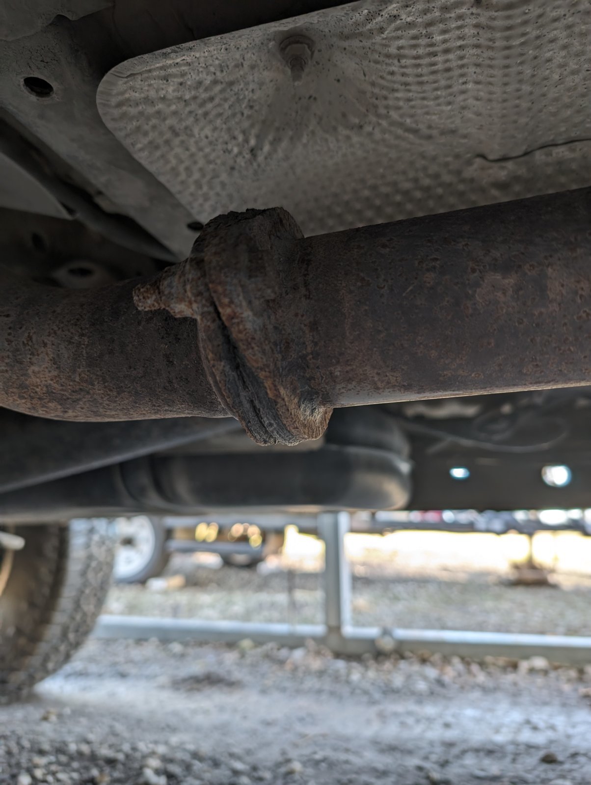

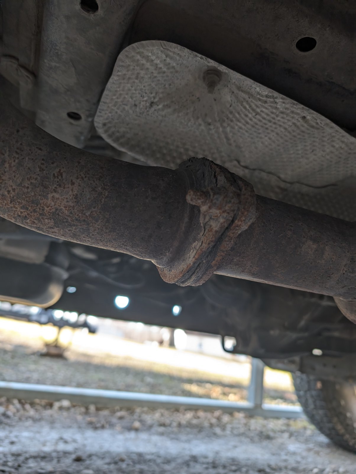

    Jacking this thread so another one doesn't have to be made on the same subject.
    I'm having the same issue with a rusty flange that I have a check engine light comes on and off. Looking at the condition of this does it seem that this will clean up and new gasket & hardware can be installed or is chopping it and using exhaust clamp like discussed here work better? Thanks for the help guys.

    I would see if the exhaust shop has flanges that can replace those. That's assuming your exhaust pipes are still in good shape. Sometimes, rust will keep the form until it's touched and then it crumbles apart. With the original post, his flanges were completely gone, so I didn't suggest getting new flanges put on because it's likely at least part of his pipe would need to be replaced too. Yours doesn't look as bad, but those flanges are done and need to be replaced. I would ask them to inspect the pipe to see if it can still be saved. If not, you could have a new section welded in place, provided you understand that replacing part of the exhaust later will mean cutting the pipe again.

    Is the joint upstream of your O2 sensor? Are you getting a lean code? You'll want to verify the leak here is the actual culprit.
    Looks like there's sufficient flange material to just replace the gasket and hardware. Beware the old gasket may require a lot of manual labor to chisel out.
